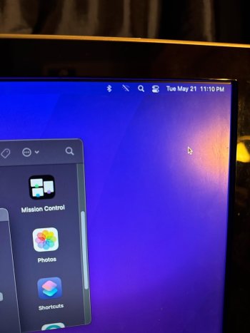

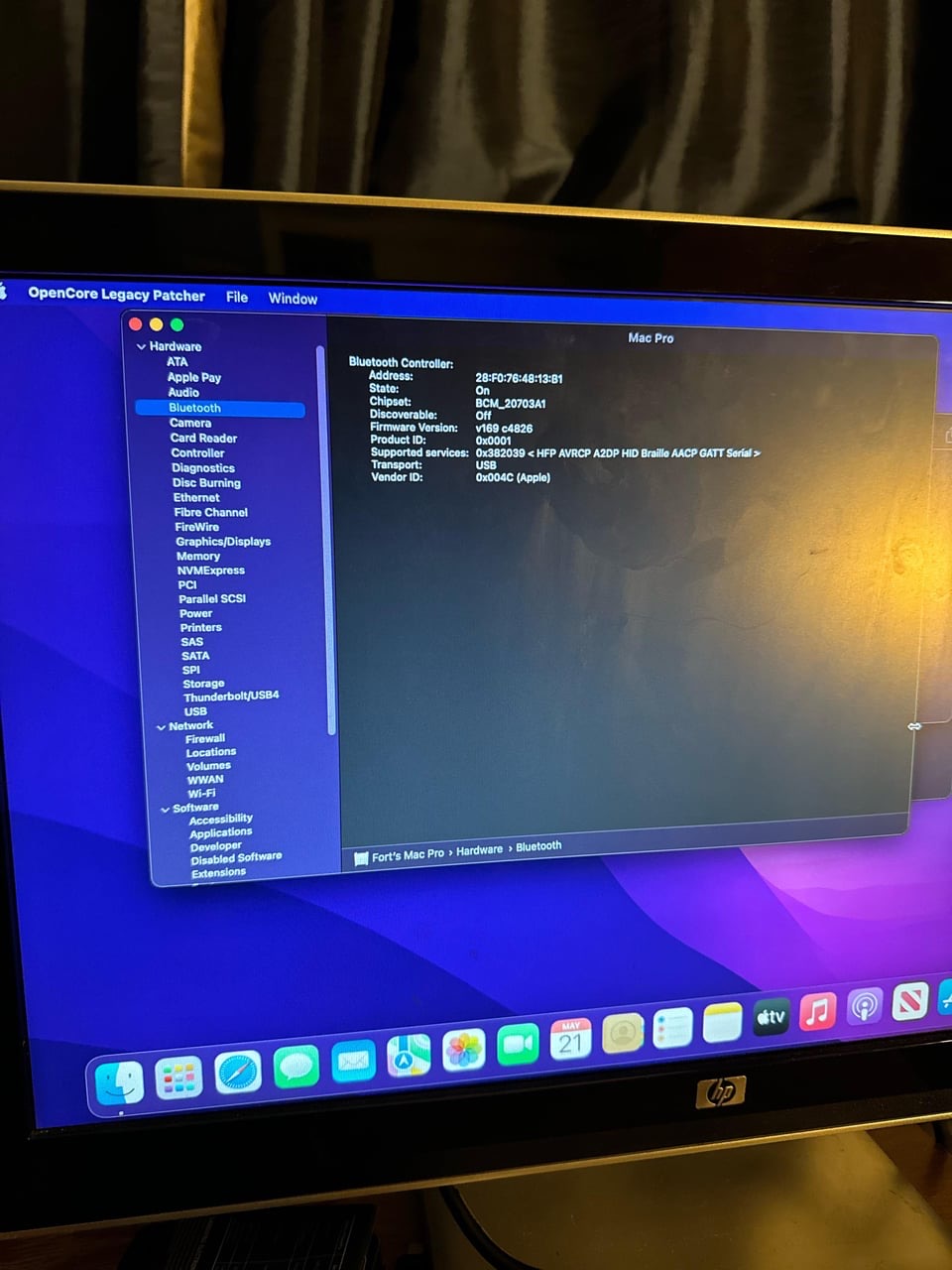

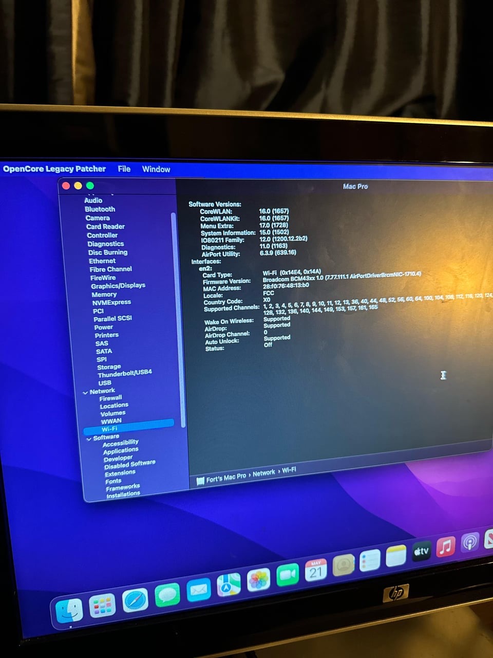

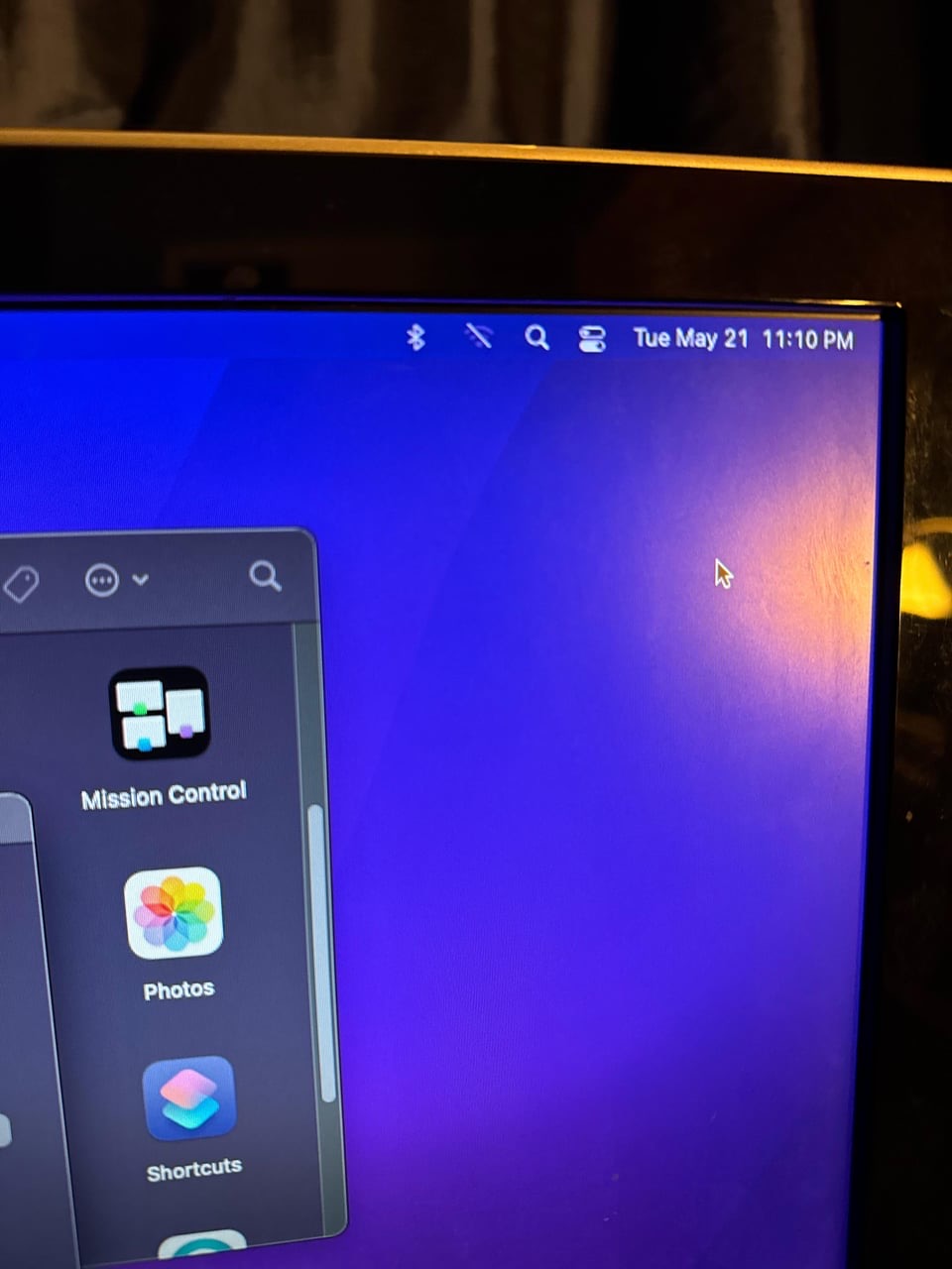

Hey I guys i upgraded my wifi/bluetooth card to BCM943602CDP using a adapter for mac pro 5,1. Bluetooth works fine, but wifi icon has slash through it. Doesn’t work. I did NVRAM reset (5 beeps) and clean install of Monterey using OCLP on samsung SSD. Any ideas?
Side note: tested on another machine so I know card and adapter work

Do a clean install with a spare drive and see if the card works or not.
When you do a install with OCLP, the root patches remove the drivers for all the other cards but the card that you had installed in the Mac Pro while doing the OCLP install, this is specially true with GPU and AirPort cards.
