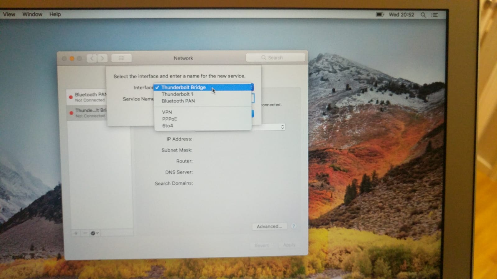

Hi everyone.
So a few days ago this MBA lost WiFi, just like that, out of the blue.
I tried pretty much everything.

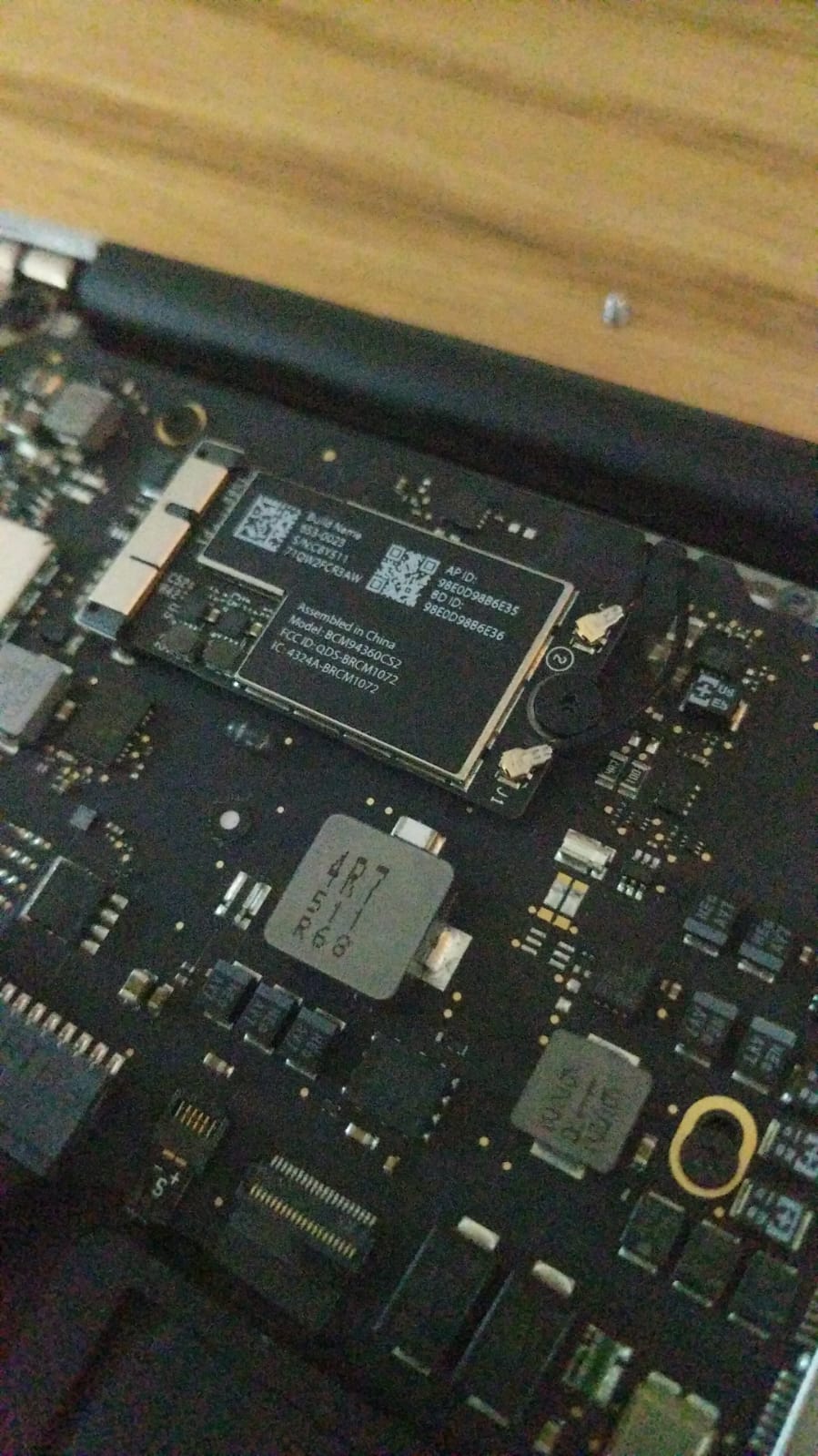

I even found another MBA of the same year, and (since I thought the WiFi card died) replaced the WiFi card.
No go.
I have reset PRAM and SMC. No go.
Today I decided to wipe it completely and install High Sierra from USB, fresh start.
Still no go (see pic).
Anyone can think of a reason WHY this is happening? Motherboard issue?
Thanks so much!!! Any advice would be much appreciated.

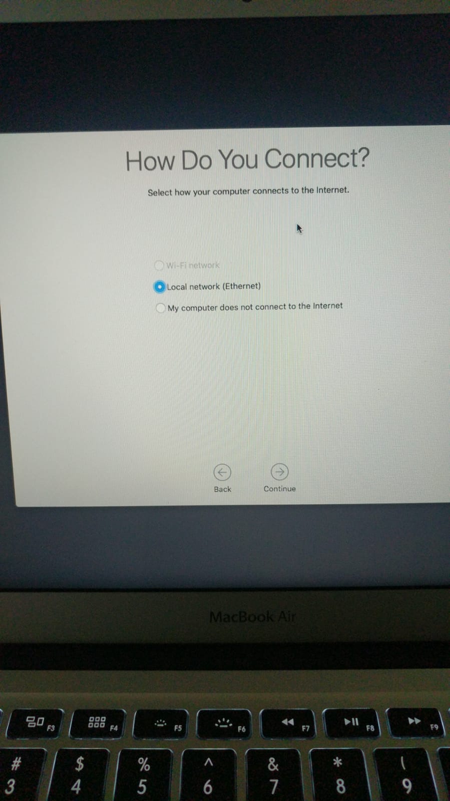

Update:
Seems that BT is working.
Here are some pics.
Notice: no WIFI in settings menu.

You have to check the "System Report" and select wifi to see its log. Google to see what it should look like. If it's just a few lines of information, likely your system doesn't recognize the wifi card.
I know telling you to reinstall doesn't make sense but that's how I got mine fixed.
Thanks! I did reinstall the OS. Still does not work. The WiFi icon won't even show on the top bar.
Update:
I just googled system report - wifi, and I can tell you that it certainly does not look like it should.
So yet, the OS does not recognize the card at all.
Another update: I tried to move the wires connected to the card. To look for damage. It seems like they are fine.
Running out of options. Sad to see this laptop go because of this. But I guess it's a MOBO issue.
