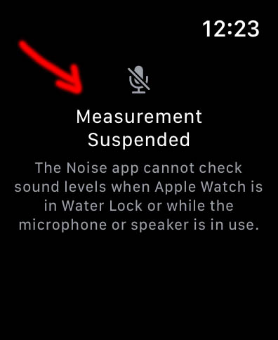

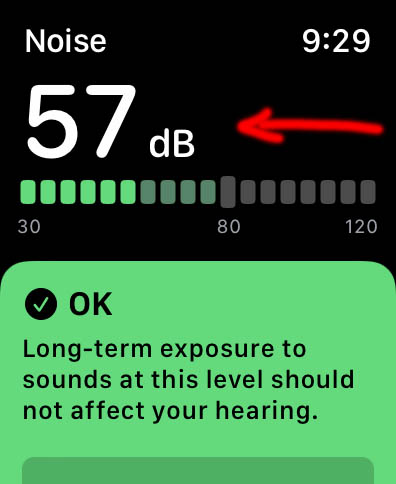

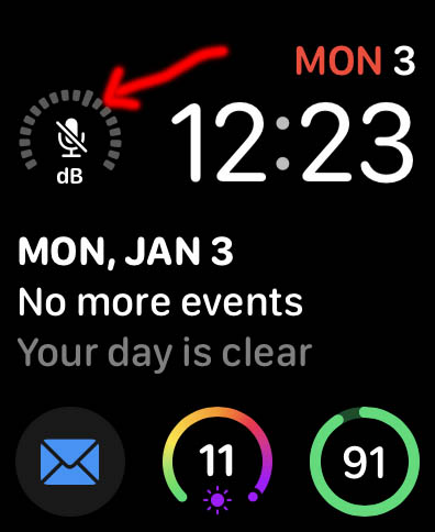

If i put sound measure at my face (inforgaph modular), it stopped working after 30 min and message show that it was suspended. However if i remove it from face, microphone work fine all day long. So is this is hardware bug, or WatchOS 8.3 bug (Noise app)

Your middle picture explains why monitoring was temporarily suspended. You probably did something to trigger the stoppage. I have had the complication before (although I don’t at the moment) and never had that message.
I have not done anything, not swimming, not any other unusual activity. Every time the mic get suspended, if i reboot the watch it works again for 30-40 min, and get suspended. However, like i mention, if i remove Noise app from face, it is never suspended, running in background. Start thinking it is mic problem with the watch.
P.S. installed beta 8.4, and if i put it back to face, it gets suspended very quickly (myabe 10-15 min), but that resume itself for short period of time and get suspended again for good, that require restart.
