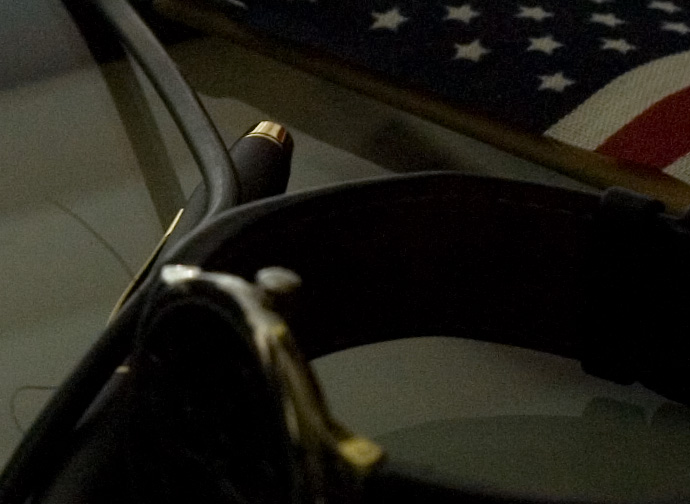

I really don't think the problem is ISO 400 (unless Sony really blew it). Here are 2 test shots at ISO 800 and they both are sharp without losing detail:
The photos are an overview picture and a 100% crop The watch is blurry because it is outside the DOF.

😕 Your image seems to lack sharpness as well.

The photos that I posted where to show that noise doesn't decrease sharpness dramatically (plus they are from a D2H which some regard as a very noisy camera).

Firstly, there is no noise problem in that photo. Like others have said, it's due to your 1/2 second shooting handheld. If it wasn't for the in-body image stabalization, I think you'd end up with a lot of blurry photos. It doesn't matter how still you think your hands are. You're not going to end up with sharp images handheld.
Get a tripod. It's great to take photos at f/8, but at night this isn't possible if you're handholding and were working at f3.5. At f8, you'd be handholding for longer than 1 second.
Oh, turning up the ISO would let you cut your shutter speed. You'd get noisier images, but I never understood the people who stressed out so much about it anyway.
