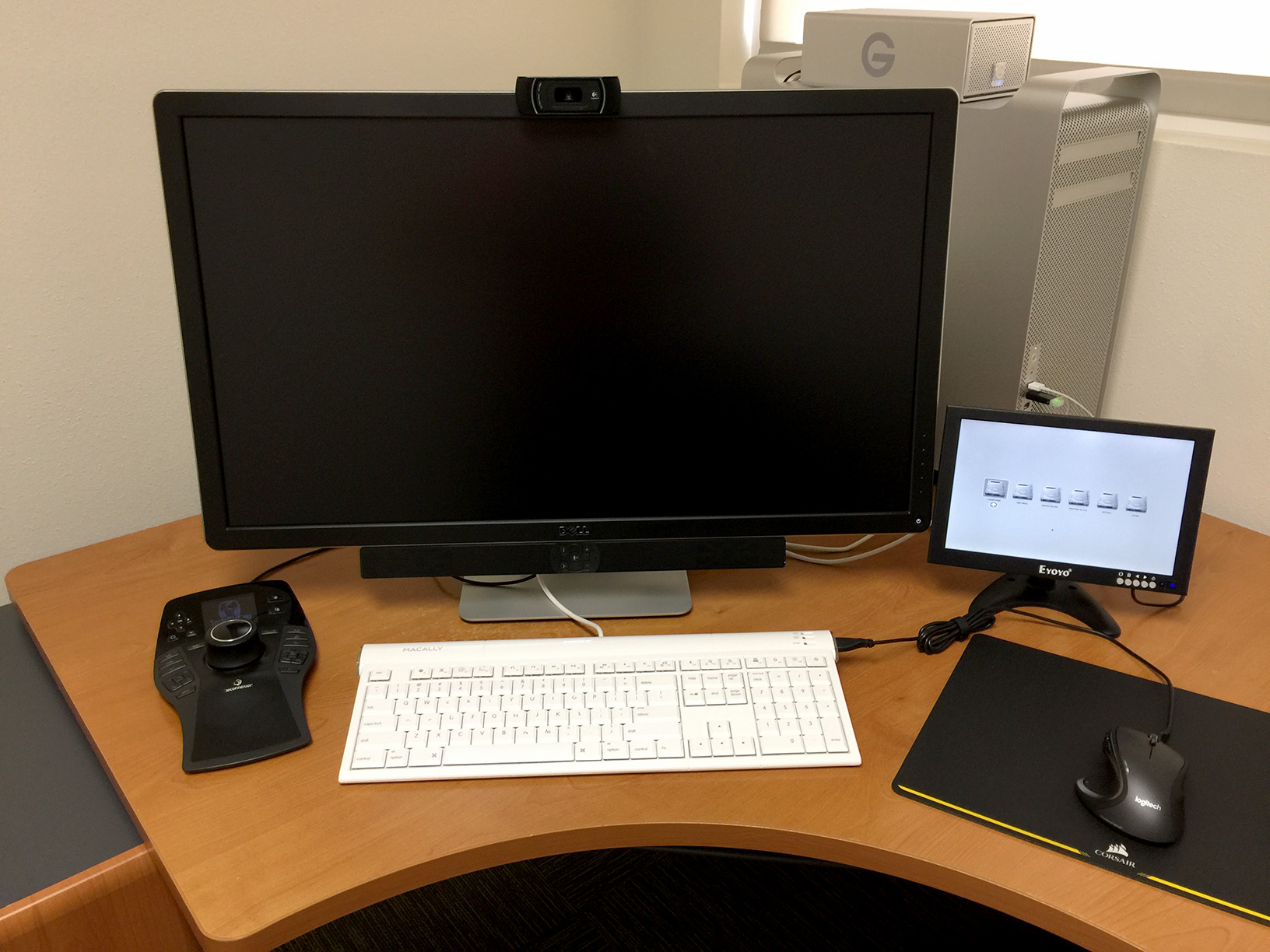

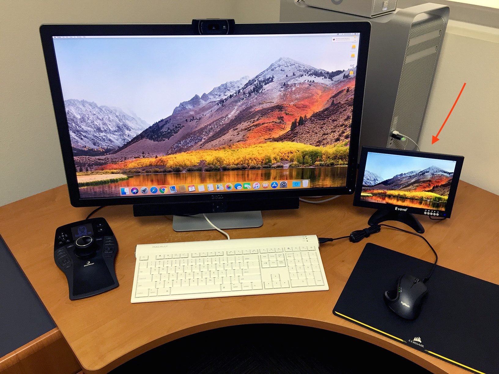

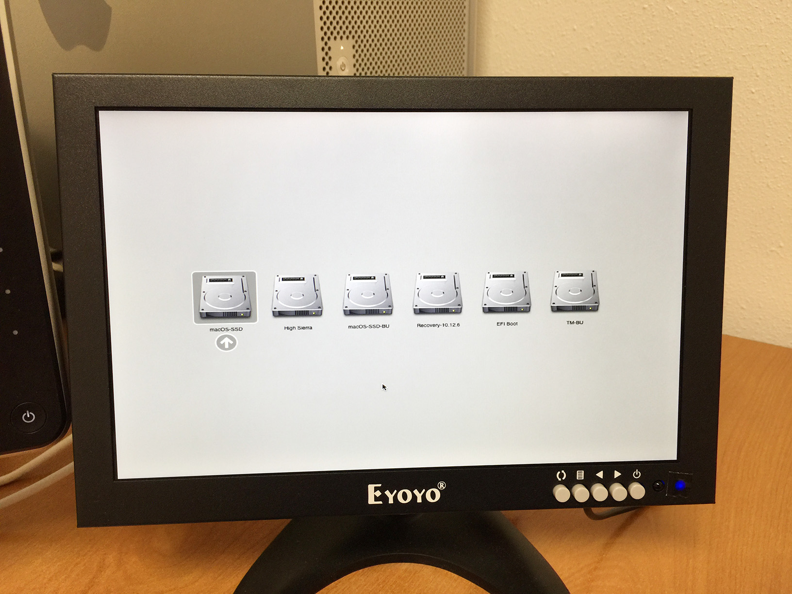

I've been running non-EFI GPU's for a while now with a GT-120 also installed for boot screens. All was well until I decided to upgrade my Apple LCD Cinema display (2560 x 1440) to either a 5k or 4k display. First I tried a 5k Dell but had too many issues with it so I replaced it with a 4k Dell. It was during this process that I found many 4k or 5k displays can NOT display boot screens in either macOS or Windows. Even running an Apple EFI card will not produce a boot screen on my 4k display. So...... What to do... What to do.....
Well this was my solution. A dedicated 10" 1,920x1,200 display for boot screens, recovery mode, etc... It's plugged directly into the GT-120 and is a bulletproof solution. It works every time! 😀
Straightforward, simple idea. So many times we get so caught up with always needing the latest and greatest, we forget about simpler solutions. I will be taking this idea to put my original 5770 to work next to my non-EFI GTX 1060. 😀

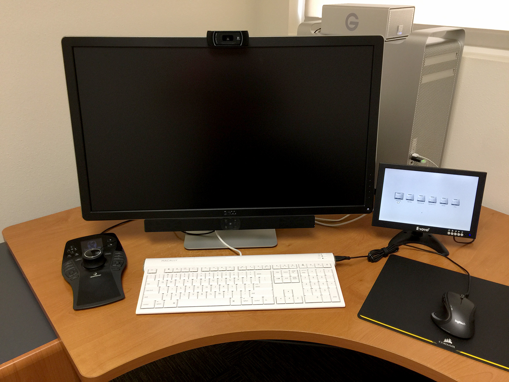

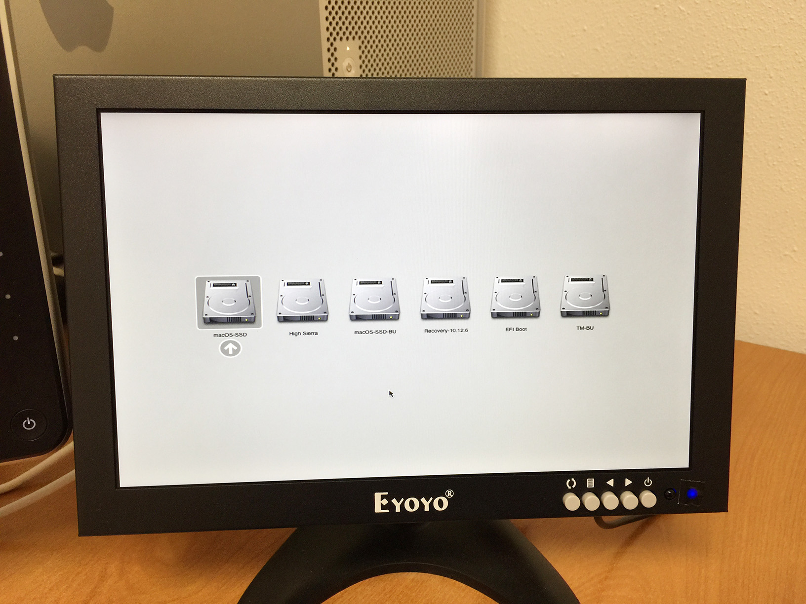

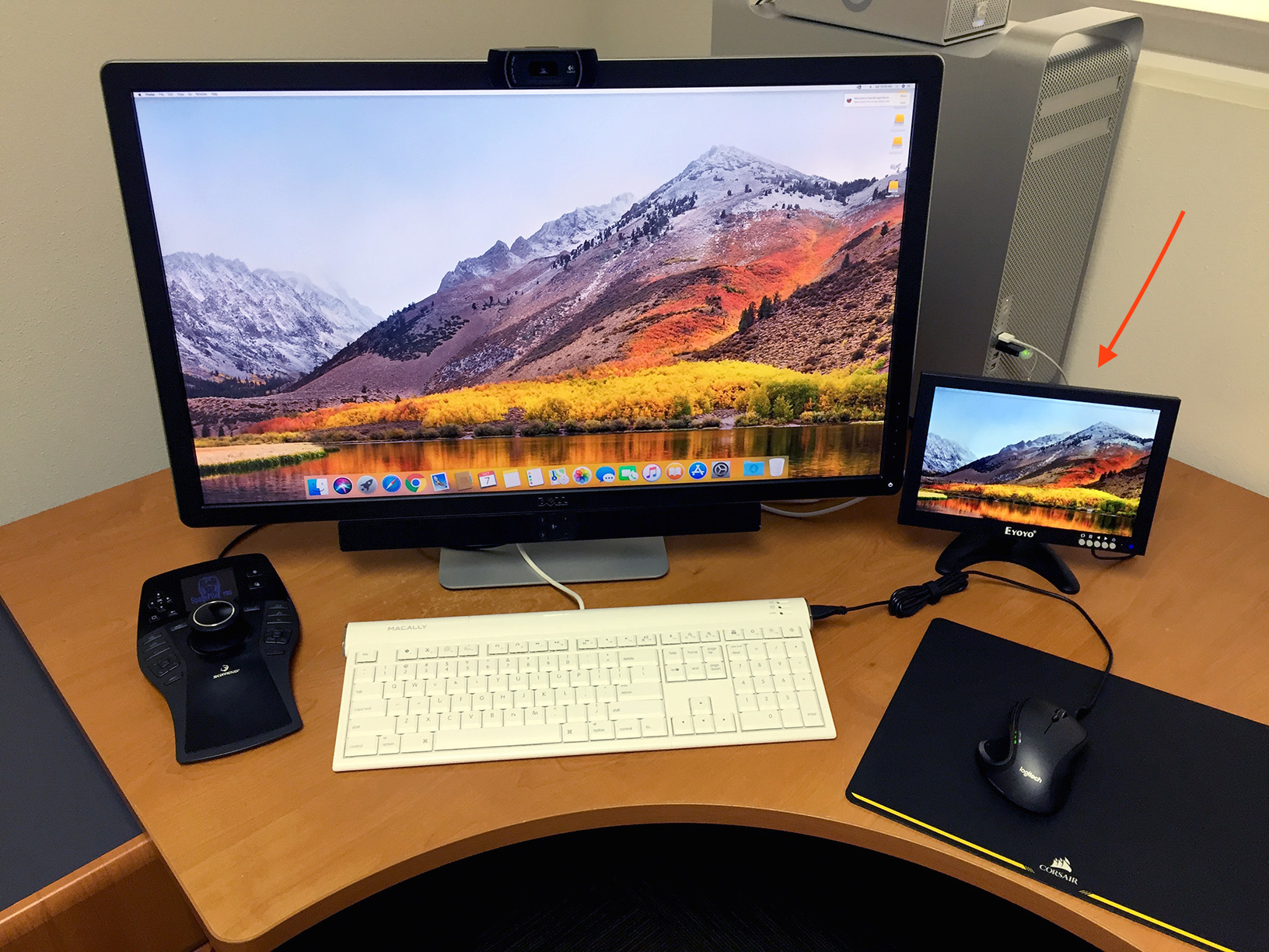

View attachment 724223 View attachment 724224 View attachment 724225
Assuming one has a GT-120 and a second screen... Now, could you also make a BulletProof™ solution for setups with a single, Non-UGA GPU?
I have the same brand in 8” format as a diagnostic screen. Made my nMP look like a giant tower next to it. Best $60 I ever spent.
I agree. The GT120 and the 10" display together cost LESS than the $225.00 MVC charges to flash one card. Even then he only flashes the reference/founders editions not cards like mine.
