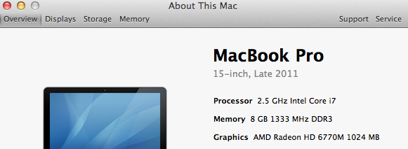

If you're using lion just click the apple menu, about this mac, more info and then this screen tells you what graphics card you're using. I'm using a cinema display currently, so mine registers my dedicated card.

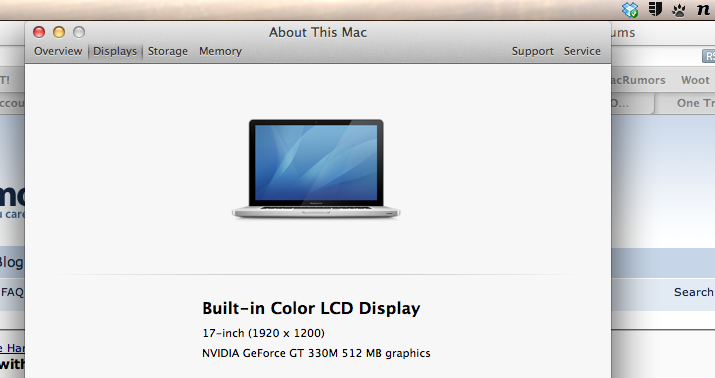

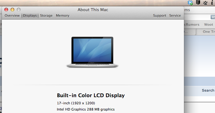

I don't know anything about the Noobproof software. But, are you also asking if gfxcardstatus app is working. It does. I have both iStats and gfxcardstatus and temperature is always shown. You can confirm this by checking your "About This Mac" and go to more info and then Display. It will tell you what graphics card it is using currently. I have mine auto switch, integrated on battery, discrete plugged in.
Edit: Looks like someone answered you before I could post.
But here are the images anyway. These ones have the gfxcardstatus in the status bar. Look at the top right.
When Integrated:
When on Discrete. N is for Nvidia chip:

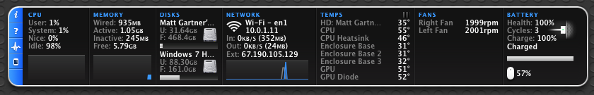

Yes, I meant the latter. In my experience, whether I am using integrated or dedicated graphics my card registers on iStat Pro. I just ran off integrated to double check and this is what I see: (iStat Pro attachment)
