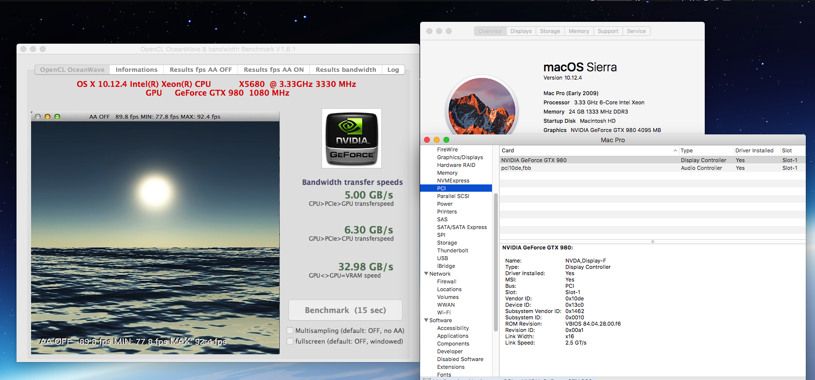

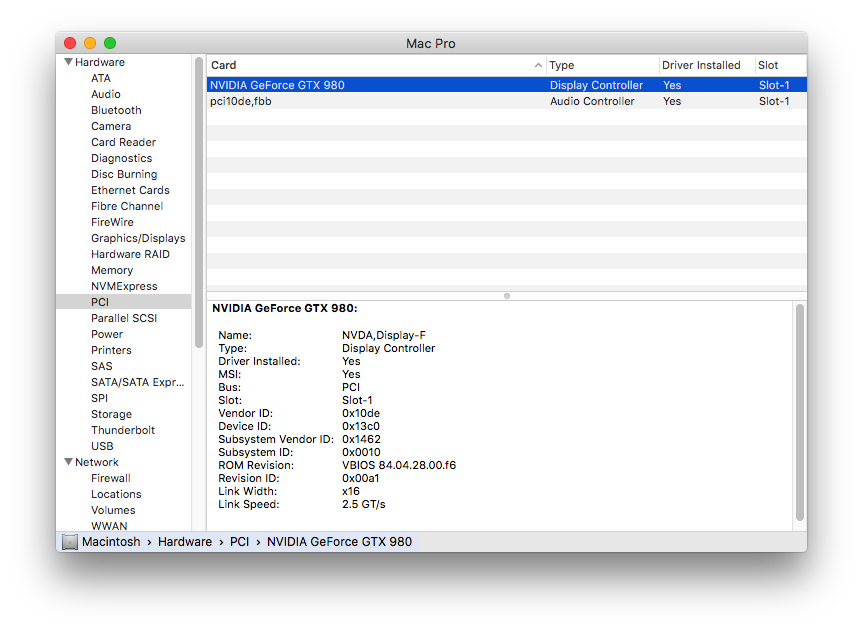

Just figured id make a quick post documenting this interesting find
I noticed while i was testing a GPU I was recently given in my Mac Pro that when I went to PCI devices it did not error out but it actually listed the GPU (and other PCI devices) properly! when i tried another GPU (a Geforce 210) it gave me the normal error... interestingly OS X says a link speed of 2.5GTs tho i did not check beyond this to see if it was running at 5GTs or not
just found it quite interesting so i figured id document it 🙂 (this is with OS Xs stock drivers interestingly it looks like the Tesla architecture GPU drivers are based on the 310 branch in sierra)

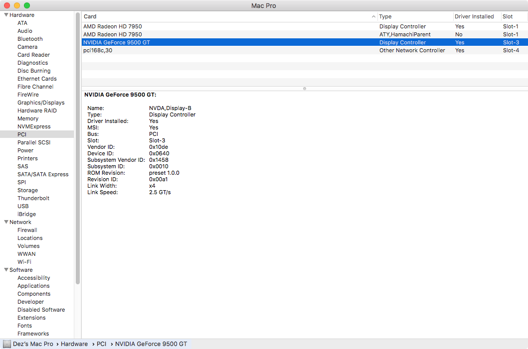

Do you have HDMIAudio.kext installed? It seems that it can be responsible for that but I'm not 100% sure.

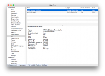

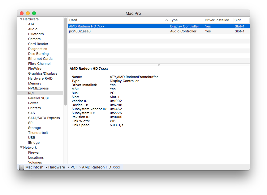

PCI Info.png Screen Shot 2017-05-10 at 12.19.50 AM.png Screen Shot 2017-05-12 at 6.19.14 PM.png
All screenshots are from the PC cards - R9 280X capture is with BIOS switch in UEFI position, hence the HD7xxx name.
