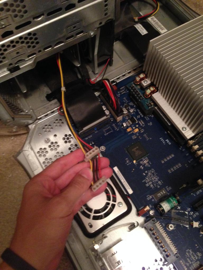

Took some pictures. Shows the drive not showing up during the installation process. Shows the drive not showing up in disk utility. Shows the HD (2 HD's, one on top of the other)

Power cables and ribbon cable connectors. Also check that the ribbon cable is properly connected to the motherboard.
Looks like the ribbon cables are properly connected however there is a red,black, & yellow cable running from the HD that is not plugged in. I looked but couldnt find where the connector would fit. Anybody know where it plugs in?
That's the power cable with multiple connections...for plugging in multiple drives off of one power port. I'm assuming there's one of those plugged into the back of the HD in question and that leads to the other end of the cord which should be connected to the motherboard.
Yes, the other end is plugged into the HD. So the end that is not plugged into the HD should be plugged into the motherboard? Any idea where it goes on the motherboard because I looked for someplace to plug it in last night and couldn't find anywhere?
Ok. Where is the power supply?
You should refer to an illustrated tear down for your exact machine, where it shows all the components and sub-assemblies. There were several models with the G4, and there may be important differences.
