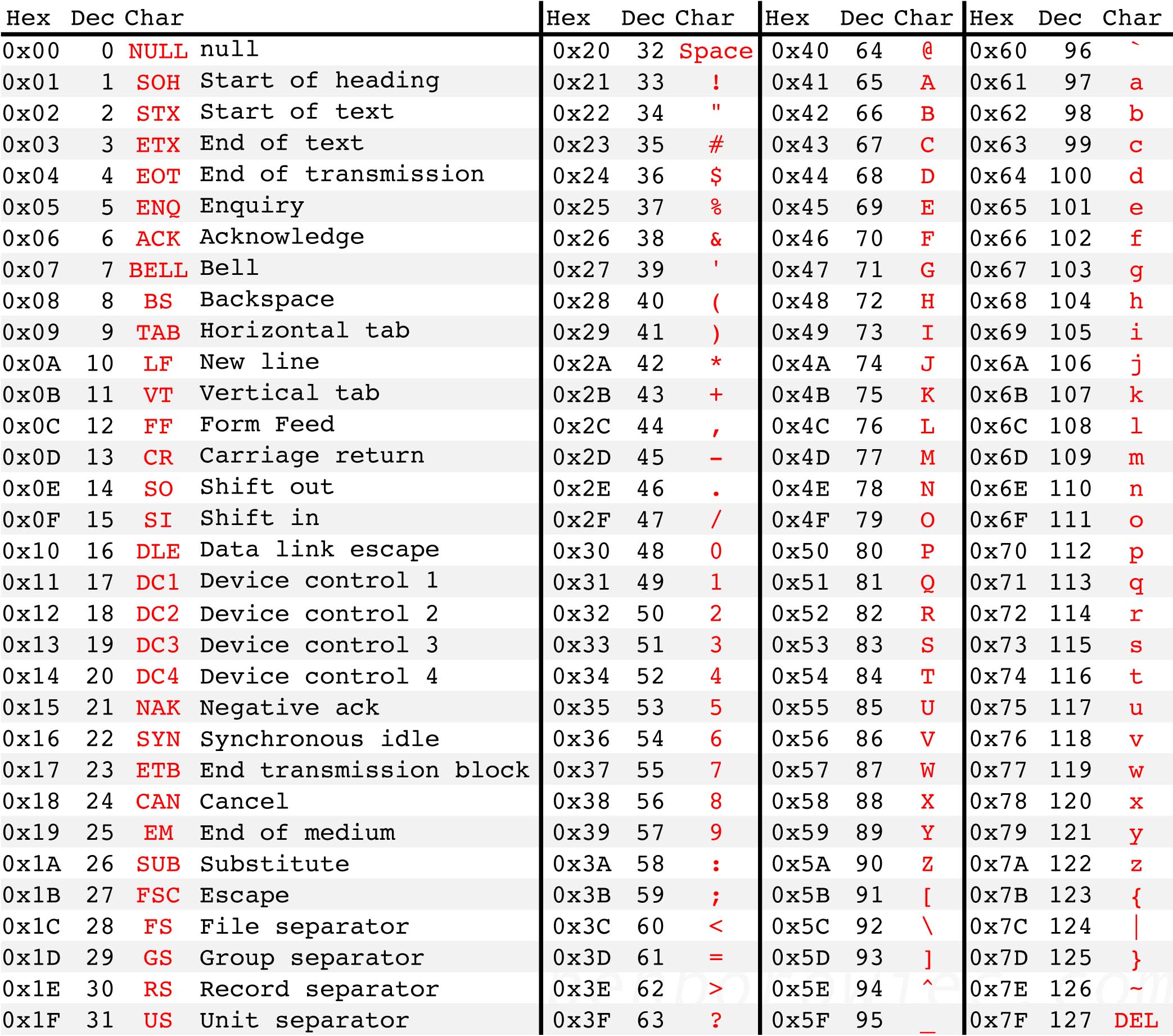

If you look at an ASCII chart you'll see each value (in hex) of the num array
So you see the string that contains '10' ends up really holding
'1', '0', '\n', NULL, 'i', 'i', 'i', 'i'
The i's are left there so you can see they aren't overwritten (I set char num[] to 'iiiiiiii' at the beginning of the code. But C sees the NULL it doesn't care and quits processing the array as a string.

The system call isn't putting in any zeros. If you look more carefully at the data (hint: %x), it won't be zeros. This isn't directly related to the reason for failure, it's just a mistaken detail.
If you understand why 11 works, then you should be able to work out why 10 doesn't work. If not, go smaller. For example, try 9. What happens? Try 8. Explain what happens as you decrease the size of num.
Here's a command-line whose output shows the data:
Code:
ls /Users/douglasbrenner/Documents/Gaurav/a_scan_data/ | wc -l | hexdump -C
Look at the data. Count it.
Look at your original code. How are you reading the data? Exactly what values are being passed in?
Finally, the printf I asked you to add should run exactly once. If it's in a loop, it's in the wrong place. That is, you should ADD the one printf given, outside the loop.
If you're going to change the printf in the loop, make it tell you more, clearly:
Code:
while (fgets(num, sizeof(num)-1, fp) != NULL)
     printf( "fgets got (%s), len %d\n", num, (int) strlen(num) );
I want to point out to the O.P. that if all you want is the number of files in a directory, then you should be using the readdir() API to do that. It is the POSIX API that should be used to examine directories from C. In general, if you think you need to use system() to get some information about something on your computer, then that means there is some underlying API to get it. You should be using that API directly and not going through all this nonsense. It will be faster and less error-prone.
Reactions: Madd the Sane
You may already have known this, but it hasn't lead to an understanding of what happens.
I asked you to explain the output. That is, why does 30 work?
You're looking at the evidence (program output), but not seeing what it says.
Code:
Code:
I meant spaces. I did a hex dump earlier
