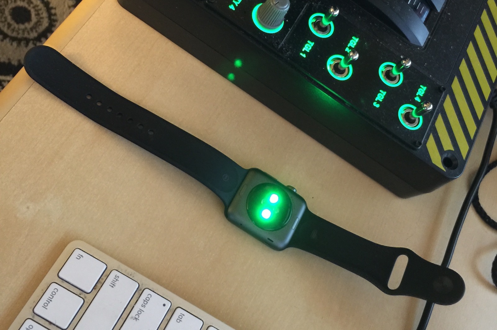

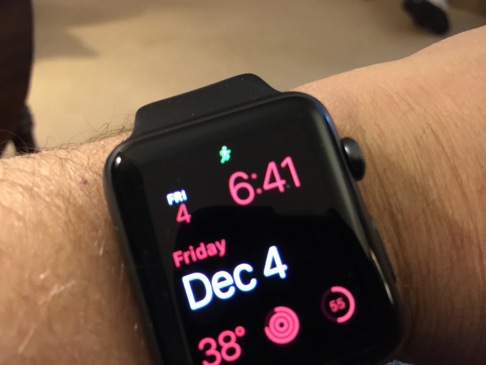

I managed to capture pictures - last night it happened when I was at home:
This morning I took the watch off and set it on my desk and it's doing this:
The only way to stop it from doing this is to reboot it. It seems to go into this mode by itself for no particular reason.
The second picture was when the watch was at 93% battery. The first picture it was probably 55%.
nacho is correct, that is the Workout app running (running man and NOT lightning bolt). You have it running in the background. You need to open the Workout app and End the activity.
that's clearly the running man, not a lightning bolt. see the link i posted.
go into workout and end whatever workout you have left running.
