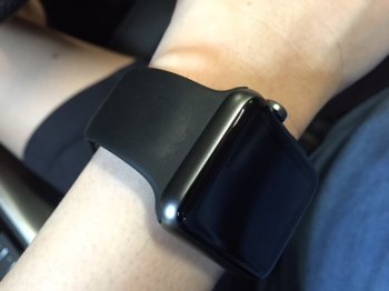

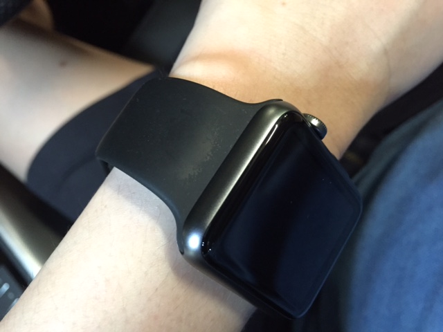

Sorry for being long winded but otherwise its a great device. Except that the black sports band quality after 3 days showed patches near the top ( not underside) and its after careful use and not even sweating on it. Will try to post a pic. Any ideas how to rub it off? lol
