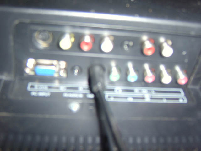

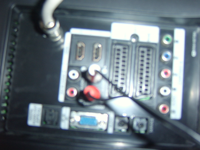

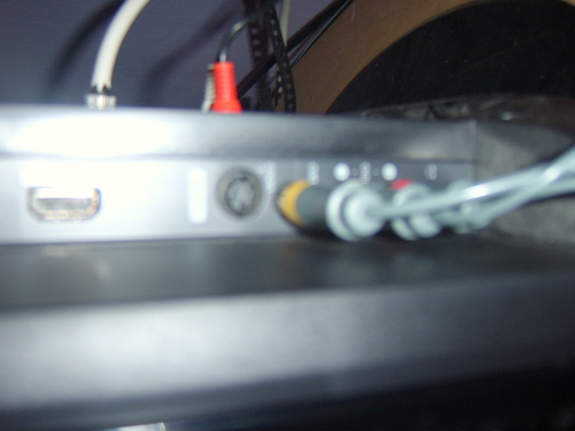

Hi I have 2 tvs so ive uploaded pics of both 🙂
the first pic is from a goodmans 32inch hd ready tv - dnt know the exact model.
the second 2 pics are from my samsung le32a457 hd ready tv.
hope this helps, so im putting the jack into the microphone socket on my mac? and then putting the red and black other two into which audio bits??
also do i have to change any settings on my mac for audio out or tv?
thanks everyone 🙂 !!!!
No, you are going to plug the jack into the headphone output. When looking at the mini, from behind, it's the furthest hole to the right. The microphone is an audio INPUT and the headphone is an audio OUTPUT. See the picture below, for reference.
Might need to change the sound input on the TV to Analog, if that's even an option (check the TV menu under sound or inputs)- Some TVs have 1 HDMI port with RCA jacks next to it (that's what it looks like in your picture as well).
Mac headphone jack to 1/8" - RCA cable (Y cable- headphone plug on one end, red/white plugs on the other end) to the HDMI input that has Analog audio option.
Brute force method: fire up itunes, play all (so that there is constant audio out from the Mac), then try each and every set of red/white plugs on the back of the TV. If NONE play any sound, then it's definitely a TV setting that needs to be changed.
Now, if your TV does not have a combo analog sound/HDMI connection, then I recommend This MDP to HDMI converter w/ USB sound. That is what I use for my HTPC setup, and I'm really liking it. Also, once everything is up and running, Check out PLEX 🙂
