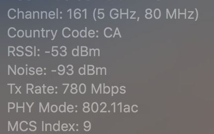

My internet at home is 500mbps and I'm only getting about 120mbps over the wifi.
When I press and click on the wifi logo at the top, I get what is attached but when I run a speediest I don't get anywhere close to 500mbps.
When hardwired to a computer, I do get the speeds they promise.

You should get more than 120Mbps if you are getting a connection at 700Mbps. WiFi is a bit different and there is a lot of overhead, also it is a shared medium. What that is going to mean is if other devices are operating at the same time you will see the throughput reduced on one device because the AP in general can only transmit data to one client at a time. There are also maximum throughout numbers for various physical rates that are much lower than the physical rate you see. For a connection at 833Mbps the maximum throughput is going to be around 450Mbps for one client or so. I can’t recall exactly. Source for all this is my day job is a network engineer. I don’t deal with the wireless as much which is why my numbers aren’t exact for you, but not knowing what exactly is going on in your environment while you are running your speed tests there can be a lot of variables. You could even just have interference from other networks in the area impacting your performance. You can try changing the channel on the airport and see if it helps, or even to get a better AP. Some of the newer ones will have MU-MIMO which means that the AP can transmit to multiple devices at once, a lot of caveats need to be met here first, which speeds up performance if your clients will support it. What you seem to have on your hands is a WiFi tuning problem and unfortunately it’s really hard to diagnose and fix via a forum.

With a 700Mb/s signal I can pull data off my local NAS at around 280Mb/s. So you’re certainly coming lower than perhaps you should, though you will never see 500Mb/s.
Assuming you can physically get closer to the router, you should try that. Your signal strength is pretty good but it’s not fantastic. All the same, I would move closer and repeat the test. If you’re still getting relatively poor throughput it might be that there is not enough free spectrum, but that doesn’t seem hugely likely. If you option click the wifi icon you can create a diagnostic report. That will create a file (wifi.txt I think) which details all your local wifi networks and their signal strengthen. You can then see if there is another channel that is less crowded.
