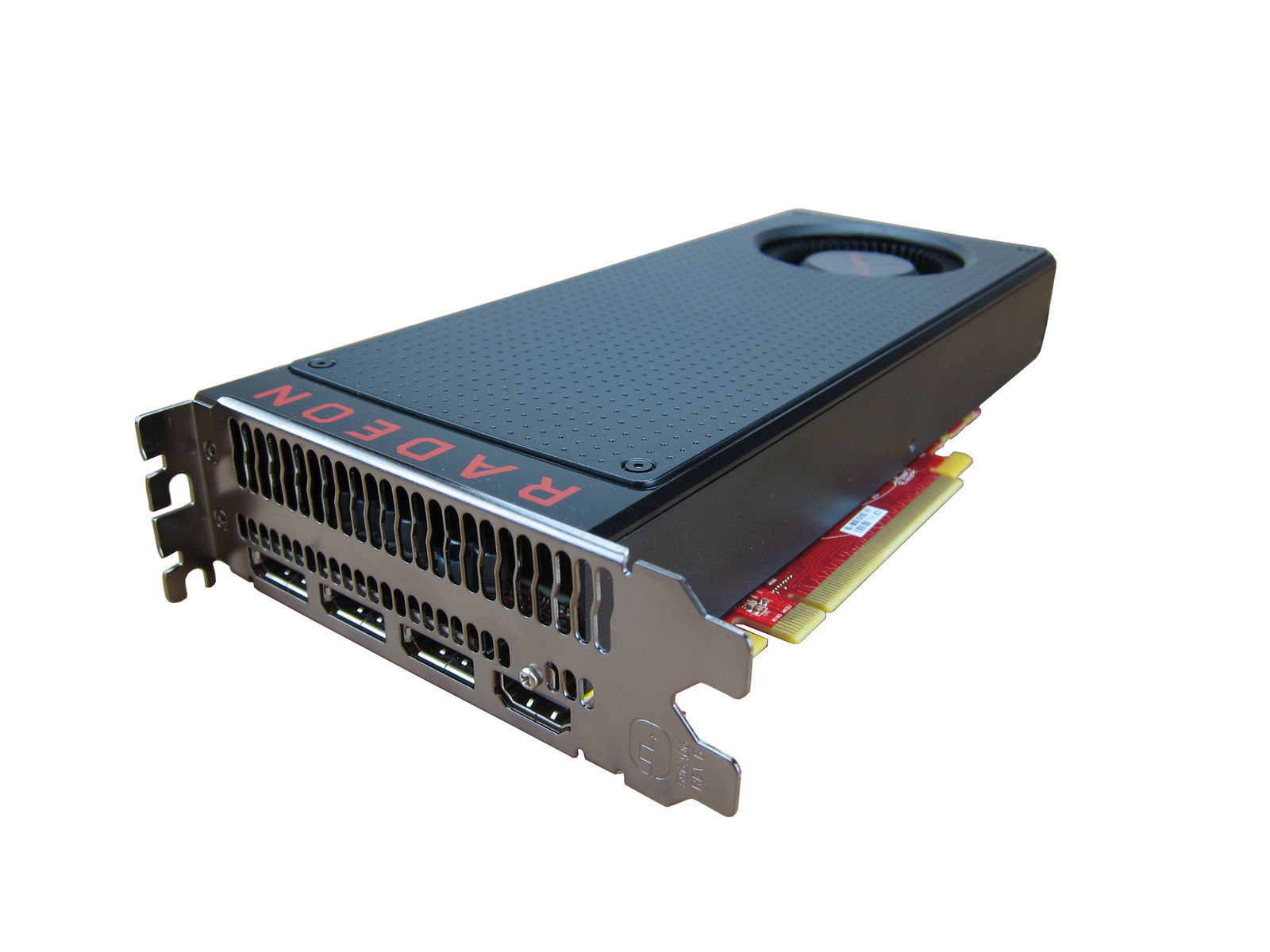

Ok So I have a "DELL RX580 8GB Reference" card and solar in Mojave it is performing well in my 12 core MacPro 5,1. "is not a 4,1>5,1"

This is the exact card here
https://www.ebay.co.uk/itm/123018942147
https://www.ebay.com/itm/183100900082

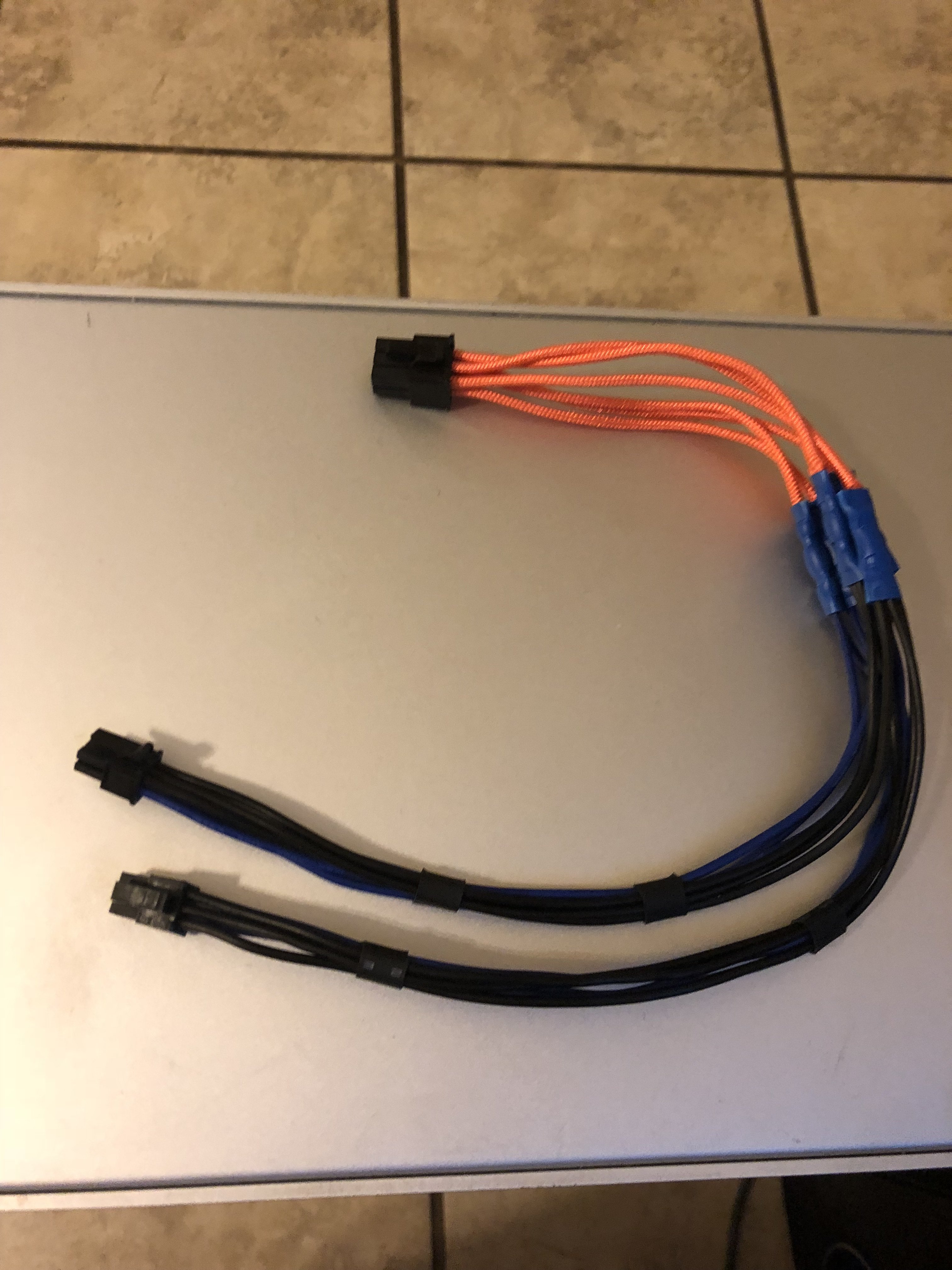

You missed an important factor regarding the TDP and the wiring. First off all the Macs PSU is such sturdy build that it can easily surpass the connectors advertised power. This is especially the case for GPUs, as they almost never draw all the power they theoretically could. Besides that the Mac Pro could easily power two of those, while being within it's specs, because you missed the fact that au to 75Watts are drawn from the PCIe port itself, and not the 6-pin connector. That's why 6-pins are 75Watt rated while 8Pins are build for 150Watt power consumption. So your custom cable is totally irrelevant. In fact with this setup the power-draw on each of the Macs mini-PCI ports is somewhere between 17,5W [(110W TDP - 75W PCIe):2 mini-6-pin] and 27,5W [(110W : 2 {half, each source}):2 mini-6-pin].
You should be able to check using HWMonitor, which can be found here (you don't need the included drivers).
