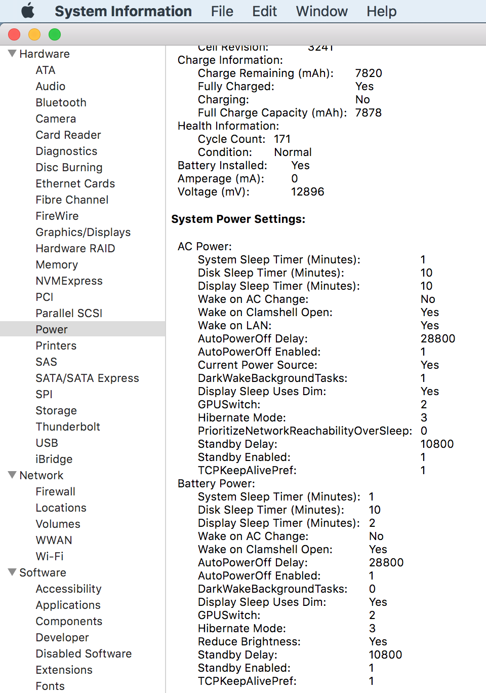

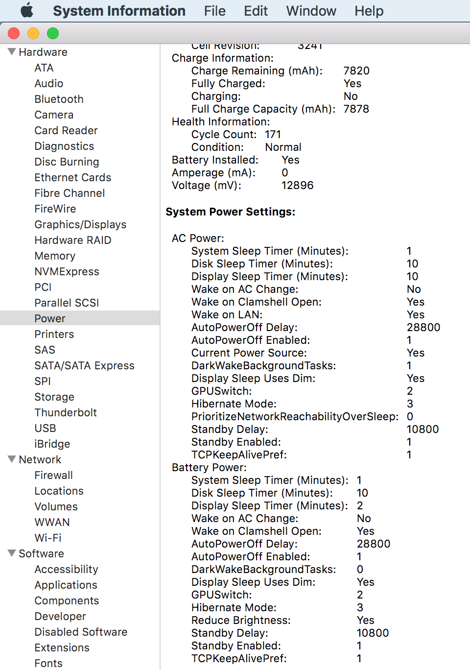

I have tried everything that I could: Resetting PRAM, SMC, reconnecting the battery, reinstalling the OS. I have tried all major versions: 10.10.5, 10.11.6, 10.12.4. All having the same issues. I have even tried installing the OS on an external SSD. Even from there it doesn't wake from sleep. The only thing I've noticed while working from external SSD for about three days is that my internal SSD 2-3 time disconnected by itself and OS was no longer recognising it until I've restarted my Mac. So I unchecked "Put hard disks to sleep when possible" setting and this problem has gone. But I was still unable to wake the Mac from sleep when I opened the lid. Apple Diagnostics does not report any problems.
Based on the behaviour from working on an external SSD, I think at some point, my internal SSD fails, if it's completely idle. My Mac is out of warranty. I want to troubleshoot the problem myself as I doubt that Genius Bar will suggest me anything better then reinstalling the OS.
Just started happening to me a few weeks ago with High Sierra. Laptop occasionally doesn't wake from sleep but only after a few hours spent in sleep mode (prolly related to deep sleep). Called Apple, they suggested to reset PRAM and SMC. Did it multiple times. Laptop woke from sleep one day and then the next day it didn't. When it happens, the body is warm like @exi pointed out above like if it was doing something in the background all night. In my case, the screen stays off when I try wake it up, no reaction to pressing keys, clicking mouse neither to pressing the power button. Holding the power button shuts it down forcefully. It's the only option.
Seems that we have same symptoms. My laptop is also MBP 2015. I doubt this is a coincidence. I'm desperate. I did a fresh installation when High Sierra was released. I'll try it once again and then will claim my warranty before it expires in March '18. The battery also seems to be loose because I can hear a clicky noise when I lift it in the air and shake very lightly.
@randomgeeza I don't have FileVault active.
EDIT1: Have you guys figured it out yet?
EDIT2: Attached is a screenshot of my power preferences
