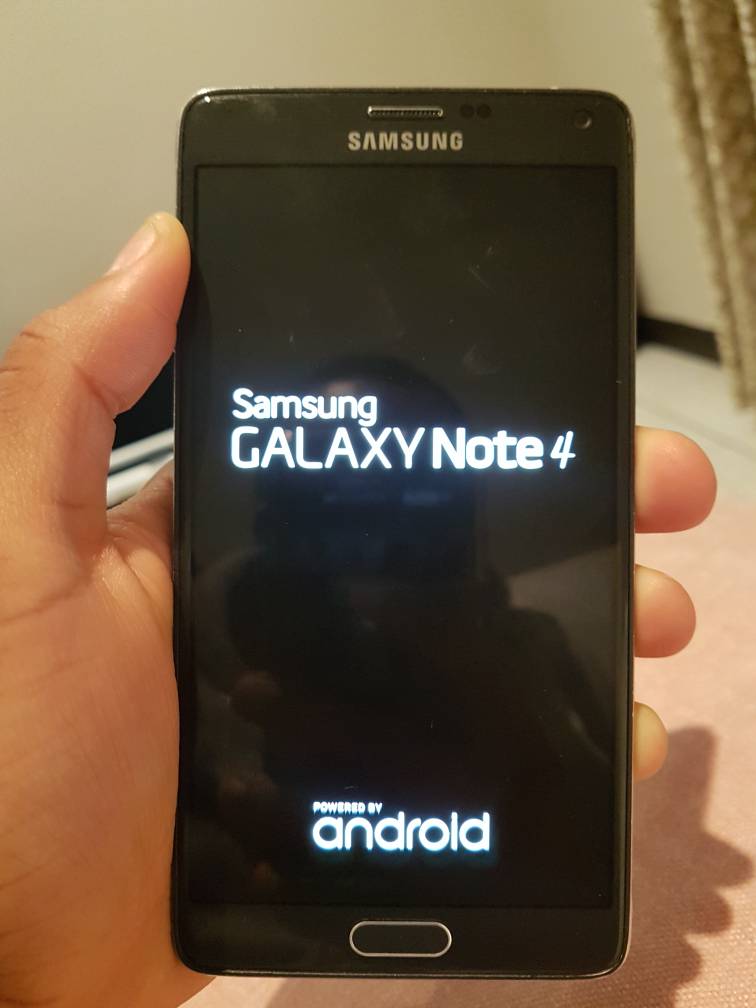

It seems all Note 4s are destined to die of a eMMC failure. I got mine a few days before it's International launch as one of the lucky customers in my country, it's been used hard since, got a S7 Edge last year and borrowed the Note 4 to a friend late last year when he lost his business phone months before upgrade, he used it for running his business, and then he gave it back when he got his new phone, I then borrowed it to my mother after she dropped her S7 Edge and cracked it's Display, now she got her S7 Edge back I decided to reset the Note 4 to setup as my 2nd phone, but when my Mom had it she said it kept rebooting and going to a screen with the green Android bot, and now as I reset it did the same and complains of not being able to read the eMMC, seems the ol' girl is about to kick the bucket due to the eMMC issue. What a shame, it's a great phone.
Here's the screen it shows every now and then but eventually boots up after a Battery pull

Seems my Note 4 is now officially dead, now when I return it on it goes straight to the above screen in my previous posts screenshot.
RIP to my Note 4, lol.

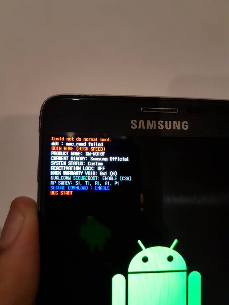

It either goes to the above screen or just sits like this (see below). Yep, eMMC issue right here. She's gone.
:( that's exactly how it started for me, anyways here are some things you can still try (I'm not responsible for further damages):
Start the phone in Download mode (press volume down + home button + start button) and the same tim,e try to reset the phone to Kitkat (get it from sammobile.com) and backup your stuff as soon as possible either with TWRP or with your google account.
