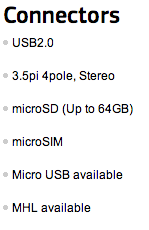

According to Samsung's own website 64gb cards ARE supported: http://www.samsung.com/uk/consumer/mobile-devices/smartphones/android/GT-I9300MBDBTU-spec

You read the sizes of internal memory for international versions of the S3. When they list "Memory: 16, 32, 64" this is what they are referring to, not sd card sizes you can add.

you read the sizes of internal memory for international versions of the s3. When they list "memory: 16, 32, 64" this is what they are referring to, not sd card sizes you can add.
