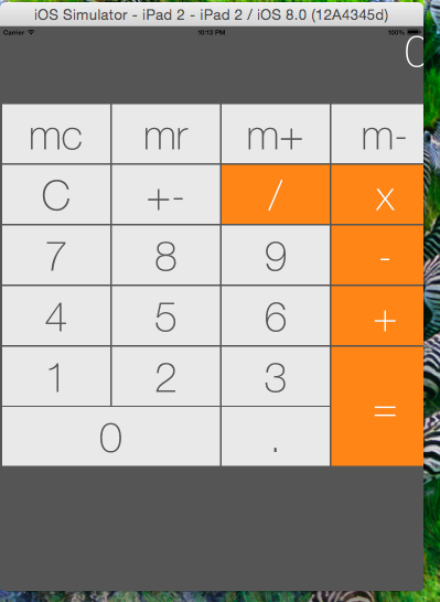

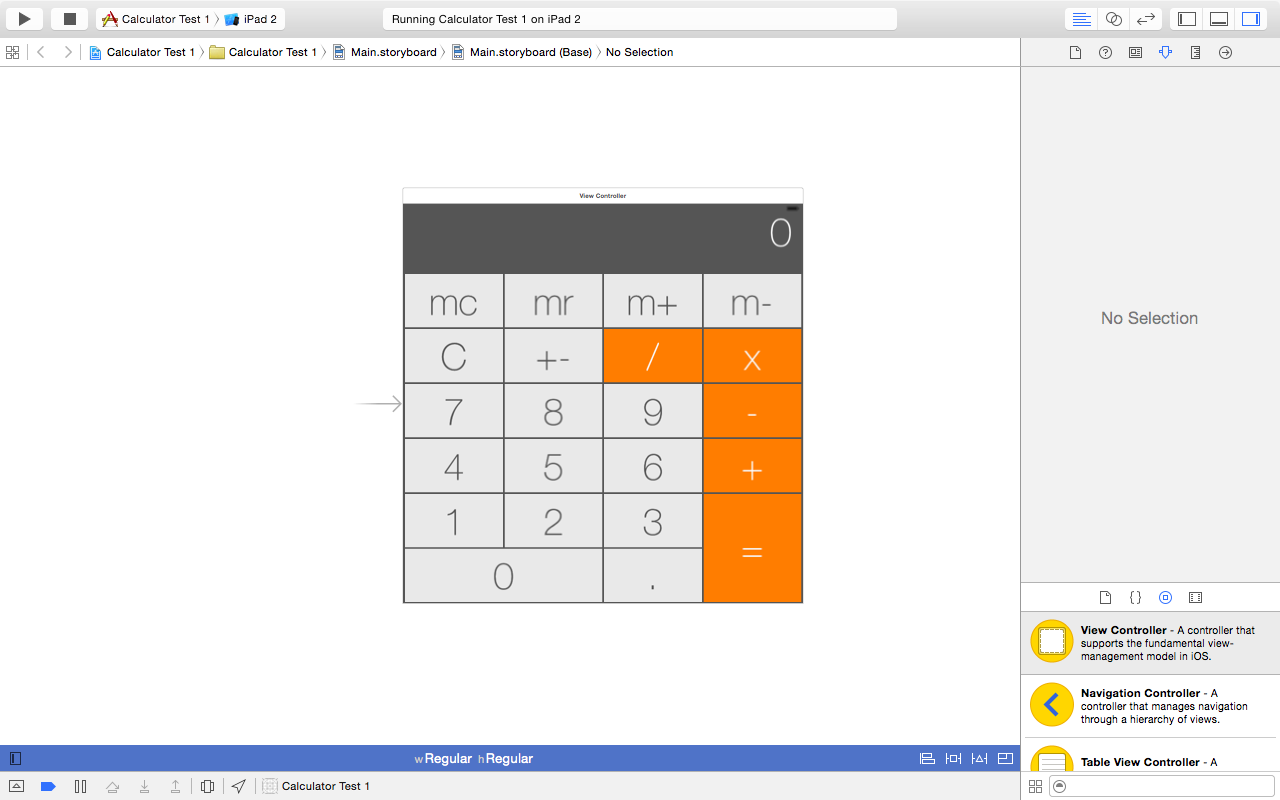

Just learning Xcode. I'm making an iPad calculator. I can't figure out how to make everything fit. When I lay it out in Xcode, it looks really good. I launch the iPad simulator, and it is totally different. How do I fix this?

They look pretty much the same to me. What makes you say they look "totally different"?
You need to change the view on the inspector panel from implied to iPad. Going from memory but I think implied is the default and it gives you a square view. But you you still need to set up auto layout correctly which would also fix your issue.
