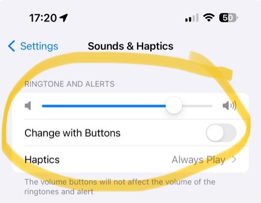

Since upgrading from to my 15PM, email & text notifications have been extremely loud. Nothing I've found seems to help.
Any have ideas on fixing this?
Each time I get an email, text (SMS/iMess/WA/etc) the ping is so loud it makes me jump. (my other app's notifications are mostly off.)
I tried turning the 15PM off>on, but still happening.
There is no separate volume control for notifications AFAICT. This is so annoying that surely it's a bug. 🤷‍♂️
Ok well I fiddled with the "Ringtones & Alerts" volume slider a few times more, then rebooted phone again.
Now back to normal.
Weird.

So I called apple support. They let me try several different things that didn’t work because I refused to do a settings reset. In the end the settings reset actually fixed the issue.

I have this as well on 15 Pro, iOS 17.0.3. Notifications have been randomly extremely loud despite ringtone and alerts volume set to minimum above zero on the slider in settings.
Turning off Sound Recognition in Accessibility fixes it for me. Notifications and lock screen sound volumes work as expected with it off.
Turning on Sound Recognition causes buggy behaviour with volumes on my 15 Pro. Have been testing this with lock sound turned on, and turning on ringtone and alerts change with buttons. With volume on minimum, the lock screen sound is extremely loud. With volume on max, the lock screen sound is very quiet. Basically, the volume of notifications is inverted compared to the actual volume setting of the phone with Sound Recognition turned on.
I guess YMMV, seeing as a settings reset would presumably turn off sound recognition and others have tried that.
