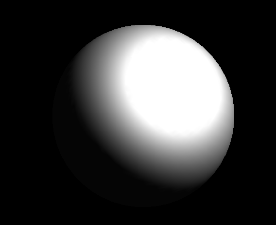

I also have another question: Lets just say that I want to enable lighting in my project. So, I want to place the setup functions outside the drawRect function. Where would I put those? If I put them inside the -awakeFromNib function, the program will crash without telling me why.
Here is some sample code that works so far for me.

Thanks for the advice. I will surely look at it. So, if I understand correctly, you tell me that for now, this will work ok, but when I proceed to advanced graphics options like lighting and shaders, I will have to split my code, right?
Yes, you'll likely run into some problems sooner or later. The more you try to work around them, the trickier they'll get. Much easier to just keep the different matrices in their respective stacks from the off.
I think -awakeFromNib is probably not the appropriate place for setting up a GL context. I'm no expert on the Mac specifics, but I might imagine that the underlying GL context is not fully initialised at this point and calling some functions might cause "unexpected behaviour".
NSOpenGLView offers a -prepareOpenGL method which is probably more appropriate for one-off initialisation (and bear in mind that setting up the viewport and projection isn't really a one-off thing as it depends on window geometry, and is generally better off in -reshape).
Well, I did it that way, and I wrote a test code that compiles OK. However, I am not getting the results I want from it. I am attaching 2 files. The first is the way that the result should like (when ran through Carbon) and the second is how it actually looks like (through NSOpenGLView). Here is my code:

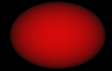

@end
Any idea why this happens? Do I need to set something else before beginning drawing?
The first thing I'd rule out, as previously noted, is the fact that you have a projection matrix stuffed into the modelview transform stack. What space should GL do the lighting in? An orthogonal projection transform mostly amounts to a great big scale and translate at the top of the stack, which is probably not helping the normals.
It should be easy enough to change - just move the glOrtho() call out of the draw routine and onto the end of the reshape() function (after the glLoadIdentity)...
You'll also probably want to set the orthogonal projection up to take into account the aspect ratio of the window.
Thanks a lot, Sin. You've been a wonderful help.
Seems I must take a read into matrices and matrix types on OpenGL again...

However, I am still not getting the results I want. This time, I am trying to enable material shininess with this code:
Code:
#import "MyOpenGLView.h"
GLfloat ambientLight[] = { 0.3, 0.3, 0.3, 1.0 };
GLfloat diffuseLight[] = { 0.7, 0.7, 0.7, 1.0 };
GLfloat lightPosition[] = { 1.0f, 1.0f, -1.0f, 0.0f };
GLfloat  spotDir[] = { 0.0f, 0.0f, -1.0f };
GLfloat no_mat[] = { 0.0, 0.0, 0.0, 1.0 };
GLfloat mat_ambient[] = { 0.7, 0.7, 0.7, 1.0 };
GLfloat mat_ambient_color[] = { 0.8, 0.8, 0.2, 1.0 };
GLfloat mat_diffuse[] = { 0.1, 0.5, 0.8, 1.0 };
GLfloat mat_specular[] = { 1.0, 1.0, 1.0, 1.0 };
GLfloat no_shininess[] = { 0.0 };
GLfloat low_shininess[] = { 5.0 };
GLfloat high_shininess[] = { 100.0 };
GLfloat mat_emission[] = { 0.3, 0.2, 0.2, 0.0 };
GLfloat lmodel_ambient[] = {0.1, 0.1, 0.1, 1.0};
GLfloat white_light[] = {1.0, 1.0, 1.0, 1.0};
GLfloat red[] = { 1.0, 0.0, 0.0, 1.0 };
GLfloat blue[] = {0.0f, 0.0f, 1.0f, 1.0};
@implementation MyOpenGLView
- (id) init
	self = [super init];
	if (self != nil) {
		xRot = 0.0f;
		yRot = 0.0f;
		zRot = 0.0f;
	return self;
- (void)prepareOpenGL
	NSLog(@"preparing OpenGL");
	glClearColor(0.0f, 0.0f, 0.0f, 1.0f );
	glShadeModel(GL_SMOOTH);
	glLightModelfv(GL_LIGHT_MODEL_AMBIENT, red);
	glEnable(GL_LIGHTING);
	glEnable(GL_LIGHT0);
	glEnable(GL_DEPTH_TEST);
-(void)reshape
	NSLog(@"reshaping...");
	NSRect bounds = [self bounds];
	glViewport(0, 0, NSWidth(bounds), NSHeight(bounds));
	glMatrixMode(GL_PROJECTION);
	glLoadIdentity();
	glOrtho(-100, 100, -100, 100, -100, 100);
	glMatrixMode(GL_MODELVIEW);
	glLoadIdentity();
- (void)drawRect:(NSRect)rect
	NSLog(@"drawing rect...");
	glClear(GL_COLOR_BUFFER_BIT | GL_DEPTH_BUFFER_BIT);
	glLightfv(GL_LIGHT0, GL_DIFFUSE, white_light);
	glLightfv(GL_LIGHT0, GL_SPECULAR, white_light);
	glLightfv(GL_LIGHT0, GL_POSITION, lightPosition);
	glMaterialfv(GL_FRONT, GL_SHININESS, low_shininess);
	glMaterialfv(GL_FRONT, GL_SPECULAR, mat_specular);
	glMaterialfv(GL_FRONT, GL_DIFFUSE, red);
	glPushMatrix();
		glutSolidSphere(50, 50, 50);
	glPopMatrix();
	[[self openGLContext]flushBuffer];
-(IBAction)rotateY:(id)sender
	yRot = [sender floatValue];
	[self setNeedsDisplay:YES];
-(IBAction)rotateX:(id)sender
	xRot = [sender floatValue];
-(IBAction)rotateZ:(id)sender
	zRot = [sender floatValue];
@end
However, I am getting the result in the image I am attaching below. No shininess whatsoever. I don't understand... this code works well in Carbon. And I followed the instructions on the red book.
Uh... help?
Either I am stupid, or my OpenGL implementation is faulty. I am moving the light, and I am using the same code in a Carbon application and it works. Why, I don't know. Any ideas?
Did you happen to try my suggestion? Manually setting the context before making OpenGL calls in methods other than drawRect: definitely corrected some odd behavior in my app. I found the suggestion here.
Looking at the image you posted, I think there *is* a specular highlight, but it's on the back of the sphere - I can see some white creeping in at the top right. That might indicate that something in your coordinate system is flipped compared to when your other app so your light is slightly behind the sphere... Try with the light's Z component set to zero so that it's in the same plane as the sphere and see if it's more obvious. That way you can make sure the lighting is basically working and go on to work out why your co-ordinates aren't what you expect. Otherwise maybe I'm just seeing things and you can debug the lighting calls.
And it would probably be good practice to follow Alloye's advice about making sure the right context is selected before drawing - although most of your function calls appear to be having an effect, which implies to me that so far your context is valid.
The white spot on the sphere got me thinking, too. However, if I set the light to light the front of the sphere, no shininess is displayed whatsoever, and the white spot is gone.
Aloyee, I followed your advice, but with no effect. And I cannot do this on -prepareOpenGL because the program will crash, since the OpenGLContext of the NSOpenGLView does not exist when -prepareOpenGL is called.
Look, I think it would be best to give you the entire project (it's really small), that way you can see the way I have created the .nib files, etc. I am attaching it below. If you can, please alter it so that the correct image is displayed. It seems I will never find out what the problem is, until I see some simple sample code...
I'm actually brand-new to OpenGL, so I probably can't offer anything else of value. Plus it seems my failure mode was different than yours. In my case, I had a live-resizable NSOpenGLView that wouldn't respect its glViewport() and glOrtho() calls unless I moved them out of reshape and into drawRect. It drove me crazy for hours.
Anyway, sorry for the bum steer, and good luck figuring this out!
Problems I can see:
Could probably use a glFinish() at the end of the drawRect (I had some update issues without this).
Relies on a depth-buffer, but the window is created without one - go into the nib file and select Maximum for your depth buffer in the glview attributes.
Then you ought to be able to get the highlight to behave itself - I think at the moment you're probably seeing the back-faces...
That did it. Thanks a lot, Sin. Actually, in Leopard the option is not "maximum", but "32 bit". Anyway, I understand the error now, thanks a lot.
