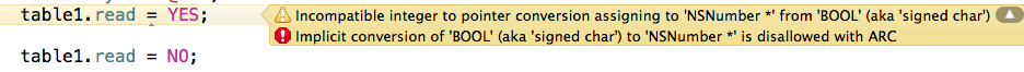

As for odd behavior, the following is whey you have to be careful.
When your property is defined as a NSNumber, trying to assign raw YES or NO has issues. The YES is caught as a compiler error and the NO is not noticed as an issue at all. The problem with that is that the assignment of NO ends up placing NULL in the column. See the attached image for this problem.
If you setup your properties to use scalar values (BOOL) then assigning NSNumbers numberWithBool values, it ends up setting the columns to something other than 1 or 0. Last week when I responded the numbers were 80 and 88. Now they are 92 and 100. Xcode does warn you about the inappropriate assignment.
Now, given the above quirks, you can see why you would get unexpected results. Any one line in error will give unexpected values. This is why you really should check your DB, and pay attention to any compiler warnings.
