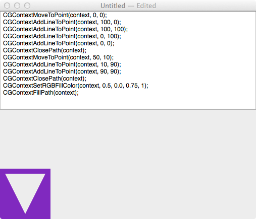

First screenshot of my first working prototype (attached to this post)
I got it working with a tiny bit of regex (to remove comments and whitespace) coupled with this NSScanner code:

I've tested it a bit and it's quite snappy with code of this length. I haven't tested how much code you have to type before it starts getting bogged down.
