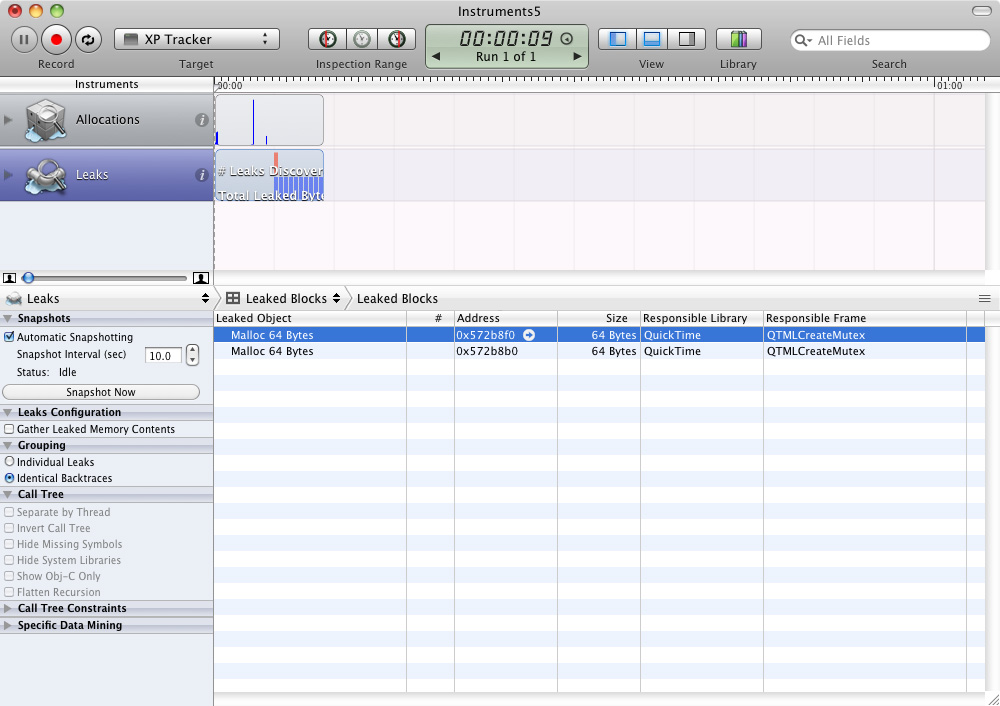

Here is a photo of the leak

I discovered something interesting about my Memory leaking NSSound. I opened it up with Xcode 3.2.6 and ran the Instruments leak test and it did NOT leak. Reopened it with with Xcode 4 and it LEAKED again. I even tried to take ownership of the sound
Code:
dieSound = [[NSSound alloc] initWithContentsOfFile:[[NSBundle mainBundle] pathForResource:@"dieRollSound" ofType:@"aiff"] byReference:NO];
So I could release it myself and it still leaked.
Fine in Xcode 3 and leaks in xCode4. Weird.

Thanks for that code snippet. I will try it tonight when I get home. One thing I did notice late last night with the leak I forgot to mention, it leaks all by it's self. I just have to launch Instruments and let it sit for 5 seconds and it starts to leak. No buttons pushed or anything. It said the problem is in my awakeFromNib method with that same code.
Thanks again. I will test tonight!
