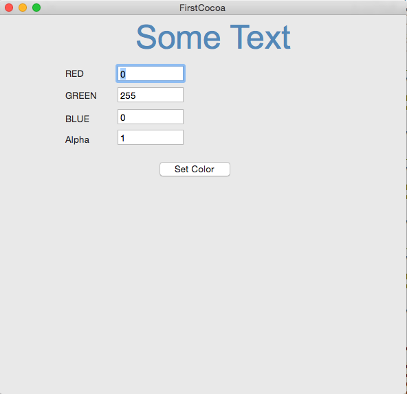

Hi Guys,

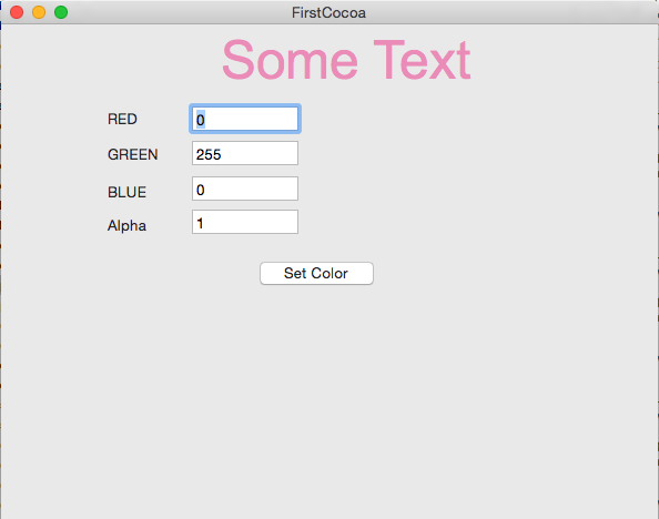

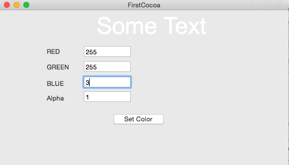

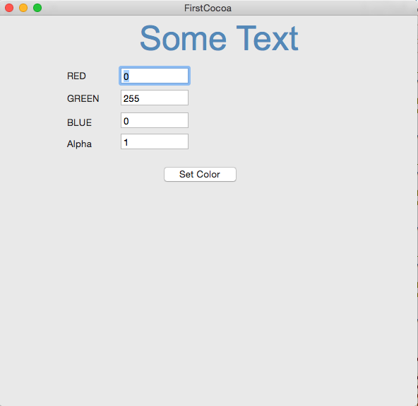

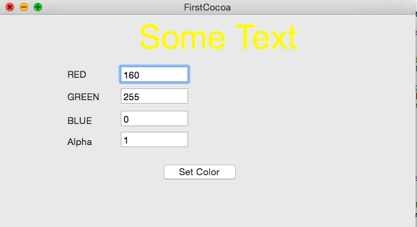

I'm having trouble setting Colors to an 'NSTextField' instance.
Here are some screenshots
I set the RGB values using 'colorWithCalibratedRed' API of NSColor to the 'NSTextField' instance. But the values dont seem to change
Green label here

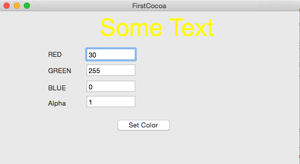

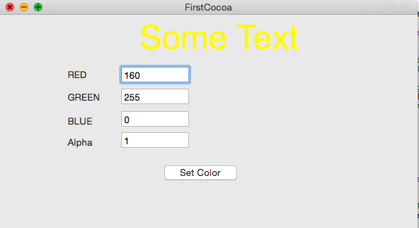

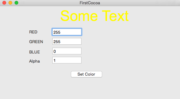

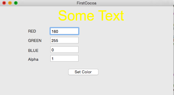

Changing the Red value makes a change to yellow
But changing the Red value does not change the output - it is yellow always

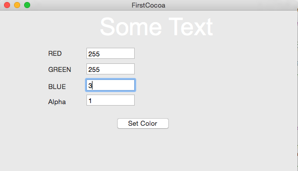

Adding a value to the Blue textbox, removes the color!

The documentation says this
Code:
+ (NSColor *)colorWithCalibratedRed:(CGFloat)red
                              green:(CGFloat)green
                               blue:(CGFloat)blue
                              alpha:(CGFloat)alpha
Parameters
red
The red component of the color object.
green
The green component of the color object.
blue
The blue component of the color object.
alpha
The opacity value of the color object.
Discussion
Values below 0.0 are interpreted as 0.0, and values above 1.0 are interpreted as 1.0.
So it has to be between 0 and 1! How dumb of me to miss that point!
So how do we translate R, G, B values into decimal values between 0 to 1?
Oh god!
Code:
                               blue:(CGFloat)blue
Parameters
red
green
blue
alpha
Discussion
Okay!!!
What i needed to do was to convert the 8-bit int RGB values into a 0.0-1.0 float values. To do this simply divided my int value by 255.0. That gave me the correct float value!
It works fine now!
Thanks 'grandM' for your help.
Moral of the story - read each and every line of the Documentation properly!!!
Okay!!!
It works fine now!
Glad to help out
I quick hack if you are coming from a RGB environment is to simply put
Code:
x/255
where x is the R, G or B value. In the OP's second figure, putting the red value as 30/255 would have achieved the desired effect.
