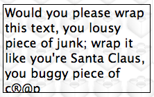

I have an NSTextField in a window, created by choosing the "Multi-line label / Wrapping Label" object in IB, and it is sized, fonted and otherwise parameterized to support a stringValue being wrapped when it is long enough to do so.
I want the field to look like this:
attachment.php

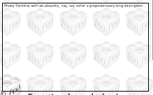

and it does look like that... about half of the time. The rest of the time, cocoa shrinks the text, sometimes horrendously, like this:
attachment.php
If you're wondering, that's a point size of 5. It's utterly unreadable and completely absurd.
