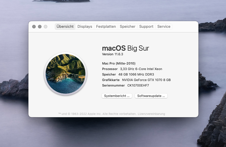

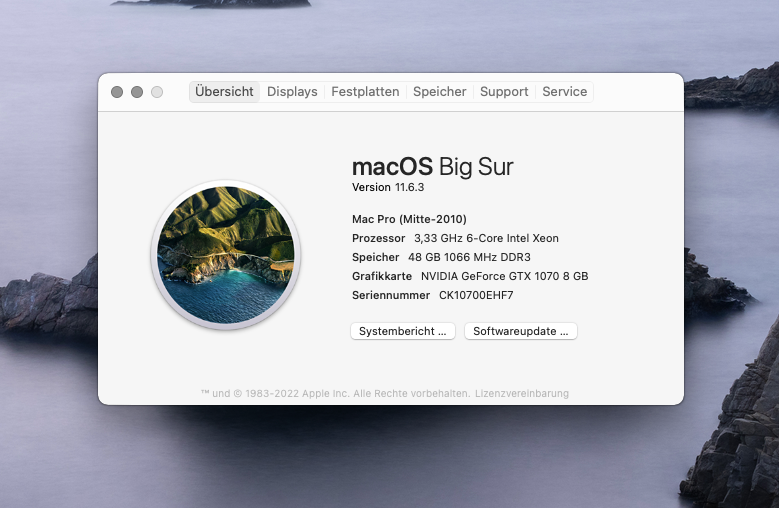

It finally worked!
Had to stick the 1070 and one of the stock 5770s together to get the root patch applied,...as i got no image from the 1070 without the patch and could not patch without nvidia hardware onboard. So no space left for my Monterey NVMe. I had to use some SATA SSD wit Big Sur on it instead.
Also had to run the script from the certificate revocation thread with the the OS-version-checking-part deleted.

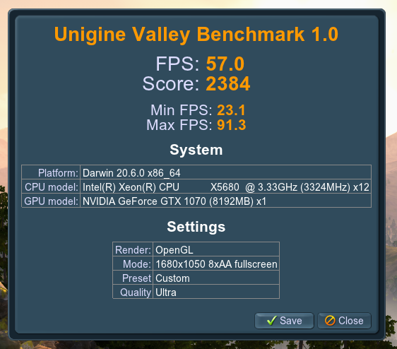

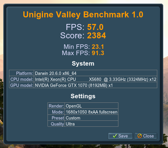

But now everything works as expected. Sure, no Metal. But OpenGL seems just like with High Sierra. At least Benchmarks like Valley offer equal scores:
Reactions: tsialex
It finally worked!

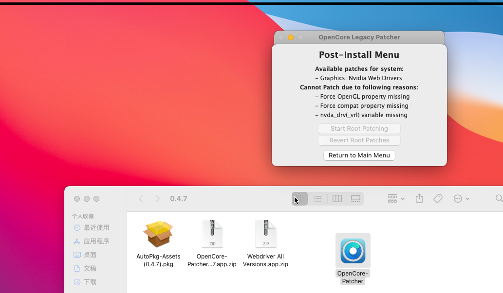

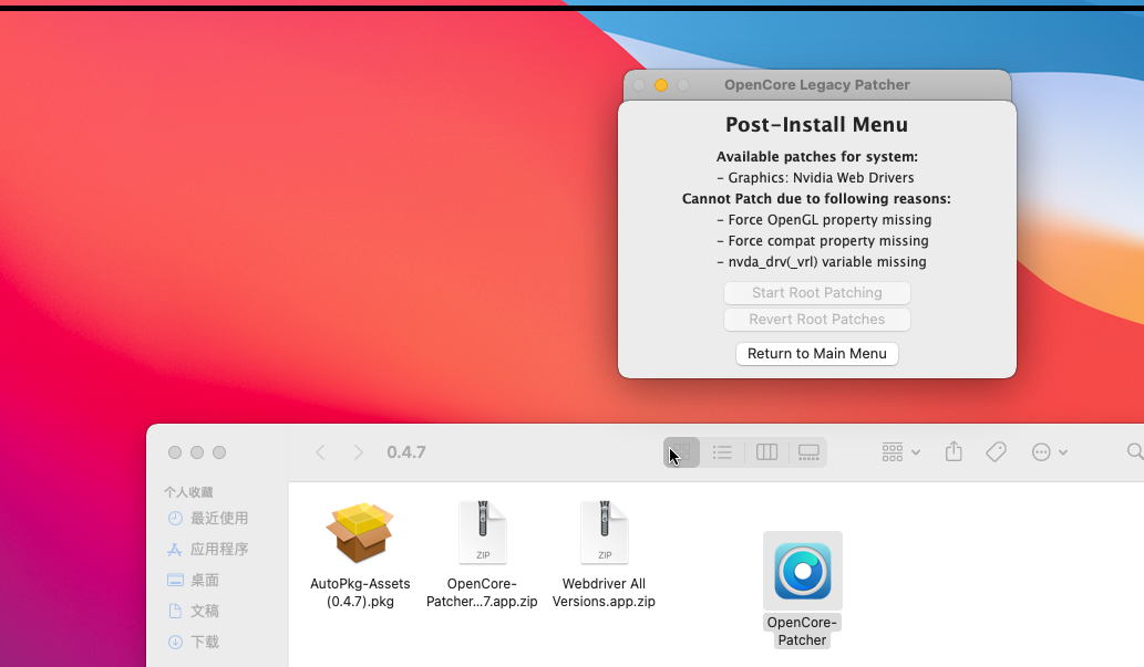

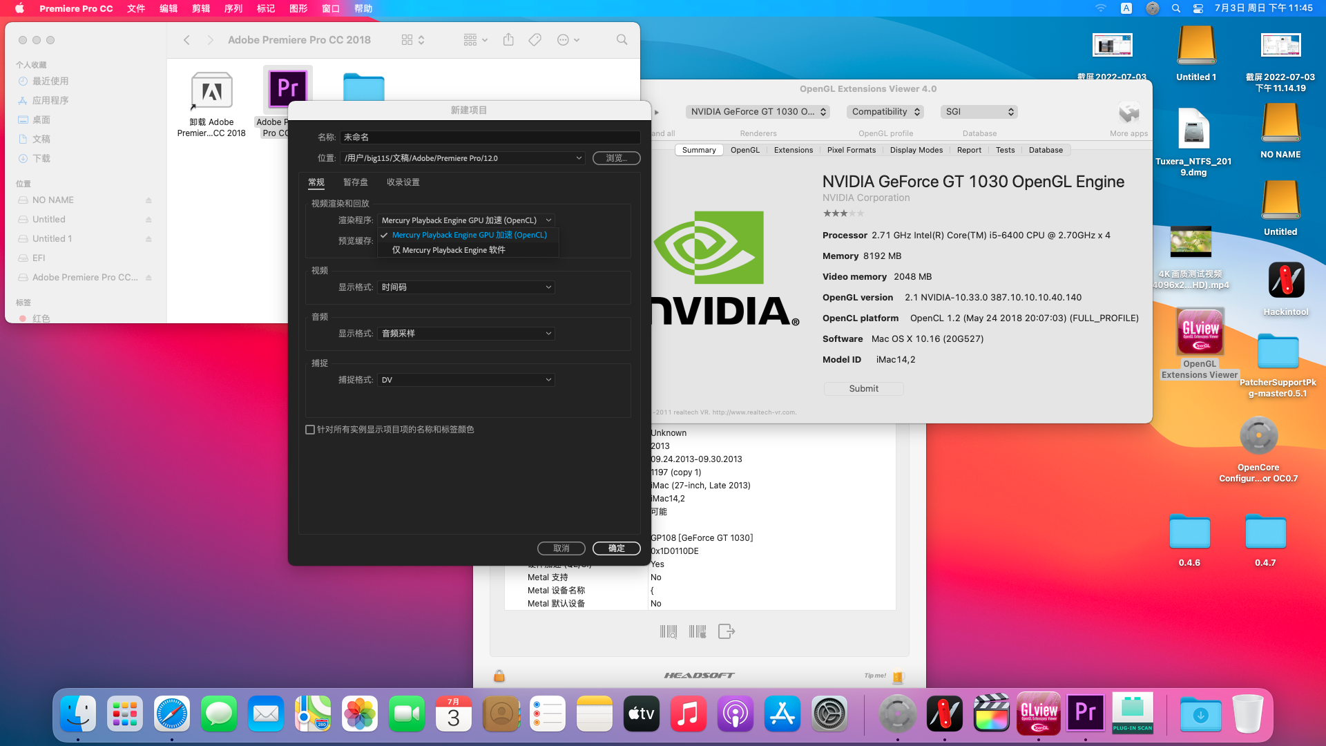

Hi there,
i have a GT1030 graphic card.
I try to installed WebDriver on BigSur. but failed. OCLP GUI 0.4.7 can not patch...as the photo attached. OCLP TUI 0.4.6 can patch but no acceralation at all.i don't know what i have missed.
would you help me how to patch it?
many thanks,
lin

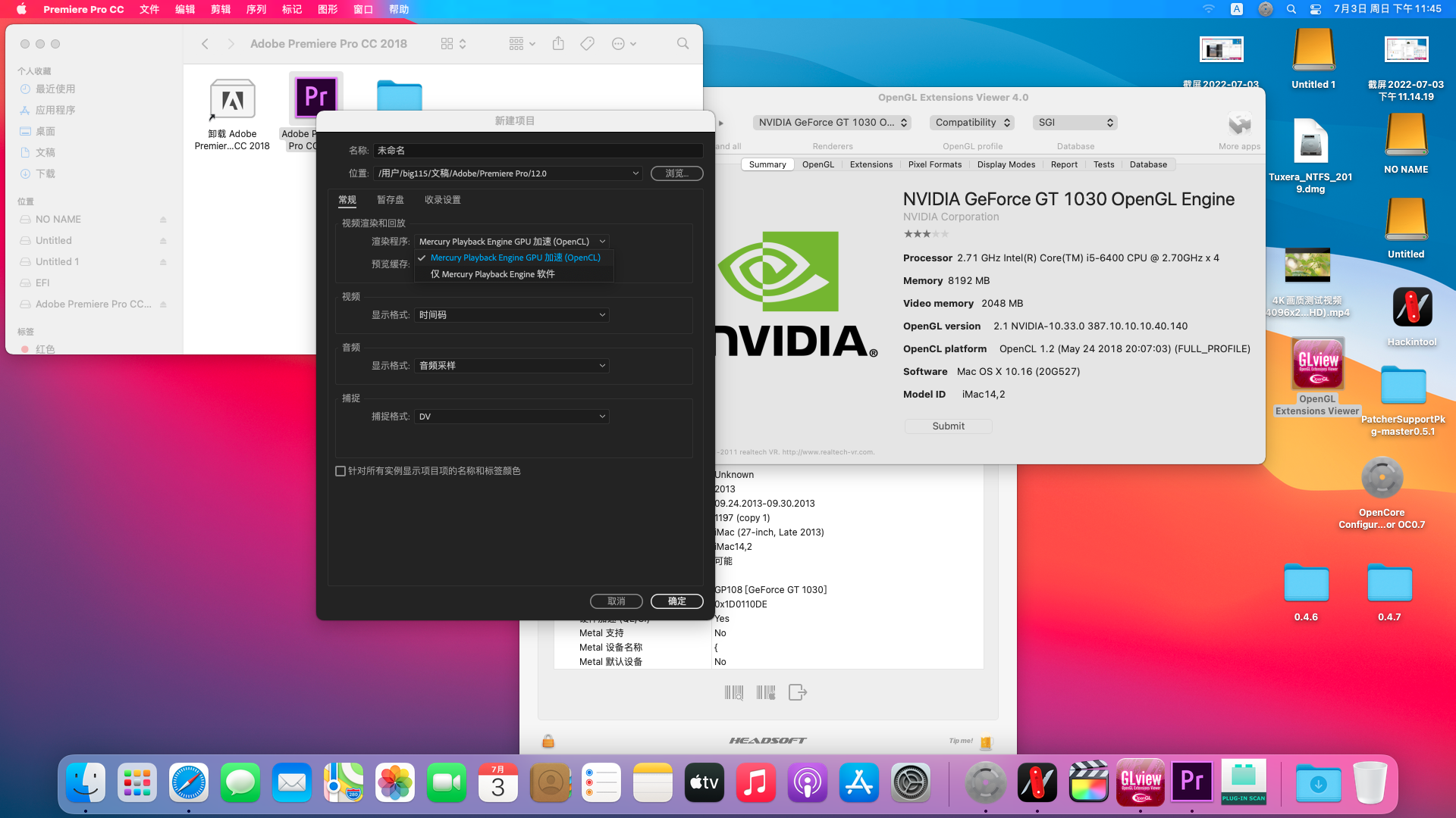

Finally worked! Final Cut Pro not working without Metal.
