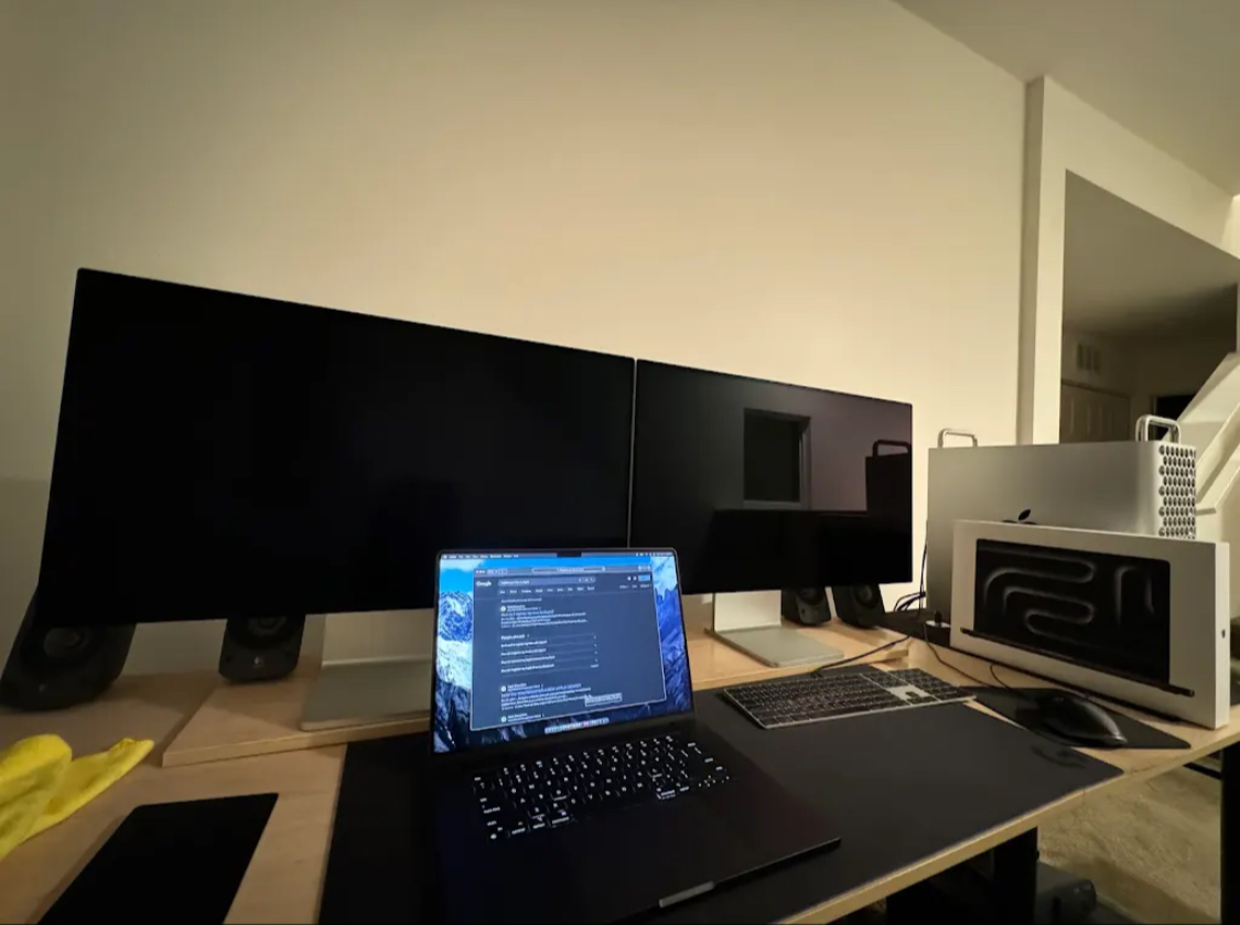

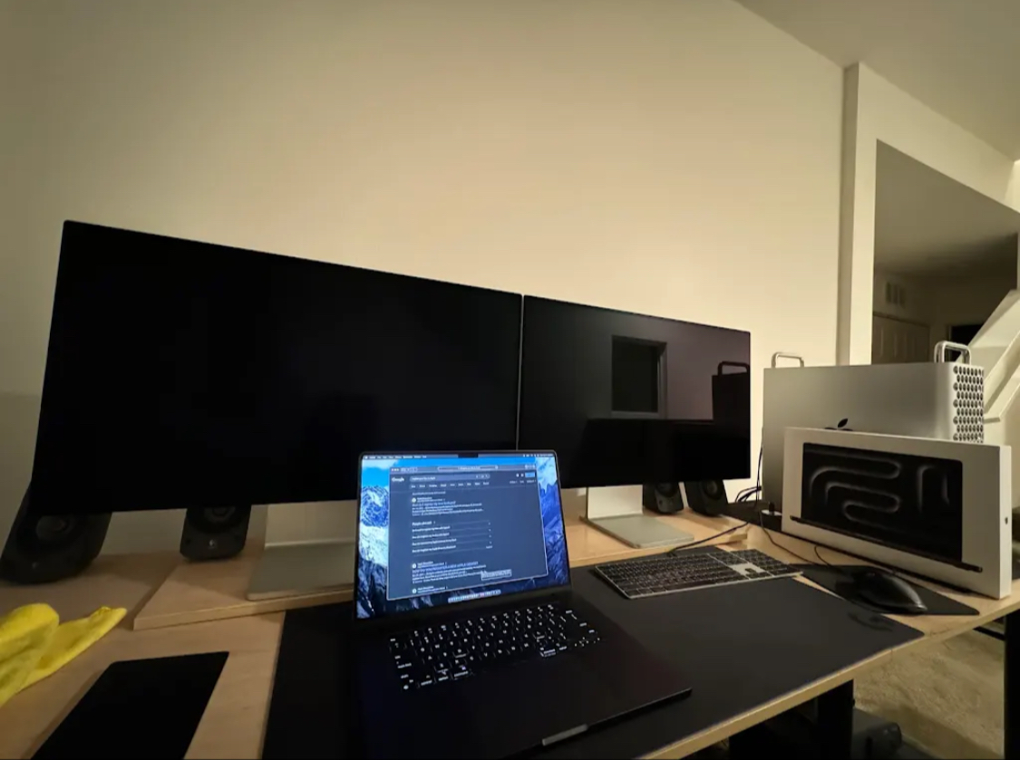

I tried the Titan RTX and it work fine under bootcamp, My question is I know that the 5090 will work on the Mac Pro under bootcamp but my problem lies on I have two Pro Display XDR and on the 5090 it does not have thunderbolt 3 on the 5090, Did some research can a thunderbolt 3 to DisplayPort cable work on the XDR to the 5090 or do I have to buy other monitor, I spent $14k on my XDR"s and it takes majority of the space on my desk
View attachment 2480442I tried the Titan RTX and it work fine under bootcamp, My question is I know that the 5090 will work on the Mac Pro under bootcamp but my problem lies on I have two Pro Display XDR and on the 5090 it does not have thunderbolt 3 on the 5090, Did some research can a thunderbolt 3 to DisplayPort cable work on the XDR to the 5090 or do I have to buy other monitor, I spent $14k on my XDR"s and it takes majority of the space on my desk

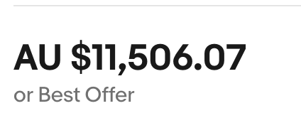

The other crazy thing is the price of 5090 Founders Edition:
https://www.ebay.com.au/itm/388320413548
Pretty crazy price. With the prices of GPUs, RAM, etc I am just not upgrading anything. I'm not going to be bothering with gaming on any computerst. Paying $10,000+ is nonsense. Even $6000 for the regular 5090 RTX is absurd.
I can get it around $2,000-$2300 USD locally which is still crazy high, but would love to play @ 4k-5k 60fps maxed out on studio displays at 4k.

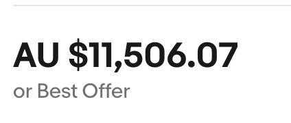

Pretty crazy price. With the prices of GPUs, RAM, etc I am just not upgrading anything. I'm not going to be bothering with gaming on any computers. Paying $10,000+ is nonsense. Even $6000 for the regular 5090 RTX is absurd.
To be fair, that one listing appears to have the same photos as multiple listings from multiple vendors at differnet prices, so probably scam 😉
