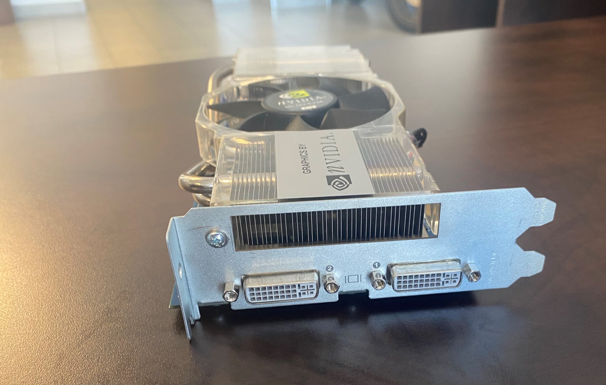

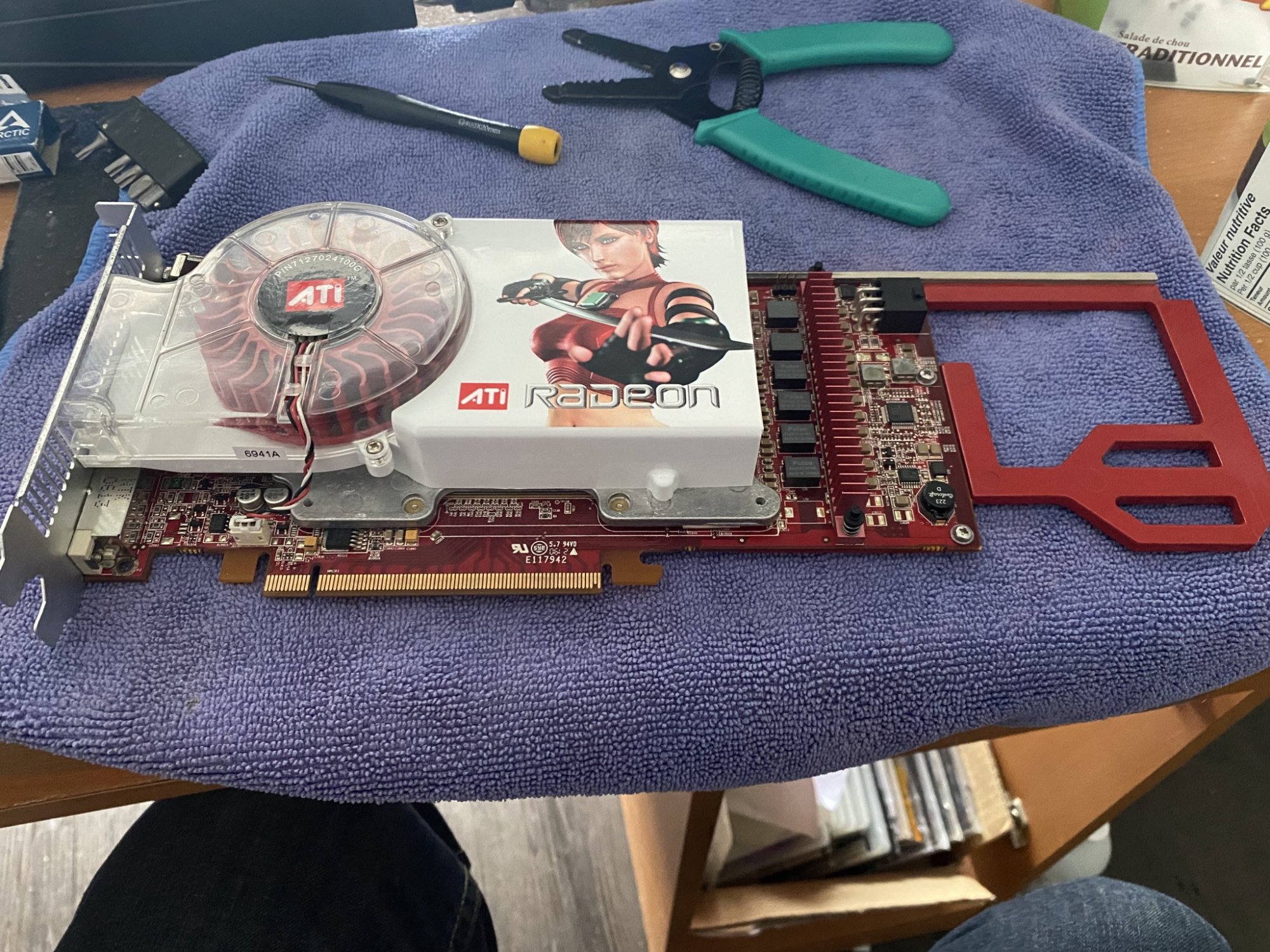

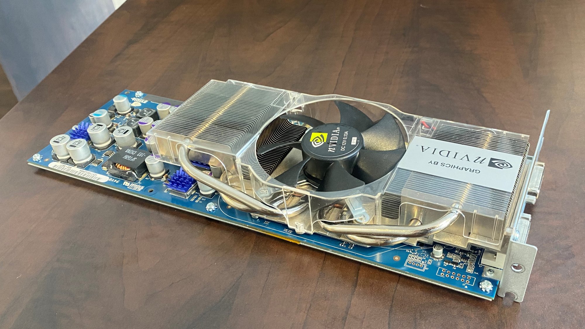

While I’m waiting for my card to arrive ( its in Erlanger Kentucky atm) I modded my flashed x1900gt ‘mac edition’. The card I flashed is exactly the same as the real G5 edition.
The x1900xt macpro edition share the exact same board layout but have a double wide more beefier cooler and as a bonus, it push hot air out of the case and not backward like the gt card.
On the gt card, the svideo out is now blocked by the bracket but it doesnt create any interference. Everything bolt up perfectly. I’ve used the original gt xclamp for the gpu since it apply more pressure. Hope you like. Its fun, its like playing wth lego 😛.

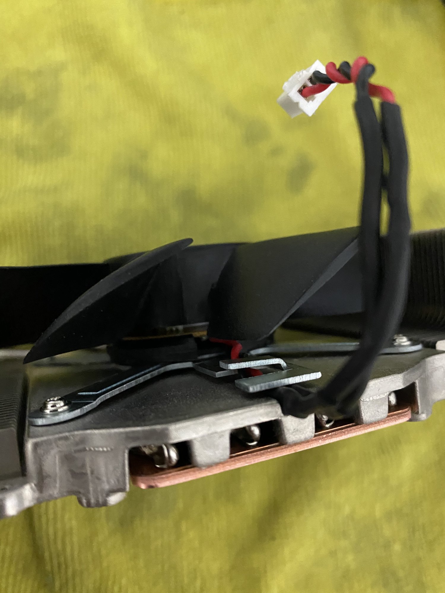

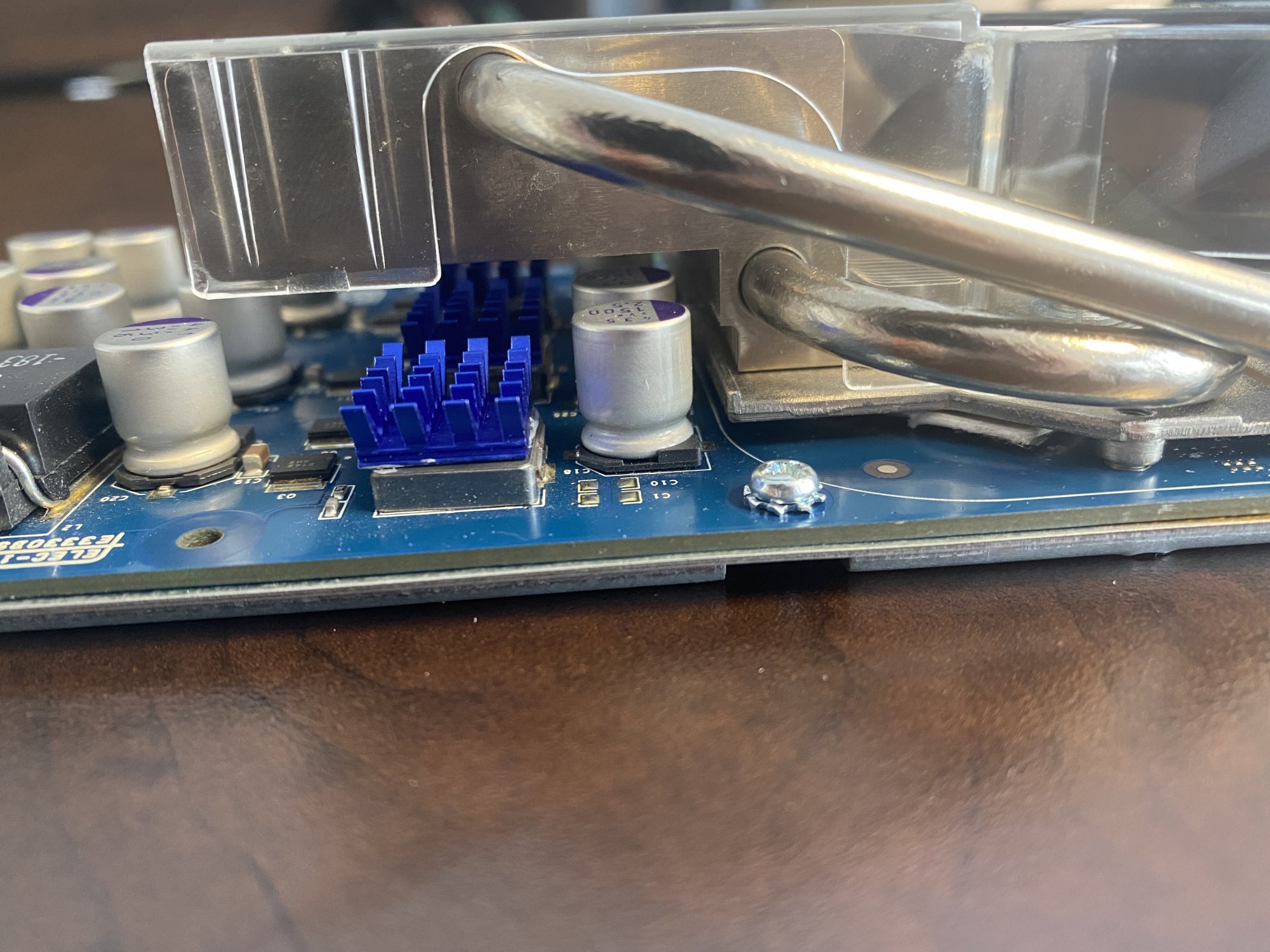

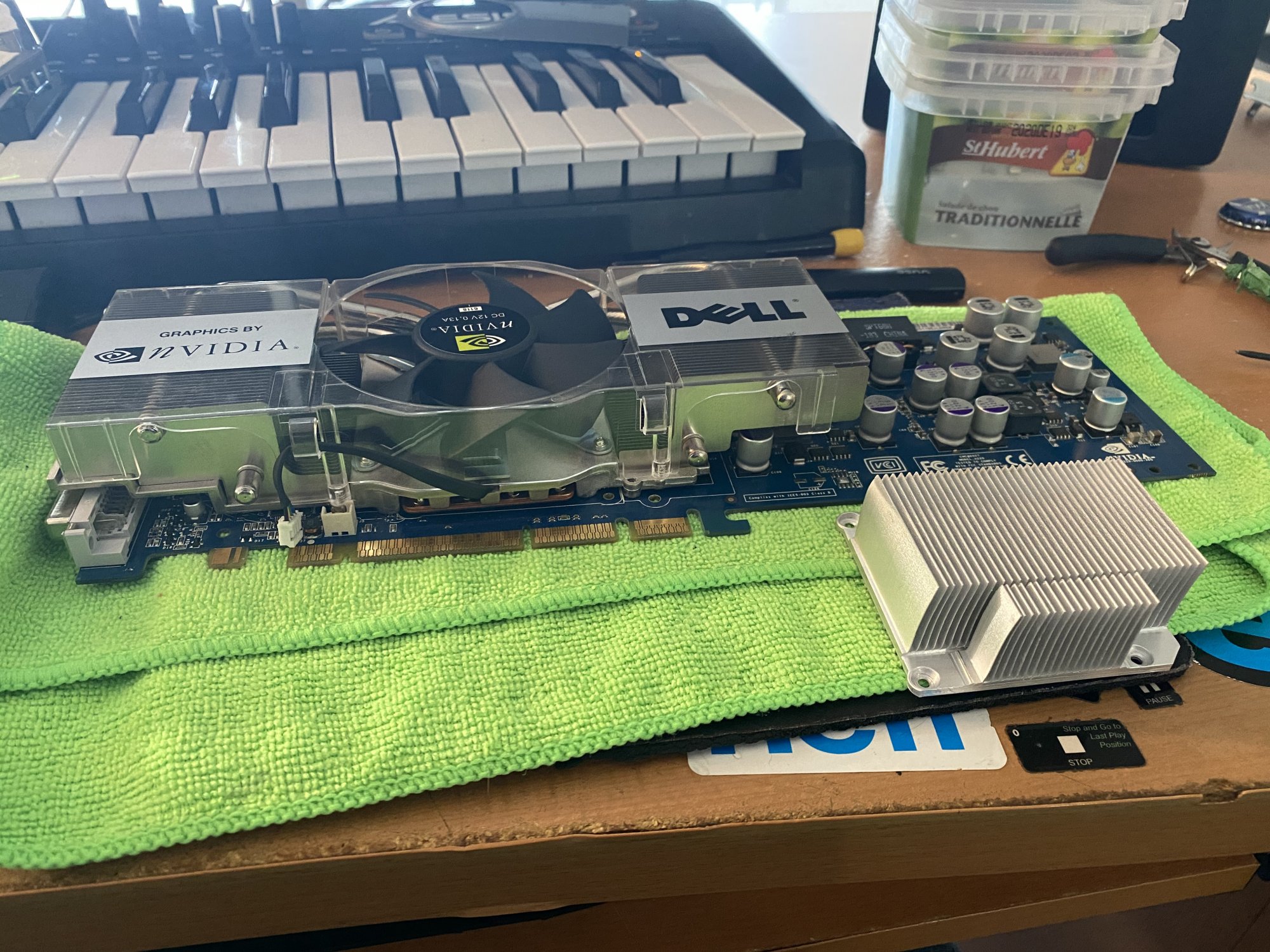

Doing some ‘R&D’ . I need to cut the front bracket so it can push air out and cut the heatsink to have a clearance for the big caps in the back. Thats more of a challenge than I thought. At least, that little aluminium heatsink from the original cooler will be replaced by that big hs with copper plate and heatpipe. Until I’m done I’l use a radeon 9600pro. For the fan, I didnt check yet, but I have high hope I can swap pcb and make new wire (6800U use 2 wire fan, 7800gtx 4 pwn fan). Also, I’l have to buff the mounting point on the 7800 cooler because it is about 0.015 inch higher and it doesnt make contact with the die.
Reactions: AphoticD
Voila ! The '6800 ultra frozr edition' 😁 I'l test tonight or tomorrow and post my temps. Hope you like.
The new cooler is almost a direct fit (same bolt pattern, same height)
What I did:
- Use the fan hub from the old cooler and glue it on the new fan bracket.
- Cut the back of the heatsink to make way for the capacitor
- Cut the front bracket to let air flow.
- Glue heatsink on vrm with home made thermal adhesive (just in case, why not)
- Use a mix of screw from the 7800gtx and 6800 with some washer and yadi yada.

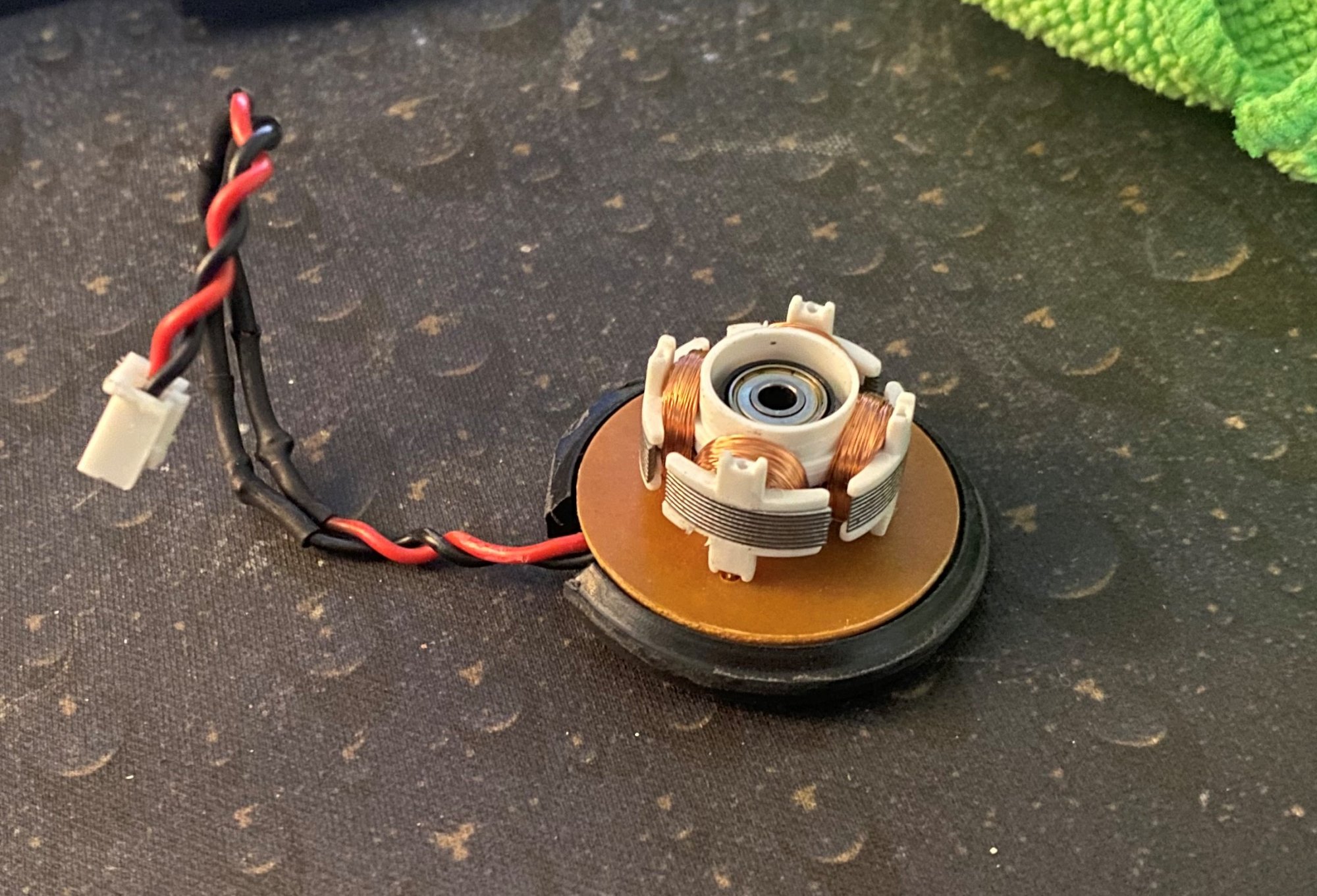

Update: Oh no, the c-clip + modded spring combo I used is too tight and the fan stop spinning after booting. I’l have to take appart the whole card to find a solution.
Ok final update.
I did remove the shortened spring I made and now the fan spin freely.
Heres my temp:
Idle: 50c (was 70c)
Prey: 65c to 70c (was 85c, loaded from the same saved place, same test)
So, I hope it goes well for you. Cheers!

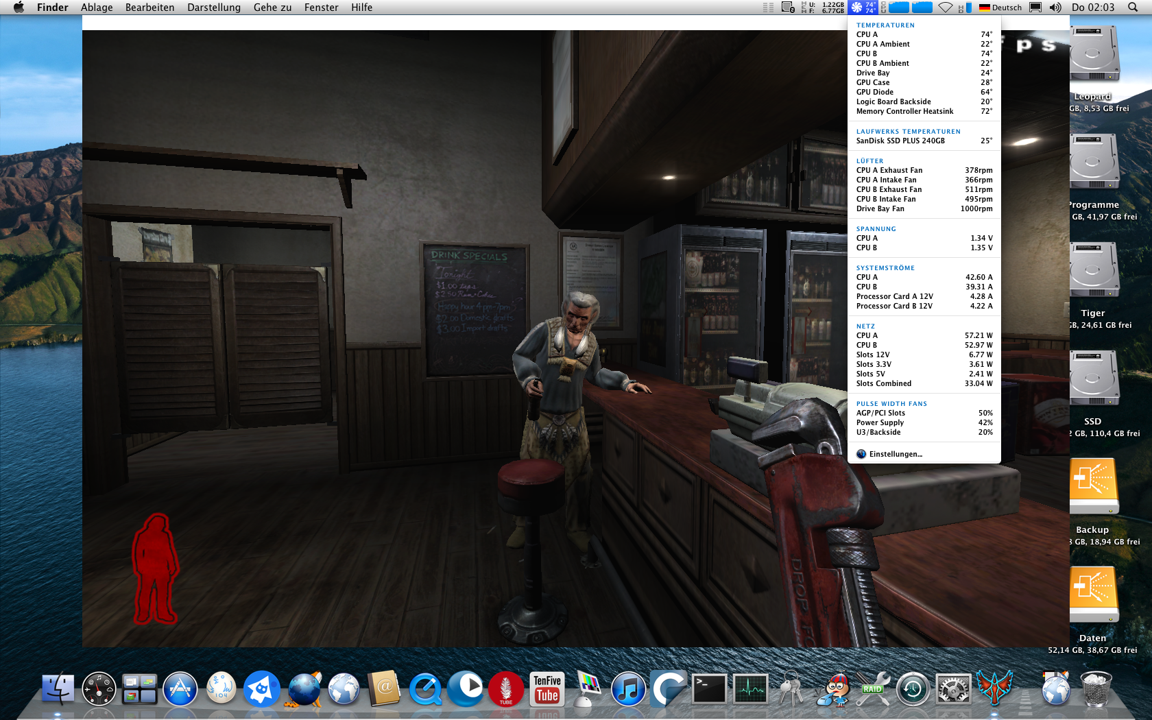

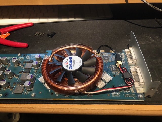

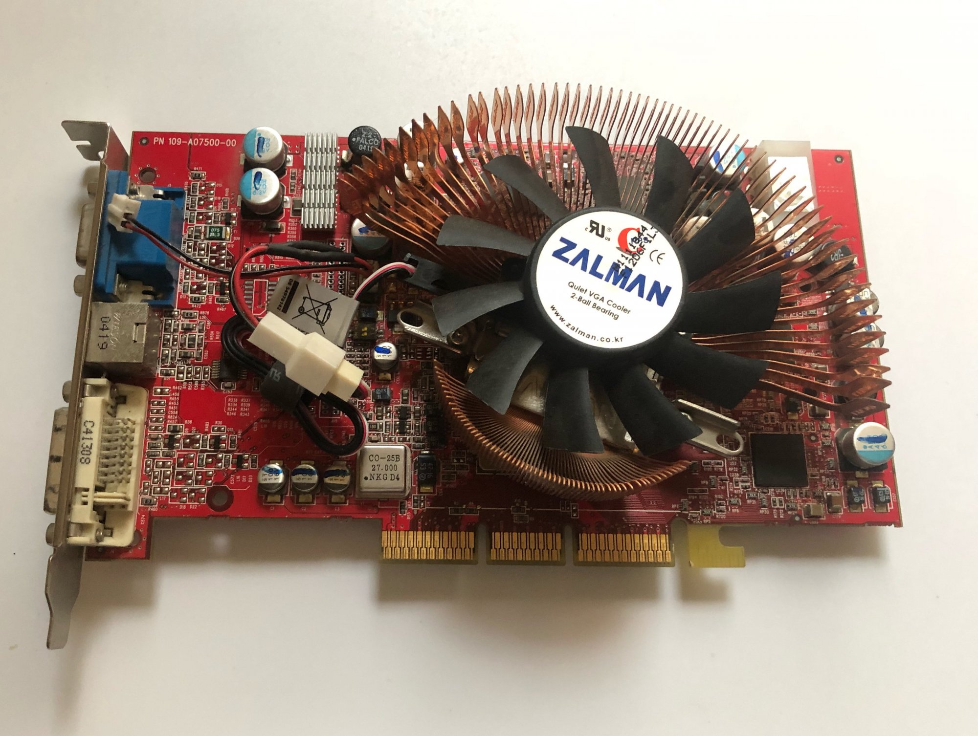

Hehe, i found the missing screws of my Zalman VF900-Cu inside my graphic card box. This mod is not sweet like yours, but it brings my 6800 Ultra down form 79°C to 57°C on idle and 64°C when running Prey on max. (shadows off)
My problem was, that the RAID Controller (with own fan) heat up the 6800 Ultra from 71°C around 79°C on idle, and got turbo fan when gaming. Now the GPU is much cooler
My problem was, that the RAID Controller (with own fan) heat um the 6800 Ultra from 71°C around 79°C on idle, and got turbo fan when gaming. Now the GPU is much cooler

55°C is a good temp. Is this a 6800, 6800 GT or 6800 Ultra?
With the better cooler you get longer life. I bring down the temp by over 20K on idle and 15K on hard 3D actions. i thing with you GPU the temperature difference in idle will be smaller, but on gaming the GPU will be much cooler and more silent.
You must shorten the knurled nuts too get the cooler inside the G5 (grind down until you find the brass in the middle).
