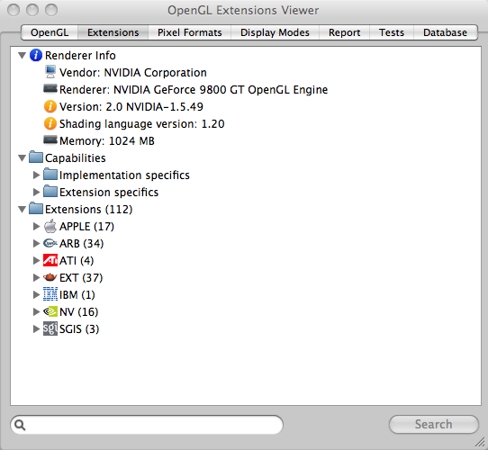

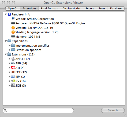

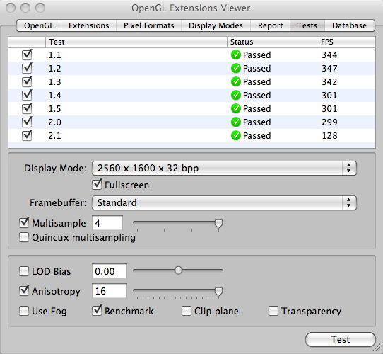

So I Toss Down the Gauntlet...in the form of a BFG 9800GT with 1 Gig of RAM. It is possible to run this card on the EFI32 ROM for an 8800GT...but then only 512 Megs shows up. And it seems that the fan runs too fast.
Using the Netkas injector package, it will run with it's original ROM, and all 1024 Megs shows up. Doom3 scores are about 7% higher with this extra RAM.
So we are starting off on an easy one. I am attaching the original 1 Gig ROM and the EFI32 ROM that you need to get EFI part from .

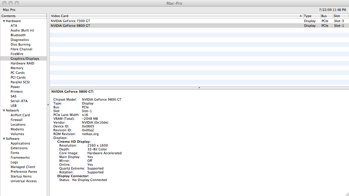

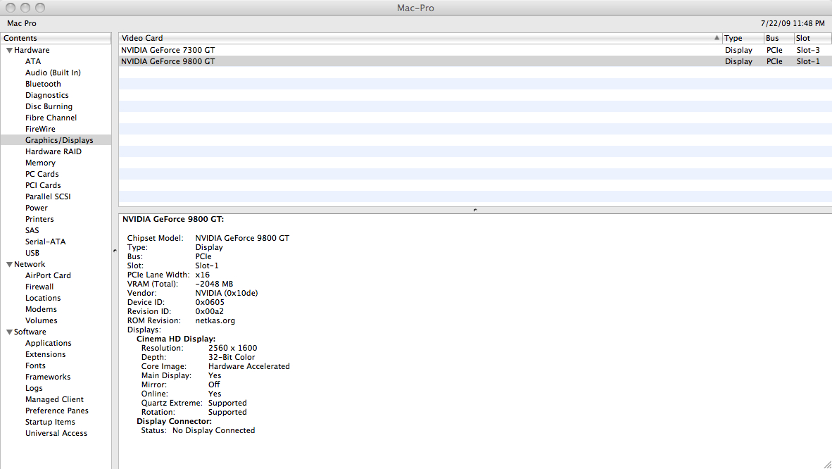

Hi Rominator:
I used your 98GT1G.rom file to flash an EVGA 9800GT 512 MB. Your flash files it's good and eliminates the mouse lag problem in OSX.
But i have a question, because windows starts with a black screen, i don't know what is the correct driver for this rom on windows.
Can yo tell me , please. i tried nvidia drivers, but not helped.
Just flash a EVGA 9800GT 512m with 8800GT hybrid efi. Everything seems fine but the the 98GT1G rom not working. Anyway working is my best expectation, good job guys.

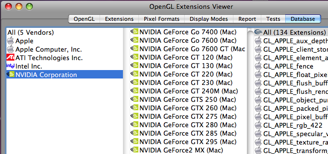

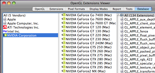

I just fired up 10.6.3 official release to try on my Mac 285 and 2G PC 285, then loaded OpenGL Extensions viewer to see what, if anything, had changed.
1. the 2G bug is still there - OGLEV reports -2G
2. The OpenGL 3 test still fails and OGL reports 91% of it only present
3. But here's the funny thing - if you go look at the drivers and filter on "Mac" it now claims to see drivers for Nvidia GTX 260,280,275,285 and 295...
I have to wonder why it reports this given that there is only an official 285 for the Mac, and with the 295 you only see the benefit of one GPU unless you run a multi-GPU app.
Is it remotely possible that some combination of an '10 Pro and 10.6.3 will support PC cards out of the box, with some injector-type thingy built into the ROM or boot code to overcome the lack of EFI on such cards? This might be a wild extrapolation but I can't figure out why else those cards might all be listed.
no point in doing that when those cards stopped selling and manufacturing a long time ago.
Are you referring to the 8800GT, 9800GT, or 9800GTX? I think you can still buy a GTX new, and besides, tons of rabid upgraders probably have these lying around.
(Says the proud owner of an 8800GTS 640)
I was referring to this:
no point for Apple to add drivers for cards that stopped manufacturing.
Isn't the problem that the Geforce 9800 series is based on the G98b 55nm chip, contra the Geforce 8800GT on the G98 65nm chip?
Although technically the same (in loose terms), the newer chip is not exactly G98.

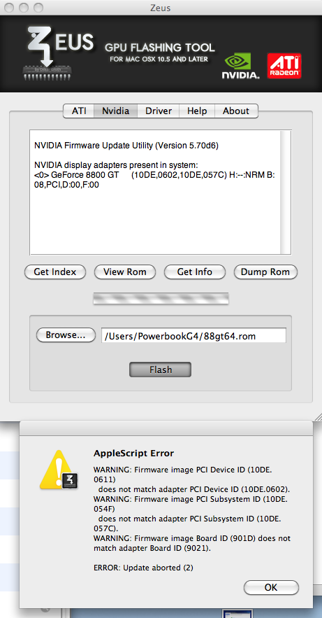

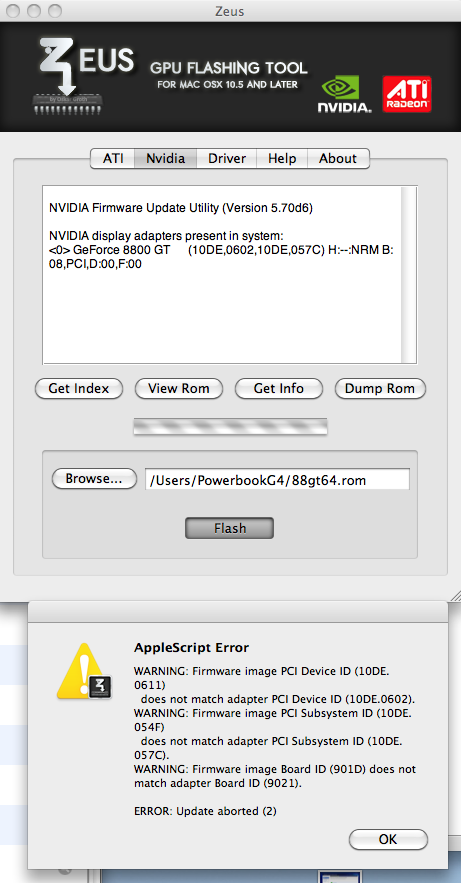

Cindori has done us all a great service by including Nvidia support in Zeus. I am hopeful that he will get a chance to add some power and flexibility to it so that the device id flags, etc can be dealt with.

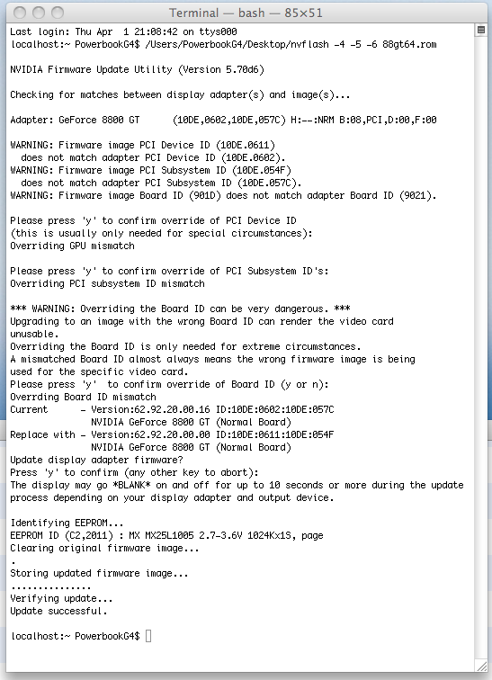

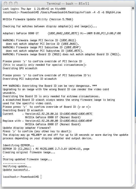

Meanwhile, for anyone who wishes to fiddle with G92 ROMs or who wants to change an EFI32 8800GT to an EFI64 one, here is how to do it. While this is specific for 8800GT EFI32 to EFI64, the method can work for other flashes that Zeus does not currently support.
0. From the included files, drag the ROM you want to flash to your user folder.
1. From the included files, load the Nvidia kext. (do this however you prefer)
2. Open a terminal window and drag "NVFlash" to it.
3. Before hitting return, type "-4 -5 -6 88gt64.rom"
4. NOW hit return.
5. You will be alerted that various ids aren't the same. Keep hitting "y" until it quits bugging you.
6. Flash will hopefully go through as in my example. This will in THEORY work for any Nvidia card that has loaded into system. Note that multiple Nvidia cards are NOT supported in a useable way.
