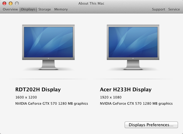

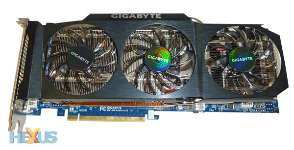

Yup! Your heat will go up inside the case, by 7 to 10c on average under typical use. My GTX 570 card has 3-fans and I'm using smcFanControl so that's not a residual build-up either.
May I know what is the Vram of your Nvidia 570GTX? Is it 2.5Gig? Does this mean all 570GTX cards give out heat a lot?

I guess it's like that for all GTX 570 variants.
