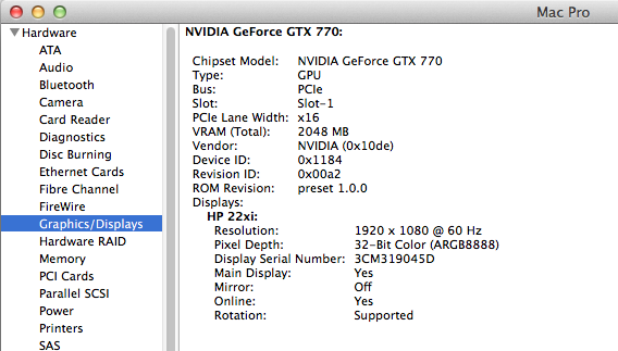

Well my system is back up and running, EVGA replaced the card with a new GTX770 which appeared to have an updated firmware? Unsure, but with the new card fitted, a number of tests carried out and the newest drivers and cuda software downloaded and all seems well...

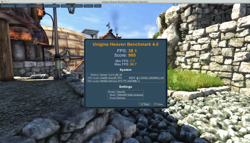

@leXr, now that you fixed the problem - would you be so kind and check which score your card gets under Cinebench R15 OpenGL-test? That would be great. I am just figuring out which card above my installed ATI 5870 (in a MP 5.1, 12c x 2.93 ) scores higher. My score is 62 fps and I am in need of something around 80 fps or higher. Thanks in advance.

Yes ill run the test tonight and post the scores/results here, got a small issue with the fans not behaving as normal after the osx 10.10 public beta, I've reset the SMC but the apple hardware test stalls during the pre test so can't work out what changed... I'm able to control fans with istat but not ideal.
