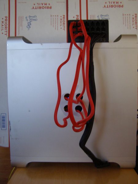

A single ODD SATA connection is not going to provide the 75 W a 6 pin PCIe booster connector on the GPU expects . No where even close . You need to work off the backplane and grab 33 W + 33 W from two SATA HDD Bay connectors . If your SATA HDD Bays must be occupied with HDDs , then an alternative is to use an external PSU and drill holes into the side access panel of your Mac .
Why MUST a HDD bay be occupied to have to resort to that monster?
