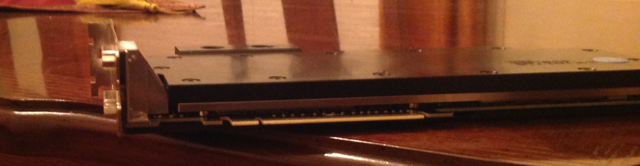

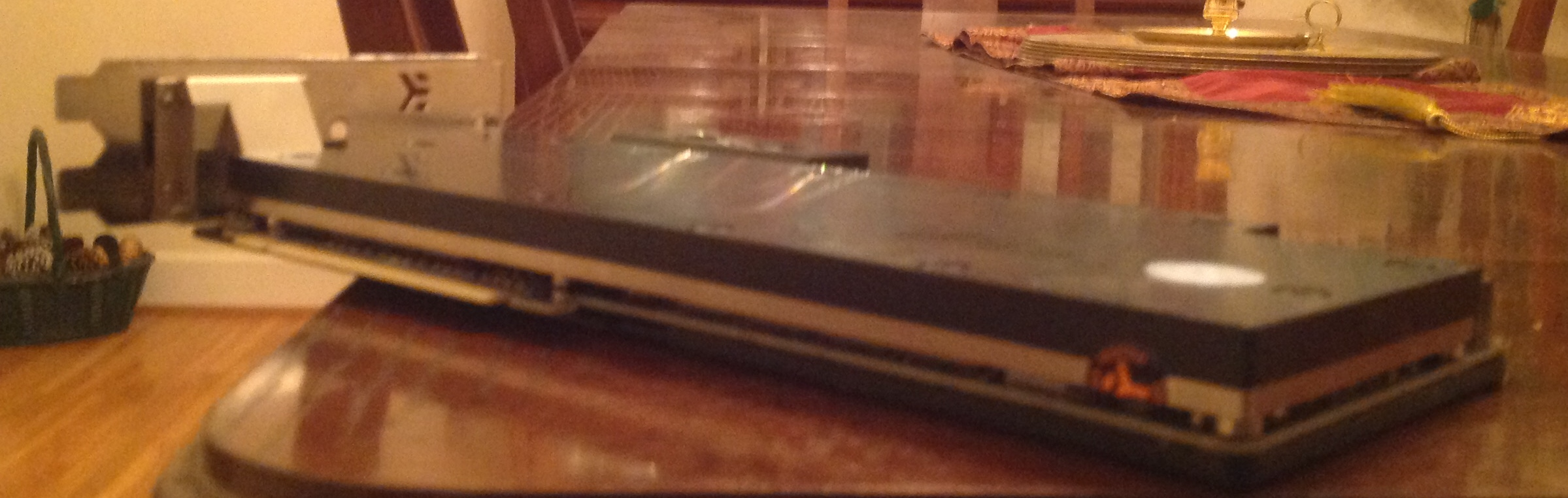

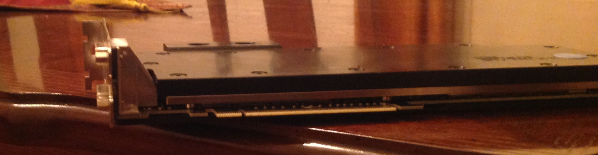

Regarding this latest twist - installation in slot 4: SUPERNERD to the rescue, well sort of. What happened to single slot GPU cards while I was asleep. Over 99% of the single slot GPU cards became dual slot GPU cards because they were made to run faster and faster and thus needed more elaborate cooling systems. So what, well if you want that Z in slot 4, you'd have to water-cool it (giving you a two slot card); but you could also perform (or have performed on your behalf) a surgical removal of one of a pair of video out connectors (this is the hard part - not the cutting itself, but protecting those wires from making contact with each other); then, cut that dual space attachment bracket in half (this is the easy part), to create a one slot warranty-less Titan Z. Who'd be crazy enough to do this? I won't be naming names, but all of you know who you are. I've heard that this takes only about 20 minutes from start-to-finish. Then voila! a one slot warranty-less Titan Z.

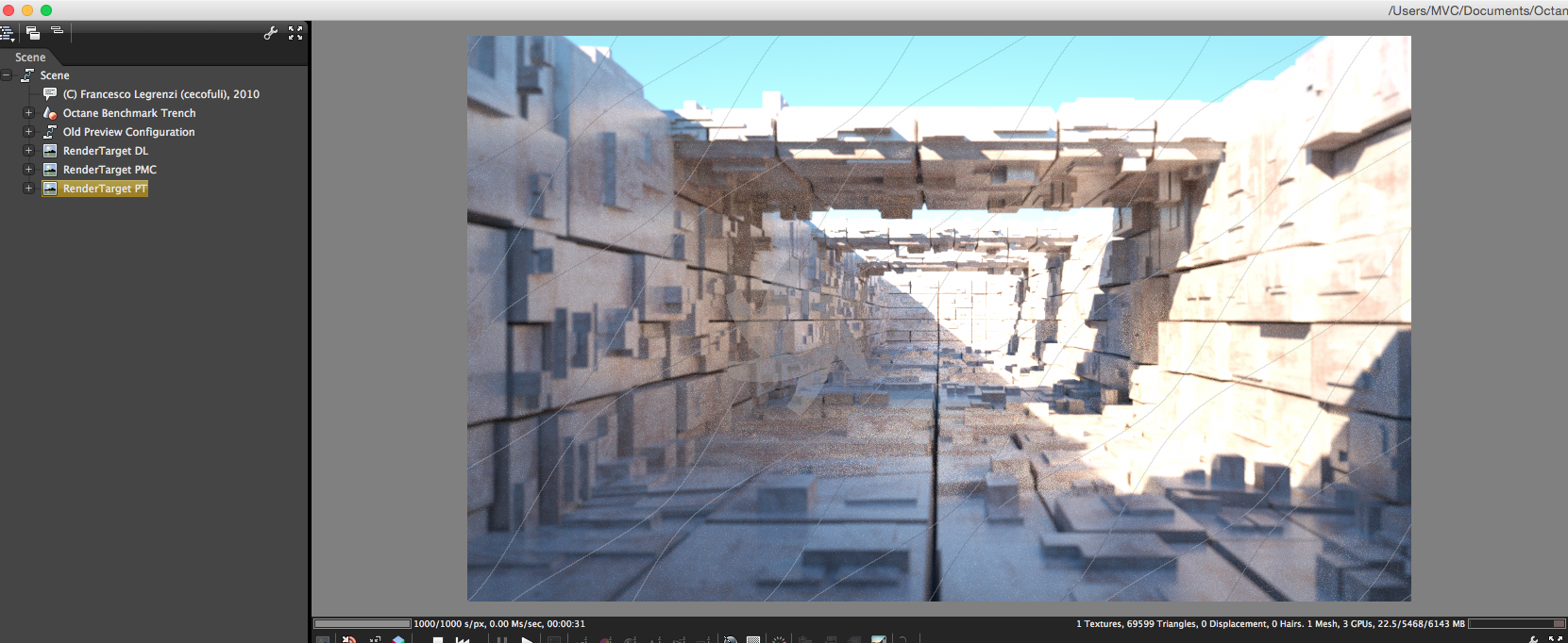

You can use OctaneBench Scores [ https://render.otoy.com/octanebench/results.php ] to test or research CUDA performance in Octane Render. For example,
Quadro K6000 score = 82 on OctaneBench;
Quadro M6000 score avg. (so far more tests done with it) = 124 ;
124 / 82 = 1.51219512195122 or ~1.5x faster at rendering
Therefore, Quadro M6000 renders 1.5 times faster than Quadro K6000; but
GTX Titan X scores avg. = 135 on OctaneBench - ;
Quadro M6000 scores avg. = 124 on OctaneBench;
135 / 124 = 1.08870967741935 times faster at rendering
Therefore, GTX Titan X renders about 1.08 times faster than Quadro M6000 and
135 / 82 = 1.64634146341463
GTX Titan X renders about 1.64 times faster than Quadro K6000.
Quadro M6000's specs are a close match for the GTX Titan X's specs, but generally GTX line is faster.
Therefore, GTX Titan X is currently the fastest (single GPU processor) CUDA rendering card on market.
But GTX Titan Z (dual GPU processors on one card) has avg. score of 184 (on air its a 3-slot card; on water its a 2-slot card; in the hands of a crazy like me - it {or any other dual slot water cooled card} might be a one slot card after my Dremel tool does it's thing). But back to what you asked -
184 / 135 = 1.36; so 1xGTX Titan Z renders 1.36 times faster than a GTX Titan X and
184 / 82 = 2.24390243902439 or a Titan Z renders ~2.25x faster than a Quadro K6000.
So, a Titan Z (dual GPU processors) is the fastest single card on the market, if you can find one. I've got 6xGTX Titan Z's on water, split across 2 systems, but right now my Tyan Server w/8xGTX 780 TI ACX SC OC has the highest OctaneBench score - See my signature below or just go to the OctaneBench results site - https://render.otoy.com/octanebench/results.php . You can download OctaneBench here: https://render.otoy.com/octanebench/ .
