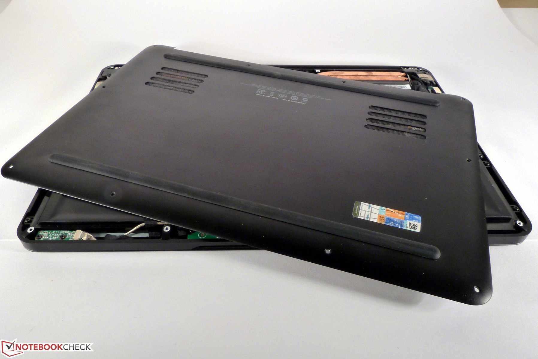

In regards to feasibility of slotting in a decent mobile graphics card: the Razer Blade, which is essentially a copy of the retina MacBook Pro 15" (down to the fan/cooling mechanisms), has a decent graphics card: the 870M, which isn't bad. It's a fraction (30%) of the performance that the 980M offers, but it's double what the 750M can do.

Quick question, regarding power consumption: The 14" Razer blade notebook, which is essentially a retina MacBook Pro 15" painted black (internals are suspiciously similar, especially the fan-cooling part. No idea why Apple hasn't gone after Razer yet.) has a GPU (870M) which has a TDP of 100W. The current rMBP 15" one has a GPU (750M) of 35-40W.

The Razer Blade is insane but the cooling system is actually different. It draws fresh Air directly from underneath. Not the back like the Macs. It has two heatpipes on each side rather than one (Apple) and a bigger heatspreader (about twice as thick). That is about twice the heatsink area more or less even in the smaller 14" chassis.
That increases its cooling power probably by some amount. It also gets really hot and is really pushing it. In the name of ergonomics they should probably have kept it with a 960M or the new 965M.
But both of these Apple could use with small changes like a stronger power supply and some small tweaks if they really wanted to.
The Razer is different and a simplistic design can just very easily look the same. Same as many thin notebooks are wedge shaped like the Air. If you don't put sharp corners on it it looks the same. And rounding some part of the bottom to make the whole unit look thinner than it is, is not something Apple invented. If you do that too, you can change little more than the color. Inside there is also not that much choice in how stuff can be arranged at such a small space.
All computer manufactures play lego with more or less the same parts. There are a couple notebooks that look quite similar to the Razer as well.
dusk007 already has a very good answer to this. I would only like to add that in order to achieve its superior cooling capacity, the Blade needs to make other sacrificies. For instance, it dedicate significantly less space to the battery (this is clearly seen from comparing the teardown pictures). All in all, the design focus lies on GPU performance which is a bit different from what Apple attempts to do with the MBP.
So no, I don't think that Apple would include a high-end GPU. But the modern GPUs have experienced an incredible jump in their power efficiency. A 35-40W Maxwell 2.0 or Maxwell 3.0 should deliver around twice as much performance in the same thermal envelope compared to 750M, which would make the MBP both an adequate gaming machine as well as a decent GPGPU performer for a mobile professional.
Excellent, thank you for the reply, and for clearing things up. I do understand that the internals of hardware tends to be the same, and although I like Razer, I do tend to have a feeling that some of their products (especially hardware, and the marketing part. Their videos on YouTube have a very Apple-Esque feeling to it) borrow quite a lot of ideas from Apple.
