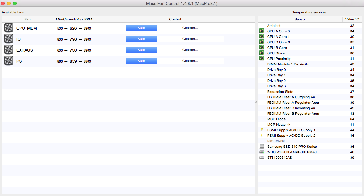

It worked fine! I successfully installed a GTX 750 Ti and i am also getting the both OS and nvidia updates!!!!
The only problem is that a fan kicks in very often and goes extremelly loud.
I downloaded the macsfancontrol software and i see the following metrics
CPU_MEM - This goes up high!
IO - This stays cool
EXHAUST - This goes up high!
PS - This stays cool
*See the attached file
Does anyone know a safe custom setup for CPU_MEM and EXHAUST to keep the noise down?
