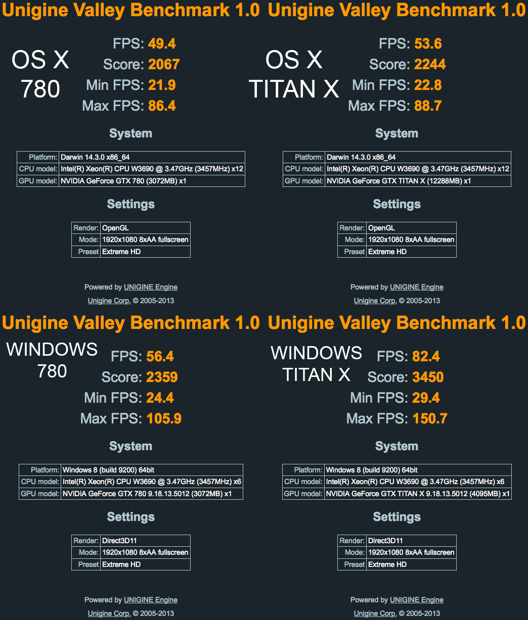

Got my card flashed by MVC. Some benchmarks:
OS X 780: 49.4
OS X Titan X: 53.6
Windows 8.1 780: 56.4
Windows 8.1 Titan X: 82.4
Large performance disparity between OS X and Windows but that's to be expected. Huge performance improvement on the Windows side.
Metro 2033 Redux 780: 46.58
Metro 2033 Redux Titan X: 82.67
Metro Last Light Redux 780: 54.16
Metro Last Light Redux Titan X: 97.49
Card laughs at everything I throw at it. Only 3DMark 2013 FireStrike Extreme brought it to its knees.
Also it fixed my Apple LED Display boot screen issue in this thread, so that was a nice side bonus:
https://forums.macrumors.com/threads/1859556/
Let me know if there's a benchmark you'd like me to run on it.

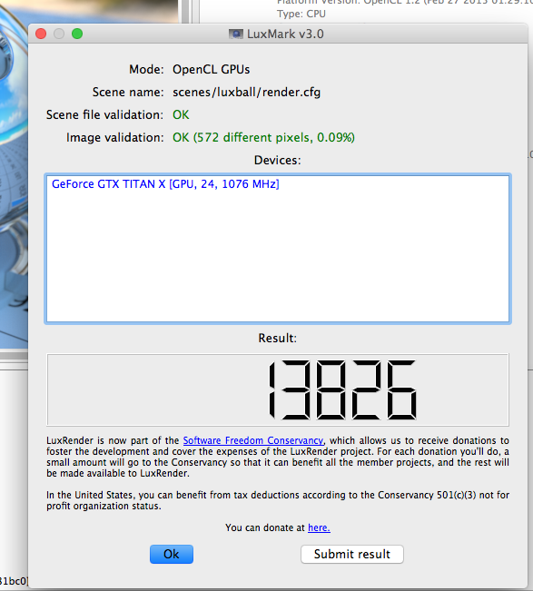

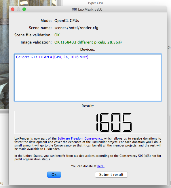

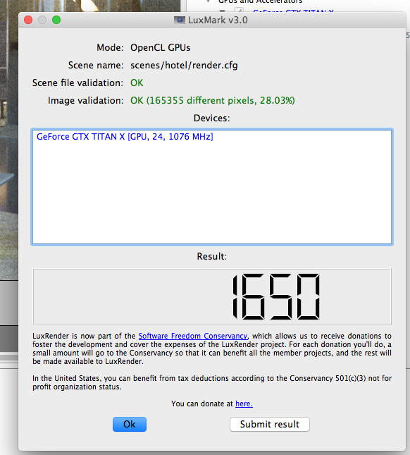

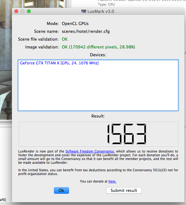

Got a lot of variation on the hotel lobby scene so I'll post a few. Luxball was fairly consistent.
Luxmark 3.0
Luxmark 3.0
Thank you, nice results! Hard to believe this is from NVIDIA and that is without native drivers from OSX, best of both worlds (CUDA and OpenCL). You should be able to have stable scores once the folks at Cupertino start adding Maxwell drivers to Yosemite, I have a feeling they will definitely go with Maxwell GTX 950M/960M for the upcoming MacbookPro Series along with Intel Broadwell/Skylake
Hope so. Doubt they will go Quadro for the nMP 7,1 (though I'd love to be wrong about that), as part of their war on CUDA.
MBP makes more sense: precedent, plus power+heat efficient Maxwell would be better for a laptop than AMD's offerings.
MVC's flashed card works without the Nvidia driver though. You get a bootscreen and can view the desktop to get the web driver installed, it just moves super choppy until then.
Yes, I really hope they go with Maxwell on MBP, that will motivate Apple to include the Maxwell Drivers on Yosemite. Meaning we will still have some decent support on the OS without having to install web drivers. Thanks for sharing..+1

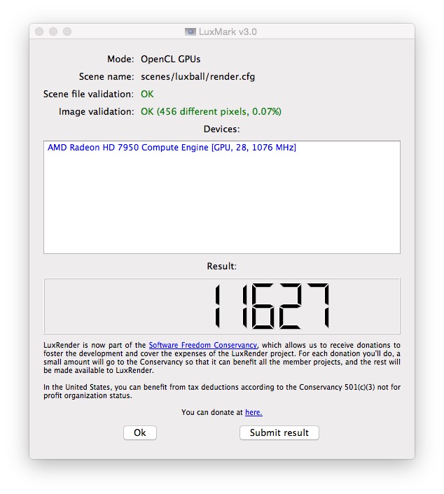

Is it something wrong? I OC my 7950 to 1076MHz and have the following result. Even though the TitanX is still 19% faster, but should it be more? I think the TitanX is much much stronger than the 7950. Driver issue?
There's a noted performance disparity between OS X and Windows.

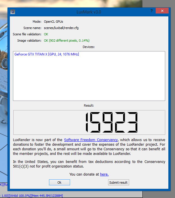

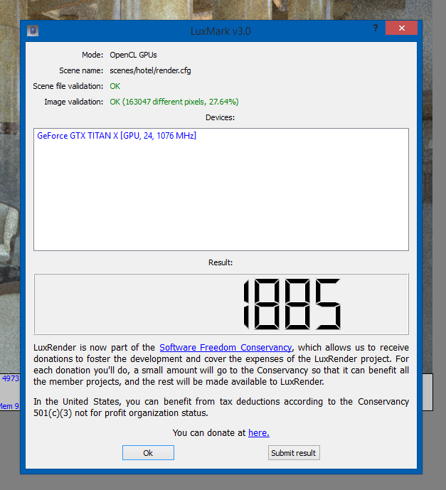

Some Windows benchmarks:
