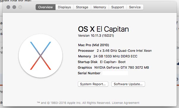

Successfully updated.
It did however still have that annoying issue like the 10.11.2 update. After installing the update and booting for the first time, it has a mostly black screen with a progress bar in the center. It almost gets to the end but stops. Any key press results in the Mac making the 'Funk' sound. No visible cursor. Only option is to force shut down and power up, then it works fine. Install Nvidia driver and restart, done. Wonder why it does that?
Happened to me once, I think it was 10.11 -> 10.11.1 update. It has no negative impact tho, just hard reboot and done.
