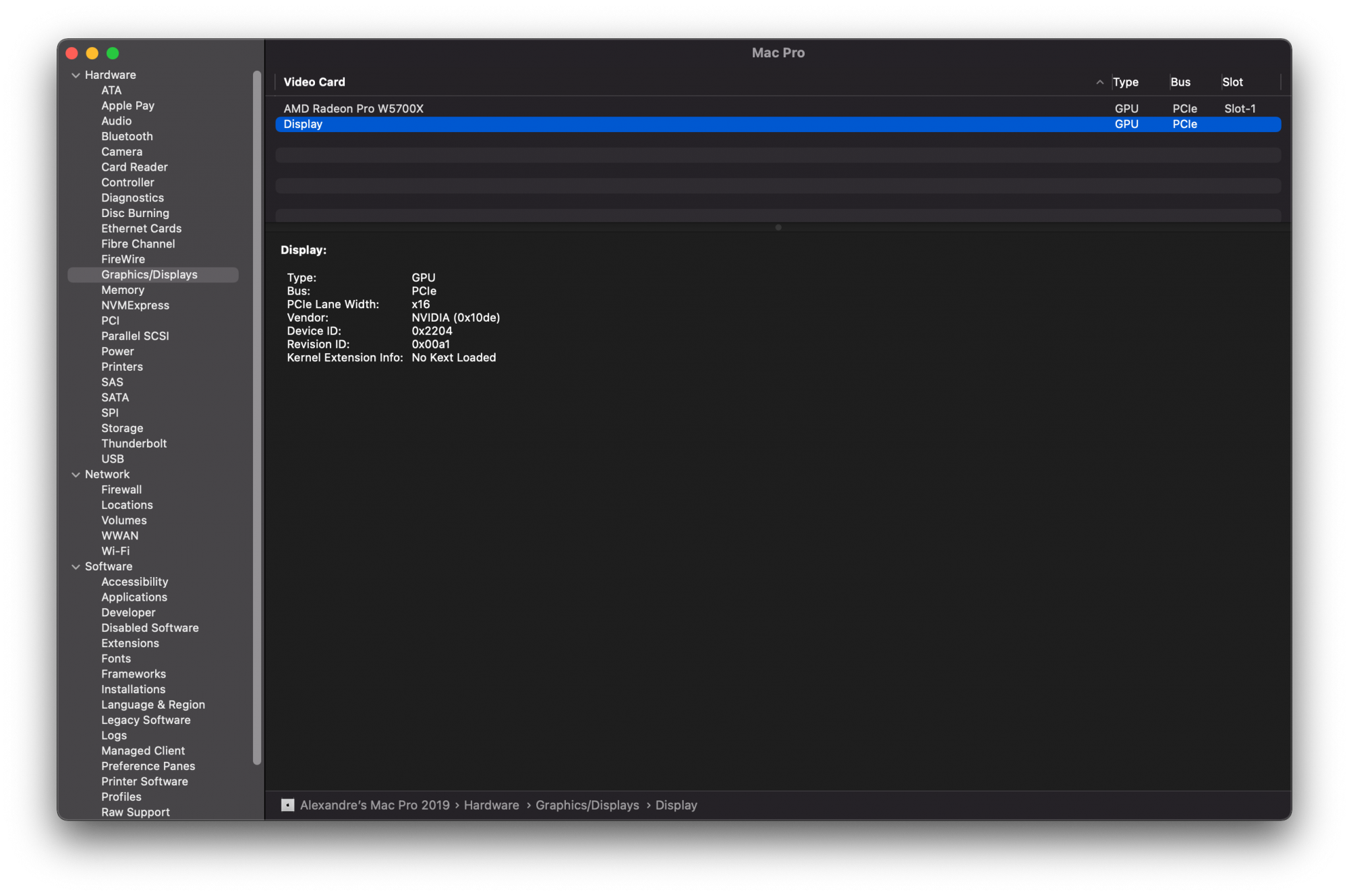

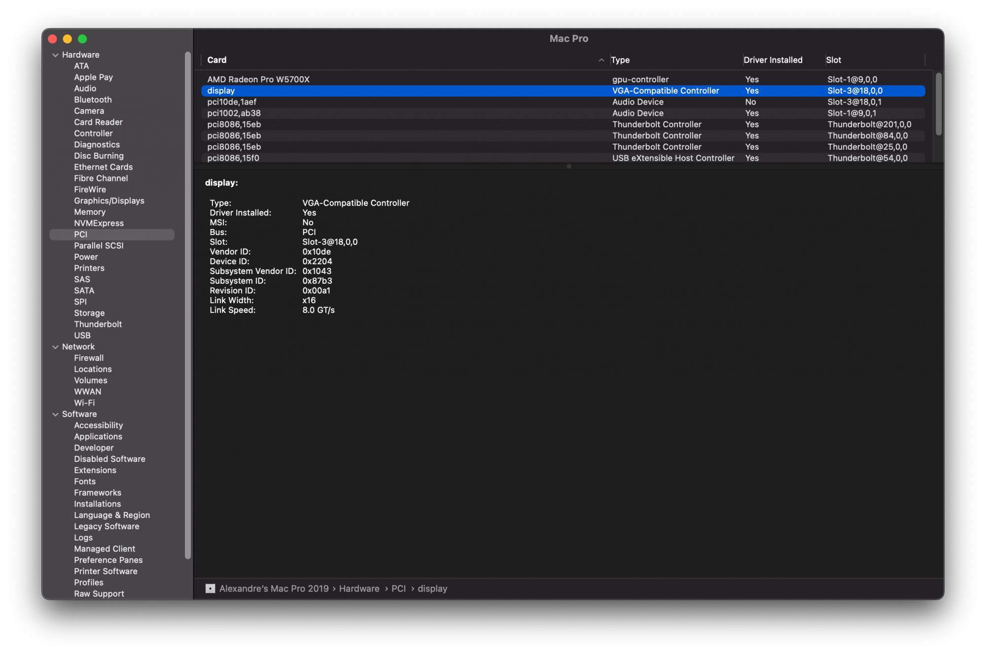

This gave me the idea of seeing what driver the RTX is using, since it's being recognized by macOS.
So, no kext loaded but there's a driver installed?
Under System/Library/Extensions I couldn't find anything with vga on its name. I thought about renaming the kext/driver, so that macOS couldn't find the appropriate kext and couldn't treat the RTX as a display card, but I haven't tinkered in OSes in decades and I'll progress slowly, if at all.
View attachment 1696796View attachment 1696797

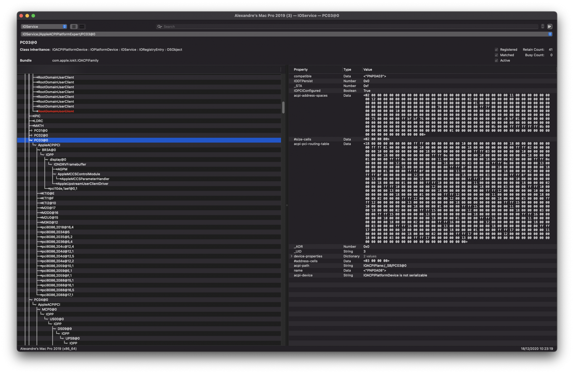

Use IORegistryExplorer.app to view the IO Registry and see the driver that is attached to that PCIe device.
Reactions: CatoTheElder
Thanks @joevt.
There doesn't seem to be anything under slot 3:
There's lots of stuff under slot 3:
device: PC03 (third PCI pool - MacPro7,1 has four of these {1: Slot-1, 2: Pool A, 3: Slot-3, 4: Pool B}. Most Macs only have 1. M1 Macs have 3 but ARM instead of ACPI)
driver: AppleACPIPCI
device: BR3A (Slot-3)
driver: IOPP
device: display (pci10de,2204 - the Nvidia GPU, 0x10de is the vendor ID for Nvidia, 0x2204 is the device id for RTX 3090 : https://pci-ids.ucw.cz/read/PC/10de/2204 ).
driver: IONDRVFramebuffer
device: pci10de,1aef@0,1 (Nvidia audio device with no driver attached)
The driver you probably want to replace is IONDRVFramebuffer. Maybe try creating a codeless kext NvidiaRTX.kext containing just an Info.plist in the Contents folder. In the Info.plist, specify a higher probe score than what IONDRVFramebuffer uses, such as 30000. Specify PCI match with 10de:2204 vendor/device id. CFBundleIdentifier and IOClass in the personality should be that of IOService so it does nothing for sleep/wake. You probably need to use IOMatchCategory IOFramebuffer to properly override IONDRVFramebuffer.
