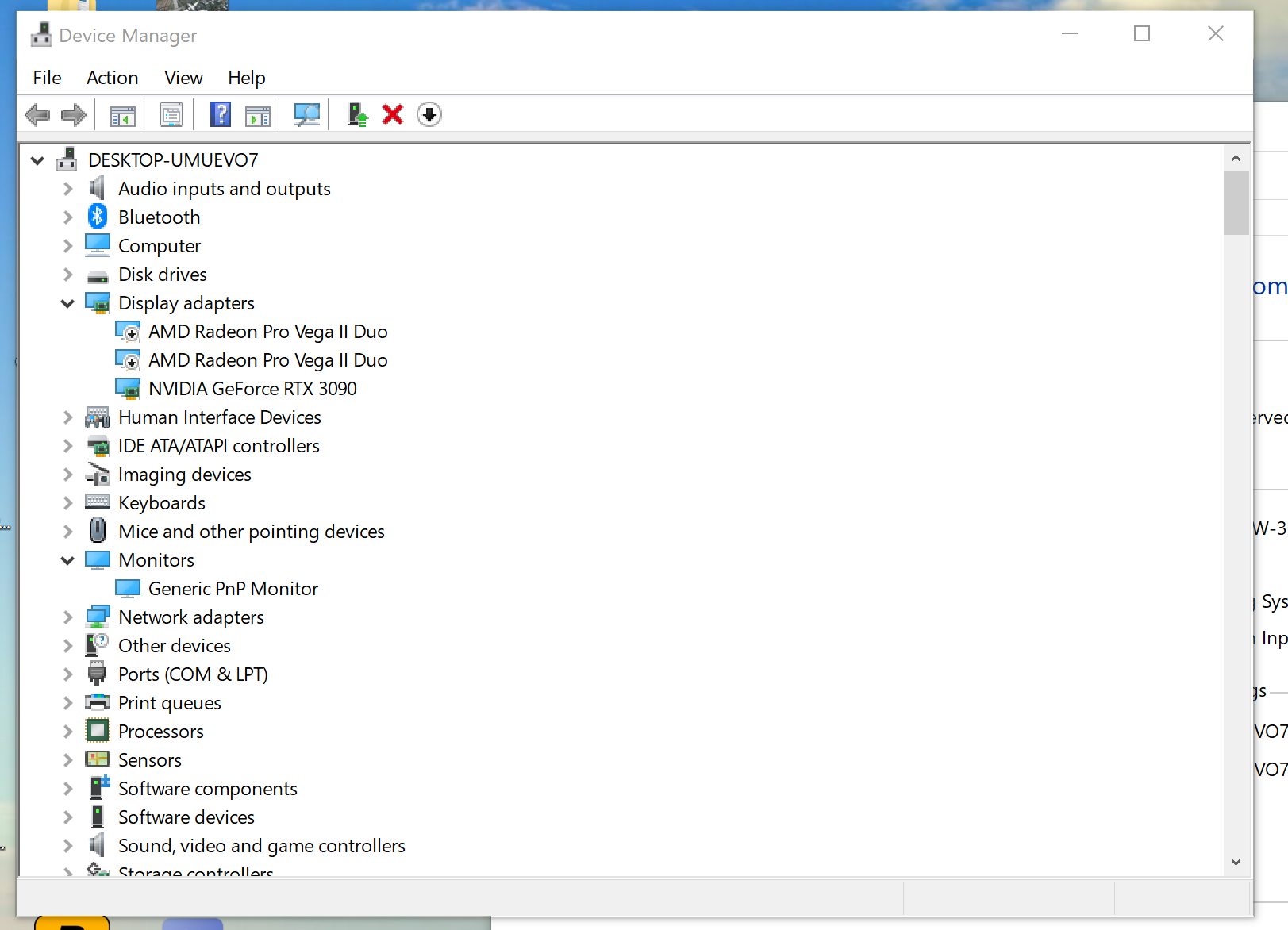

No, something else is happening. I think maybe the Vega II was not disabled. Did you see how/where the display was connected in the Device Manager? Did you have the ability to change resolution?So after installing a 3090 & Windows drivers to my 7,1, I wanted to do some testing. I have an LG Ultrafine 4k (new edition) connected to the Apple Thunderbolt 3/USB card via a TB3 cable. I then went into device manager and disabled the Vega II in Windows, which should have disabled my monitor's display output, per @joevt. However, I kept receiving video on my display, along with all USB functionality working perfectly fine, so I booted up flight sim 2020 and had a flight around, no problems and great performance on ultra (struggled to keep 60fps on ultra due to the Xeon processor bottleneck), kinda ran hot but nothing crazy. Much better than the Vega normally would get though, and could confirm in task manager all of this was being rendered on the 3090.
When I removed and plugged back in the TB3 cable to my monitor, I had full USB functionality from my keyboard etc, but no display, as I expect whatever display stream caching Windows had been doing with the MPX module had been lost. So it seems like there may be a way to reroute the display output to a Thunderbolt 3 port, but it would take some careful programming that I'm not skilled enough to do in Windows.

When looking at Device Manager, it helps to "view by connection" to see where the display is connected to.It was disabled, but my guess is Windows is trying to do something smart so it keeps existing displays connected. I cannot change the resolution, nor can I access the NVidia control panel. But the Vega is disabled, and the 3090 is definitely handling the rendering/GPU tasks on my TB3 monitor. Its actually a fine work around IMO, requires no cards, no special cables, just to disable the AMD GPUs after plugging to a non-GPU TB3 port. Performance is fantastic.
