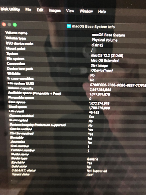

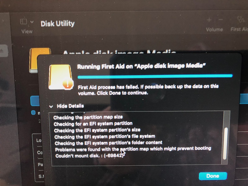

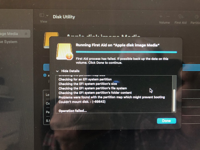

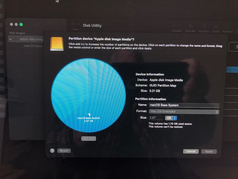

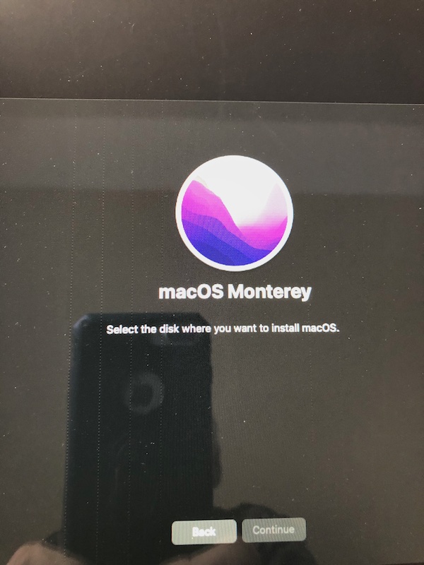

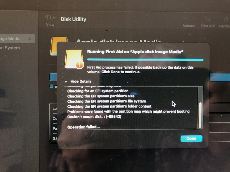

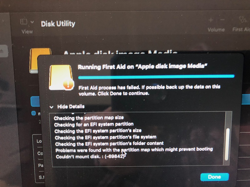

Can you erase a NVMe that doesn't show up to erase in recovery mode disk utility.
Also 6.1 has no boot chime but boots normally.

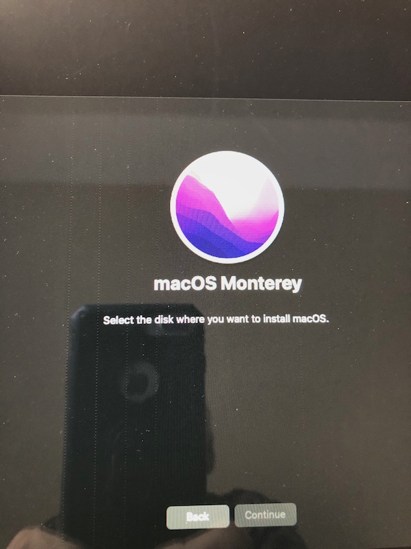

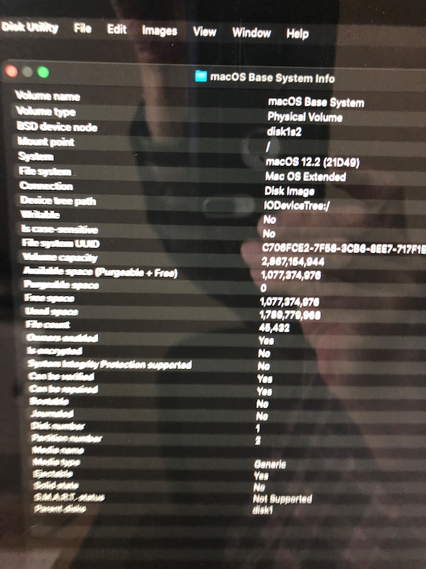

You're right. But I can only go to recovery. If I just let it boot, it goes to the welcome screen and at the internet page, I get the infamous spinning beach ball. Here are some pics, don't know if they will help though.
Any other information that may help, let me know and I will try to provide. My other 2 6,1s run fine, just this one gives me trouble.
Thanks

You're right, I did say that. Guess I should have explained it better. It comes on, now has the boot chime - fixed that with a pram reset, and goes to the welcome (set up) screen. But when it get to the wifi screen, it just sits there with the spinning beach ball. For some reason, it won't let me erase it or partition it...When I try to reinstall Monterey on line, it said I(NVMe) is formatted incorrectly, so that why I was going to erase it. This is an Apple, 1tb so I hate it's not working. Guess, I'll just have to buy another one.

Did you booted from InternetRecovery or createinstallmedia USB installer to format? You not going to nuke a disk that is mounted - booting normal Recovery mounts the disk.
Do you have any thoughts or recommendations as what I should/could do, or not?
Thanks

When you boot normal Recovery (Recovery above is disk2s3) disk1 and disk2 will be mounted and you won't erase the real disk, just the container.
To fully erase it (nuke), remember that I'm using my example above and your disks will have different device names, you have to boot from InternetRecovery or createinstallmedia USB installer and unmount both the synthesized disk and the real disk, with this order. More or less something like this below:
