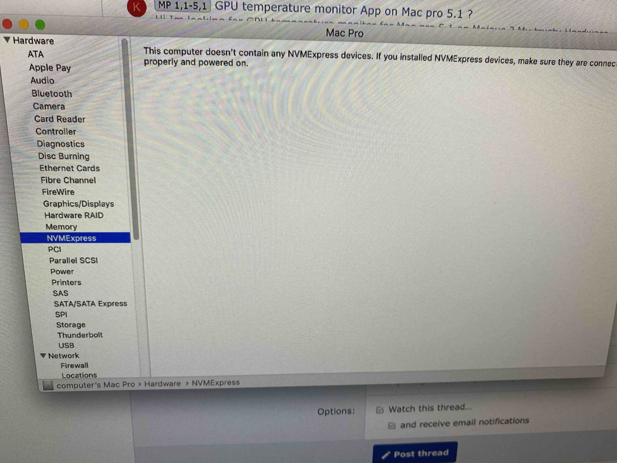

Hey guys,
really need a bit of help, I had read most of the post on the forum and searching around the internet and wouldn't find a solution

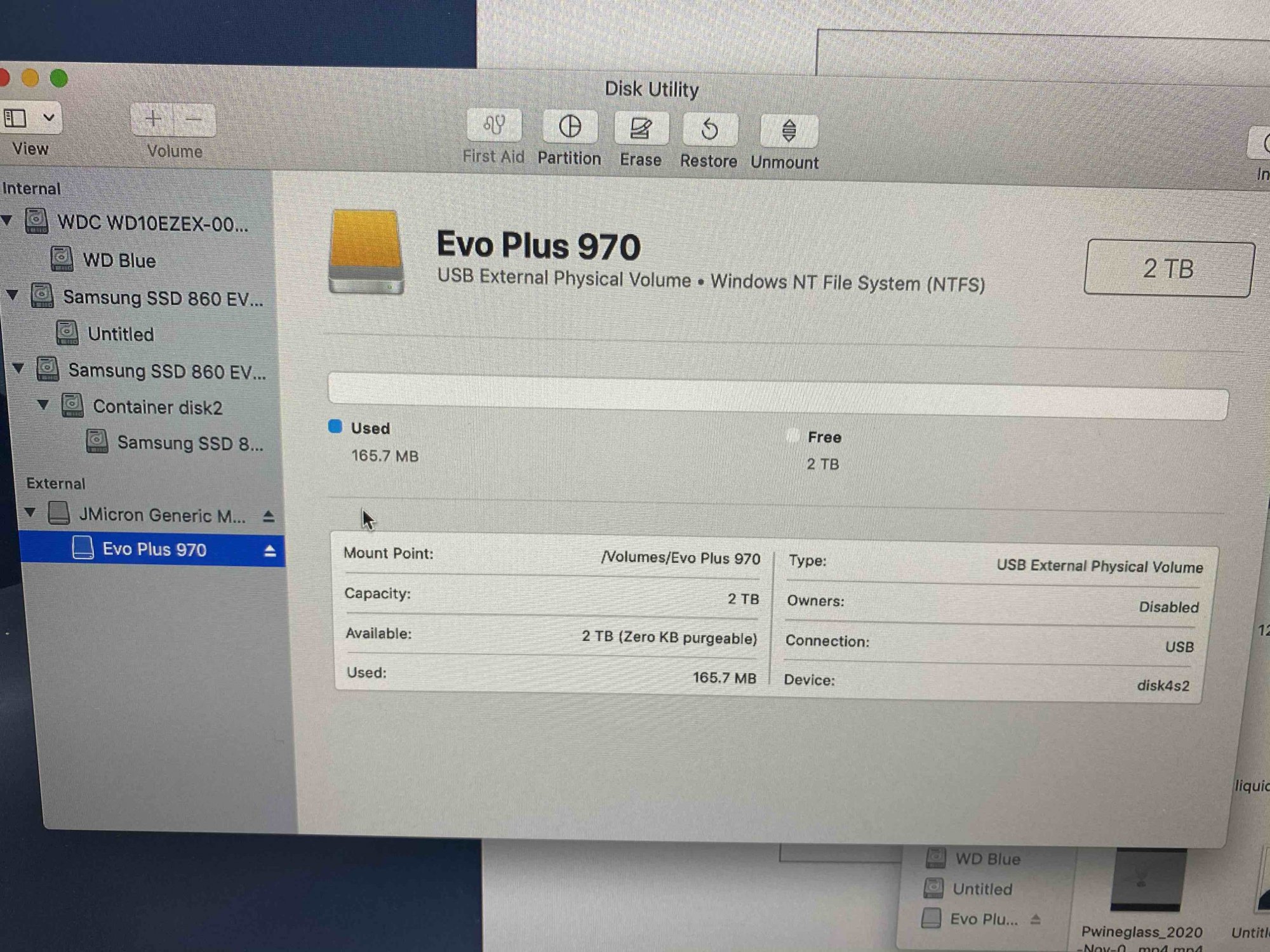

I got a cMP with a PCIe Nvme x8 adapter which use a PLX8724 and for the samsung evo plus 970 2tb from amazon which product date is 2020/10/29
What I did was
0. I plugged the NVME and the adapter on the cMP but no luck its not working, it showed as audio device in system report but when I tried to locate it at the NVMExpress it was not detected. I tried to put it in slot 2 and 3 but same result, then I tried to troubleshoot it

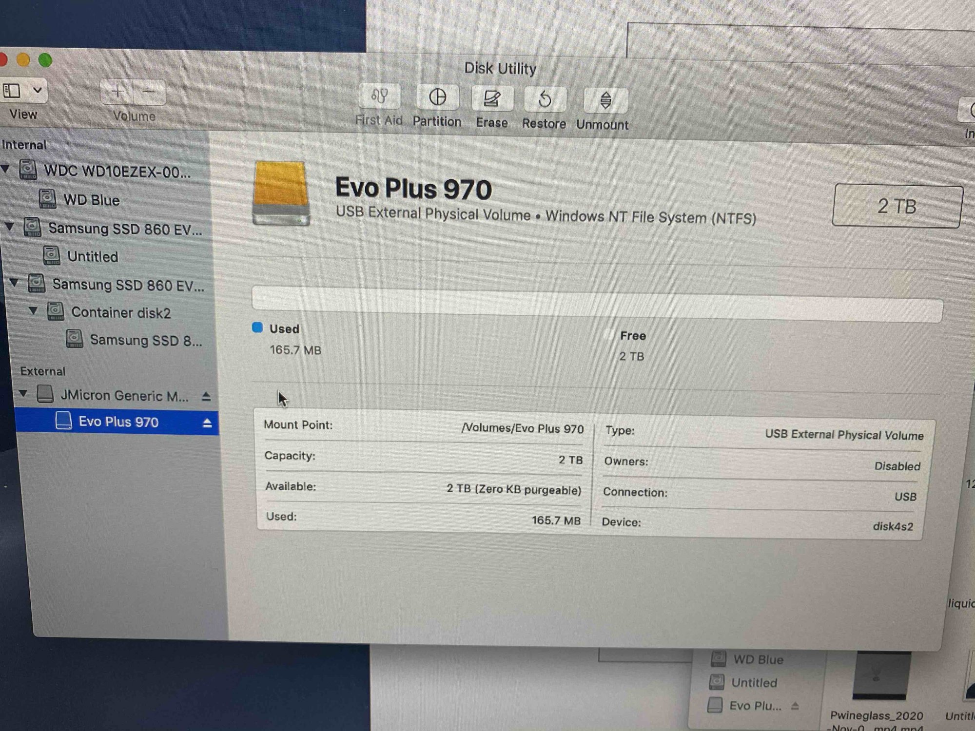

1. I bought a nvme enclosure and initialised the NVME in window and it showed up as an external drive in window
2. I plugged the NVME with the enclosure in cMP it also showed up as an external drive in Mojave then I format it into exFat
3. I put the NVME in the adapter, the cMP found the PCIe adapte
4. Opened disk utility -> show all device, its not detected as well
is there anything that I would possibility do?
Thanks in advance

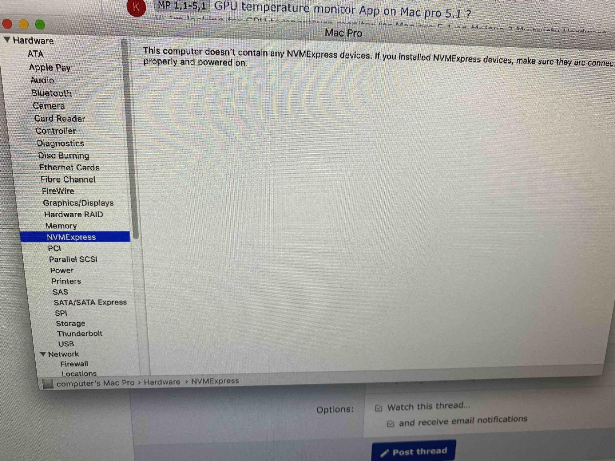

What I did was
Thanks in advance
View attachment 1697629View attachment 1697630

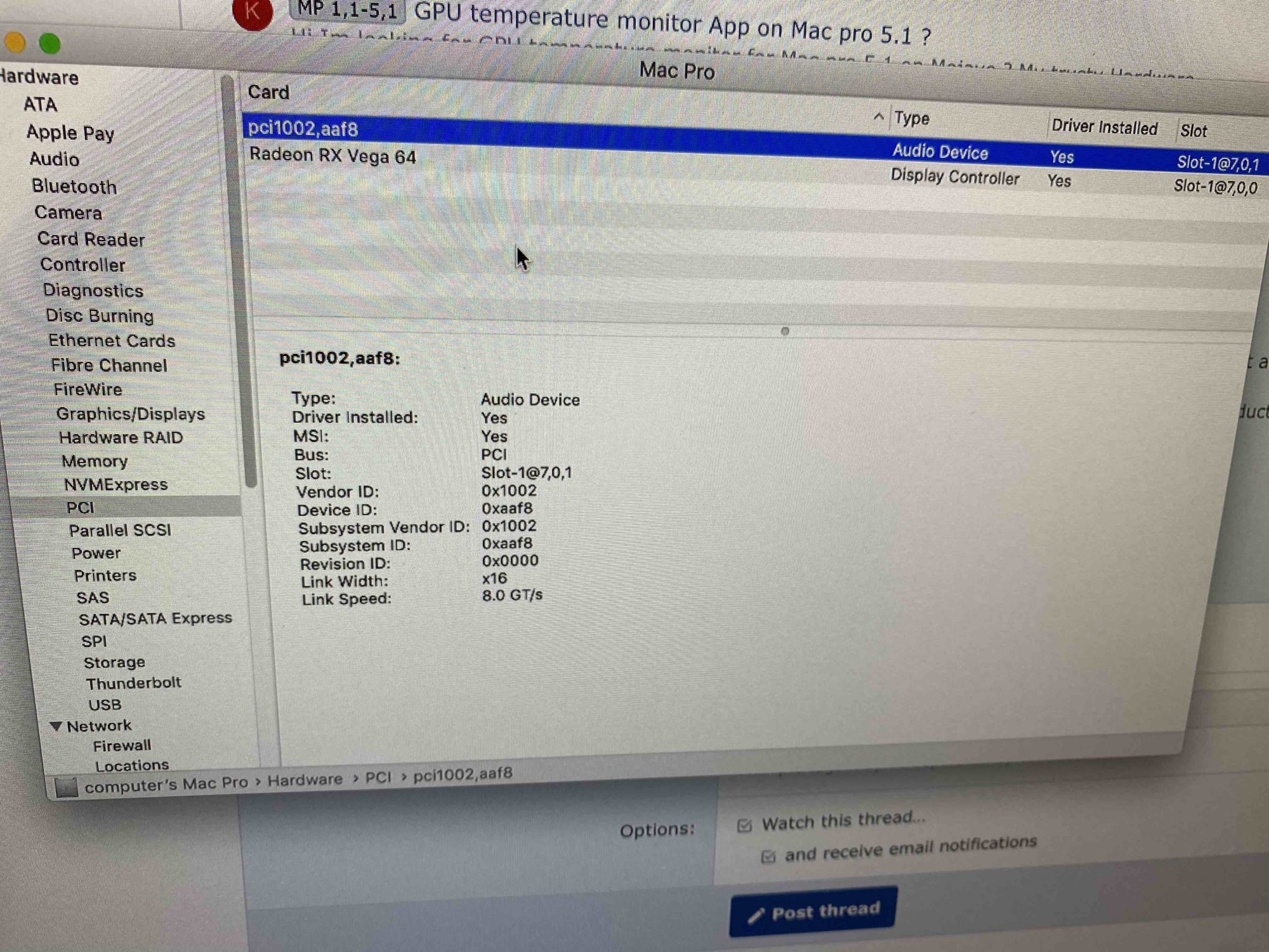

The audio device is your graphic card, not the NVMe. It's very clear that the audio device is at slot 1, same as your Vega64.
Anyway, from your description, very likely your PCIe card is not compatible on the cMP.

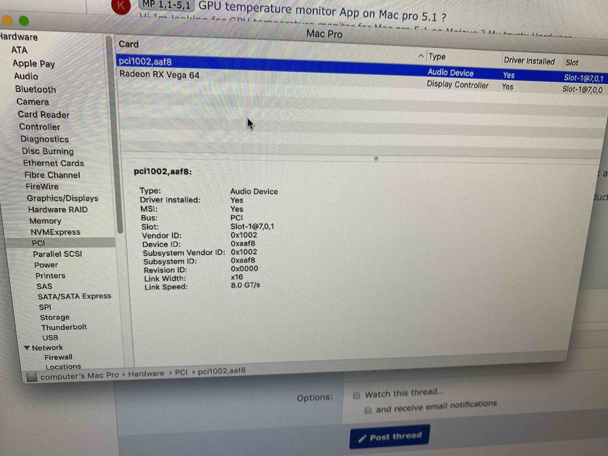

It’s not necessary the PCIe switch model’s issue. Can be just the card itself not compatible (e.g. firmware issue)
Just like the IO Crest card. The newer card has the same PCIe switch as the old card, but seems having compatible issue on the cMP, which the old cards don’t.
Some XFX cards also has the same GPU as other graphic cards, but has compatibility issue on cMP.
Since you tried the card in few slots, re-installed a few times already. So, the chance of having “poor contact” is relatively low. That’s why I believe it’s compatibility issue.
Anyway, which card you are trying right now? And model number? Photos?
Reactions: Petri Krohn
