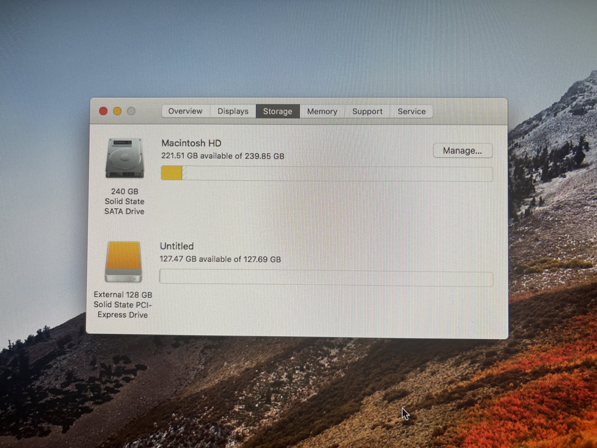

Hi there. I had a PCIe card I bought off Amazon a while back. I decided to plug it into my Mac Pro 3,1. To my surprise, it worked. I have NVMe working via a PCIe card. I am going to try installing it in the 16x slot to see if it works any better.

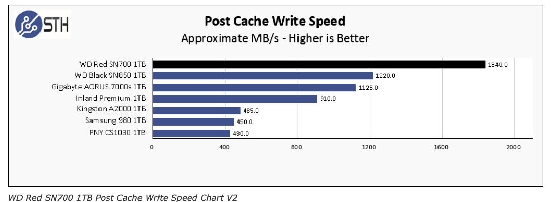

Writing consistency is what informed my search and ultimate choice of the Western Digital SN700 drives. The complete review is on the STH website [https://www.servethehome.com/wd-red-sn700-1tb-nvme-ssd-review-vastly-improved/3/]
Yep, it's consistently bad when installed in a MacPro5,1 😛 Jokes apart, most people only get write throughput at ~1100MB/s when installing directly to the PCIe v2.0 slots.
Btw, all drives shine at benchmarks when brand new, what really matters is after some TB written/erased.
