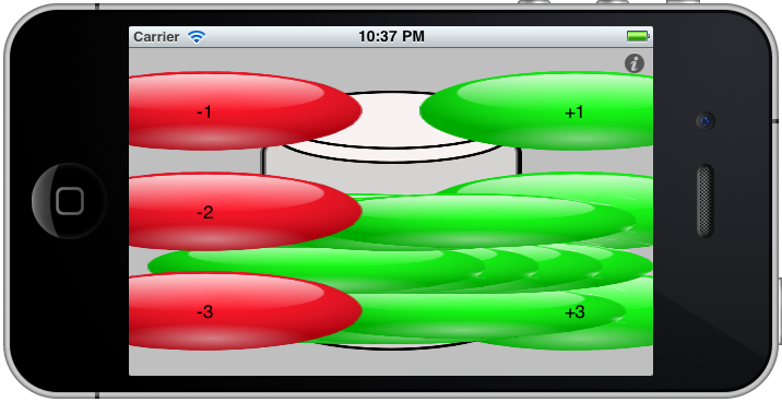

I am trying to create a View-Based Application with Xcode 4 and when I run my project in the simulator, the objects(Mostly UIImageView) do not show correctly, they are all distorted and misplaced. I am using Interface Builder and setting the files under the Attributes Tab. Please also note, that the project uses the landscape orientation and PNG files.

Thanks for your responses. On an actual device, they do not show up correctly. They show up exactly the same way as in the simulator. Also, in Interface Builder I have set the Orientation under Simulated Metrics to landscape.

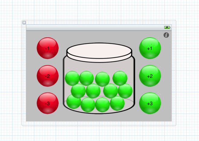

Here is a picture in the simulator and in Interface Builder-
Simulator: Simulator .png
Interface Builder: IB.png
Interesting... what do you springs and struts look like in Interface builder for all the balls?
Maybe try turning on all the struts and turning off all the springs?
Edit: Springs and struts may be accessed by clicking on an object, clicking on the ruler tab on the right side column and looking at the white box below "Origin" and above "Autosizing". Turning on the struts means click on all the things that look like I beams so that they're all solid red. Turning off the springs means click on the double ended arrows so that they're red dashes. Just letting you know incase you don't understand the terms "springs" and "struts".
It Works!!!
Thank you so much for your help. I fixed by playing around with the springs and struts!🙂
