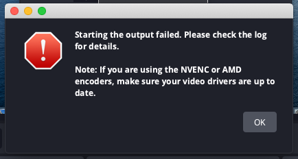

I'm experiencing a strange error with OBS on my 5,1 Mac Pro with the Radeon Pro W5500 graphics card. Every time I try to start an OBS recording/stream with the hardware encoder "Apple VT H.264 Hardware Encoder," it gives the error message in the screenshot below. I'm running Catalina 10.15.7 via the Dosdude patcher, as I was having issues with OpenCore.
Would OpenCore solve this problem, or is it a driver issue that can not be fixed for this particular GPU? The issue happens on both v27.2.4 and v28.0.3. The screenshot below is of 27.2.4.
Any help greatly appreciated!
