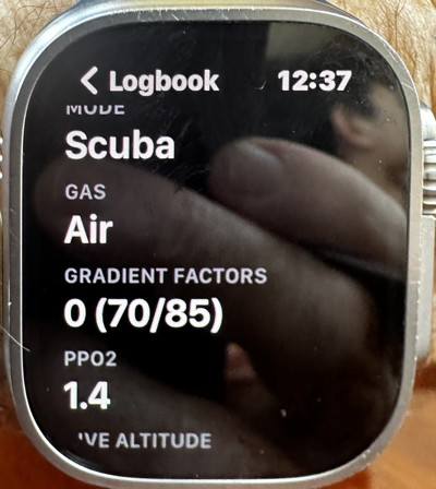

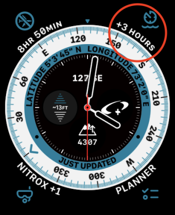

During this trip my wife was on air, but I was on Nitrox for all of the nine dives that we did. Since the air mixture varied from tank to tank I always checked the Oxygen percentage and made sure my Watch (and Zoop Novo spare) were set correctly.
The eighth dive was at Eight Mile, a submerged pinnacle. A very strong current forced us to descend using the buoy line. When we got to about 20 meters visibility was only two or three meters. Since we’d spent quite a bit of time struggling to descend I checked the No Deco time on my wife’s Zoop. It showed 17 minutes. I checked my Watch which also showed 17 minutes. How could this be when she’s on air and I’m on 32% Oxygen?
After the dive ended I checked the dive settings on my Watch. Much to my surprise it appeared that Oceanic+ had spontaneously reset all settings to the factory defaults. The dive gas was set to air and no alarms were active. I normally set target dive time to 50 minutes, target depth to 30 meters and low-no-deco to ten minutes. The logbook on the watch showed that the dive was done with air. I’m not sure how this could happen; especially since I had confirmed the Nitrox setting about 20 minutes before the dive began.

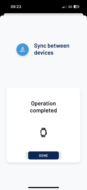

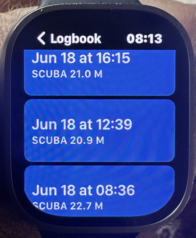

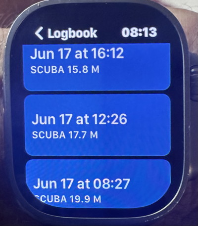

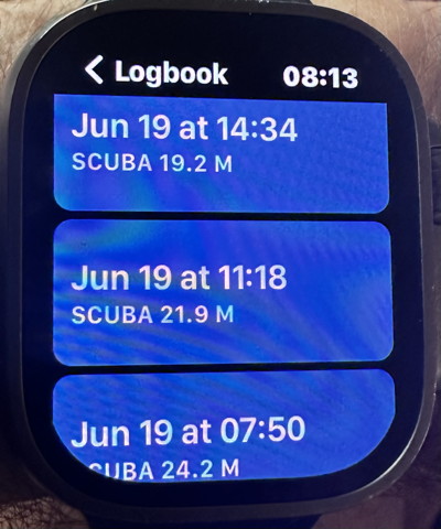

Another problem was with the logbook. It took a very long time for Oceanic+ on the Watch to sync the logbook with the iPhone app. After the eighth dive I noticed that only three dives were shown in the iPhone app logbook; dives 5, 6 and 7. I tried doing manual “Sync to your watch” and even though it said “Operation Completed”, the missing dives never appeared (or re-appeared) on the iPhone. All nine dives are in the logbook on the Watch, but only three are now on the iPhone. This is a shame as I spent some time entering dive notes in the logbook on the iPhone. It appears that all of that is now lost.
[Logbook watch 1,2 and 3]
[Logbook Phone]

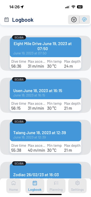

The Home Screen of the Oceanic+ app on the iPhone shows only three dives for the “Last 4 Weeks Scuba Summary”. There should be nine.
[Home - iPhone]

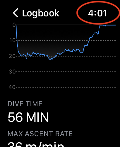

Surface Interval
For some reason the logbook is that it doesn’t display surface interval. Easy enough to calculate, but isn’t that why I have a smart Watch and a smart Phone?

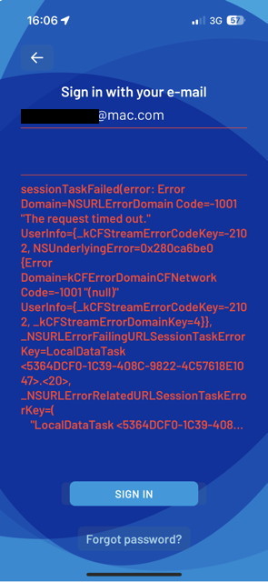

Logout/Login
I hoped that logging out and logging back in again might fix the logbook sync issue. I logged out on the iPhone and was offered a log in screen. I tried logging back in and was presented with a rather cryptic error message screen.
[Error screen]
Does Oceanic really think that low level system errors should be passed on to end users? How about something a bit more human readable?
I never was able to complete the login process even when we got close to Lipe and had a 5G cell signal. Oddly, when I went back to the Home Screen, it appeared that I was still logged in or had succeeded in spite of the error message. Unfortunately, The Home Screen showed that my current plan was “Free” in spite of the fact that my current app rental doesn’t expire until July 11th.

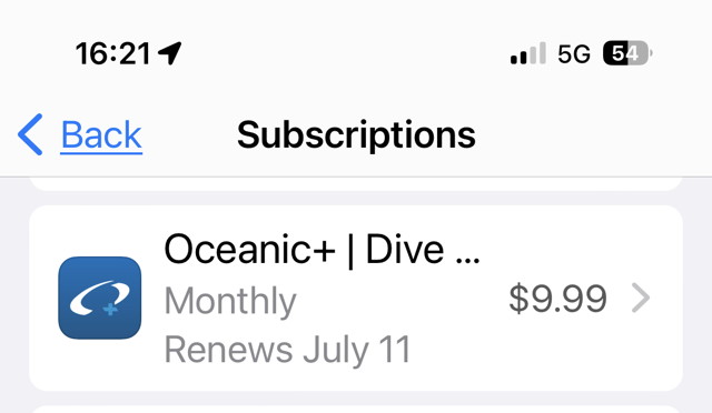

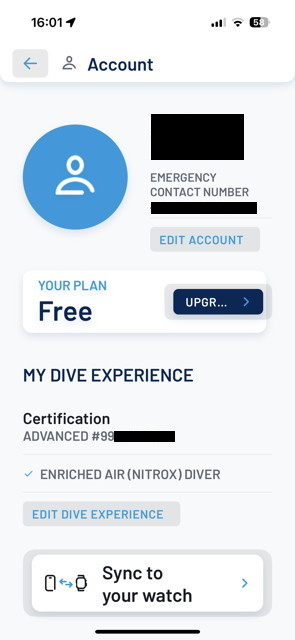

[Home Screen - Free]
[Subscription]
Although we were done diving for this trip I thought I’d simulate starting another dive. As expected, I was not offered Scuba; just Snorkeling. What a shock it would be to be in the midst a multi-day live aboard trip only to find out that Oceanic had summarily cancelled your rental subscription three weeks early. What then?

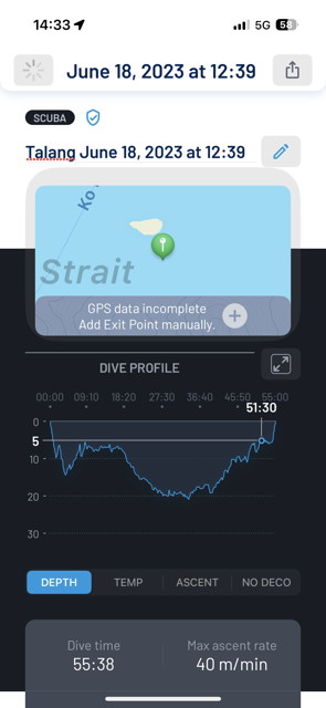

GPS and Maps
On my first live aboard trip with Oceanic+ I noticed that frequently the app was unable to use GPS to determine the dive exit point. This problem persists, although you are now given an opportunity to add the exit point manually. I’m not sure how that helps. If I could find the exit point on a map I wouldn’t need GPS.
[GPS data incomplete]
I’m not sure why the Oceanic+ app can’t locate the exit point especially when several GPS satellites have a very strong signal in this area.

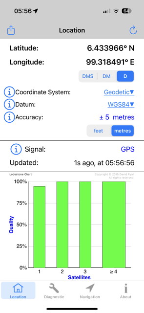

[GPS diagnostics]
Perhaps the problem is that when you first surface your wrist and watch are still under water. If that’s the case, the app might offer a message with hepatics asking you to hold your wrist and watch above water so the app can get a good GPS fix on your exit point. It’s not helpful to find this out only after you’ve left the dive site and are back aboard the dive boat.
The problem of needing an Internet connection to view maps persists as does the inaccuracy of Apple Maps in both the North and South Andaman. Oceanic should offer users the option of downloading decent quality maps in advance. Other apps (WorkOutDoors, GPS Tracks) offer this, so it is not an insurmountable problem.

I just completed a dive with the app. Surface interval is shown in the logbook and on the Oceanic face. That and other Oceanic complications can be added to any Apple Watch face.
As to how your app reset from Nitrox to Air, I can't explain that. Mine stayed on nitro after the dive. My dive synced automatically too.
Reactions: Buadhai
Thank you. I knew about the surface interval time on the watch face, but didn’t realize it was also displayed on the watch logbook. It would be nice if it were part of the dive profile display on the iPhone app logbook.

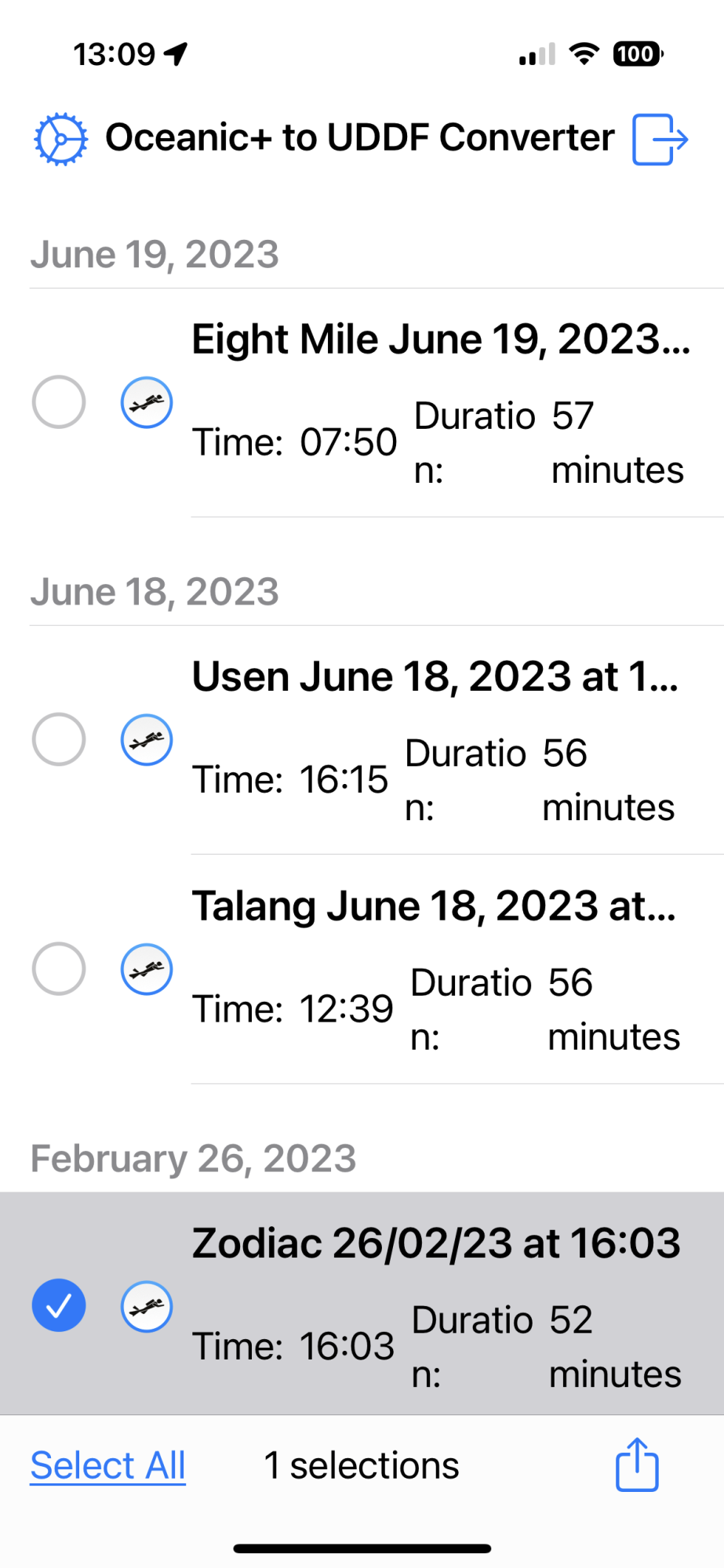

I use the iOS app Dive Converter which extracts dive data directly from Oceanic+ (not Apple Health) and exports as a UDDF file which can be imported into a number of dive log apps. (I use SubSurface.) Unfortunately, it appears that the sync bug has moved only three of nine dives from the Watch to the iPhone. So the missing six are lost for good. Fortunately, I had the Zoop Novo as a backup. When I get my act together I should be able to import all 9 from the Novo to SubSurface. I was able to import all 9 dives from the Zoop Novo to Subsurface.
Sadly, all the dive notes that I entered on Oceanic+ on the iPhone for the first six dives is MIA. Happily, backup fanatic that I am, I transcribed all those notes into my paper logbook. (I’ve been burned before by digital logbooks.)
Screen shot of Dive Converter app showing the only three dives on the Oceanic+ iPhone app.
What follows is the data exported from one dive, less the dive profile and depth data. Note that time is in seconds, distance in meters and temperature in degrees Kelvin:
