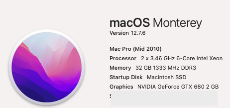

I'm running Monterey 12.7.6 with OCLP 2.2.0 on the MacPro 5,1 (2010) on a SATA SSD

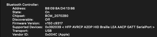

The Bluetooth-WiFi is the stock card, the BRCM2046

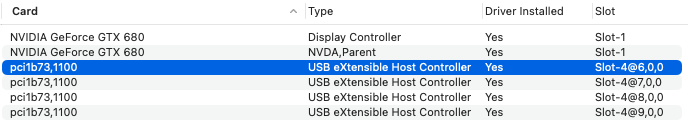

This Mac Pro also has a PCI 3.0 card:

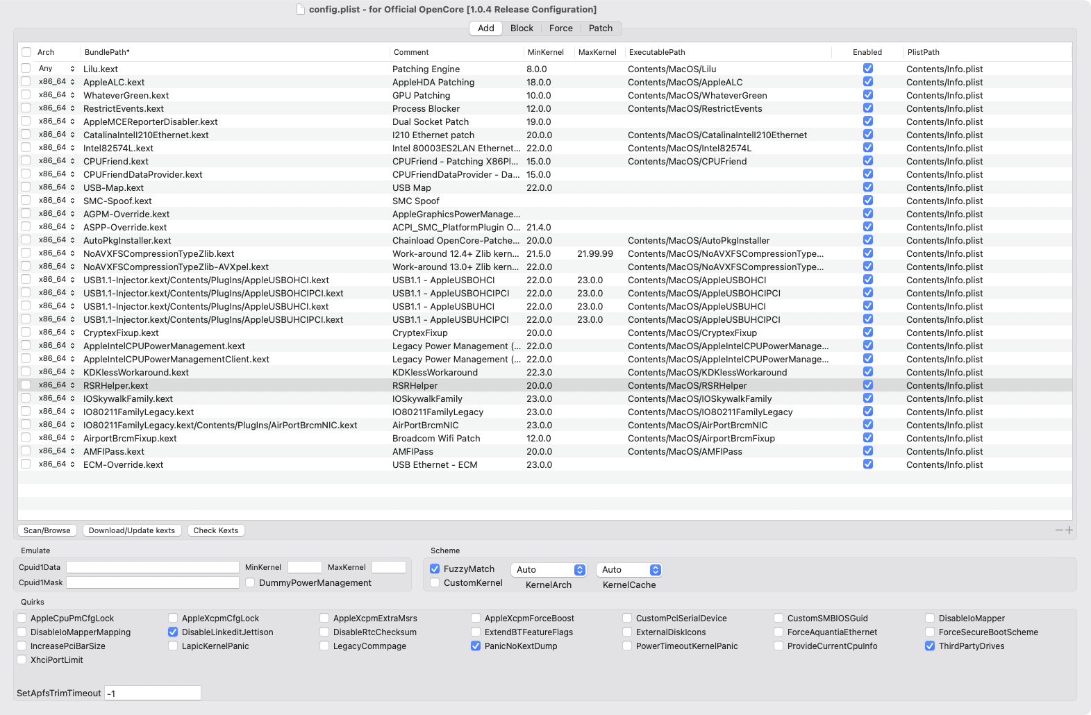

- With OpenCore Configurator, I confirmed that both Bluetooth kexts are enabled. Also, I disabled them and re-enabled them just in case, without success.

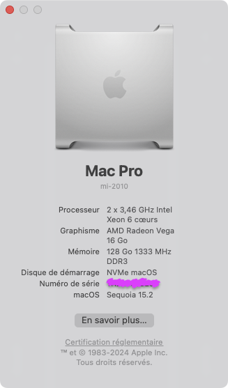

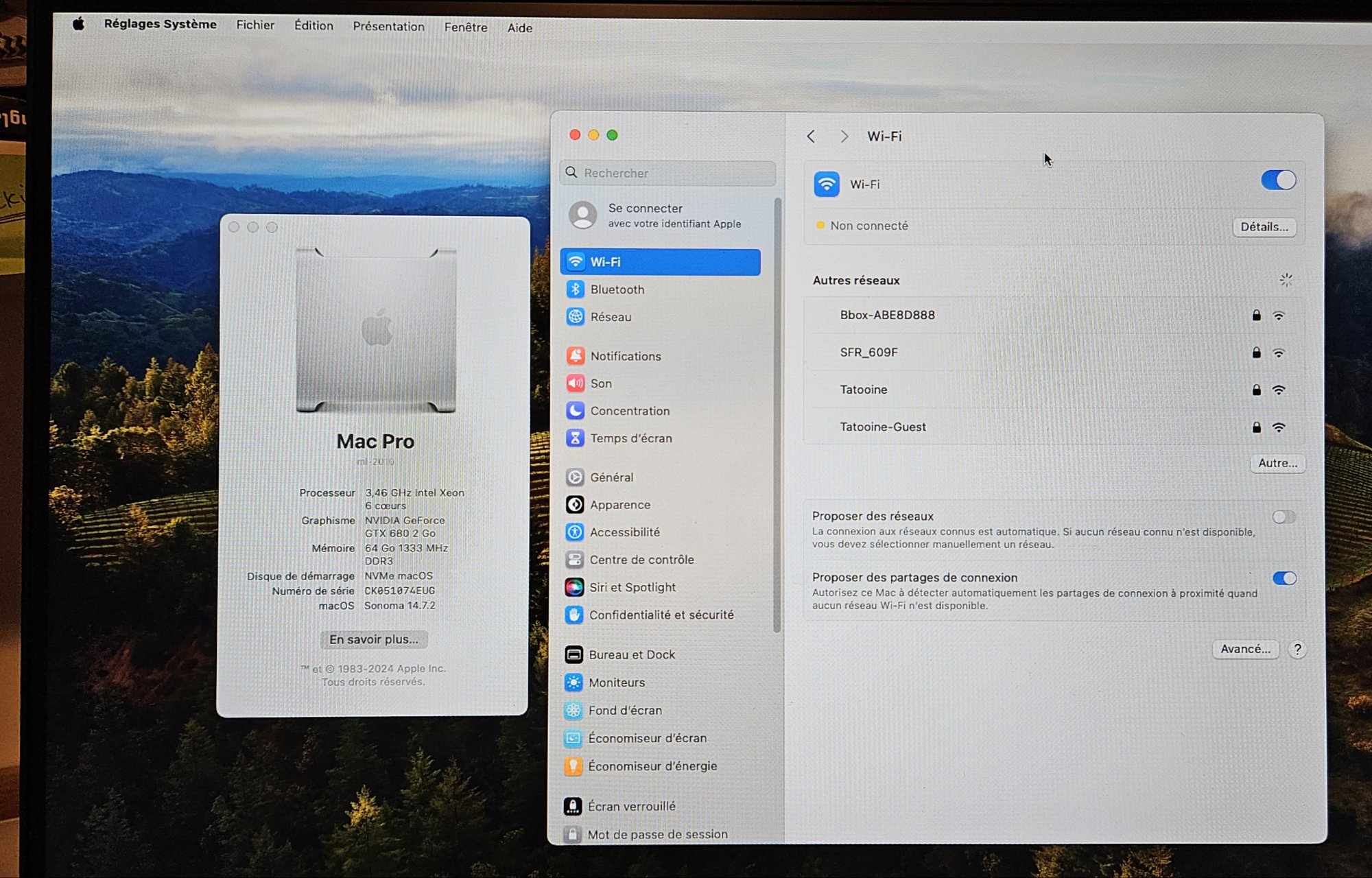

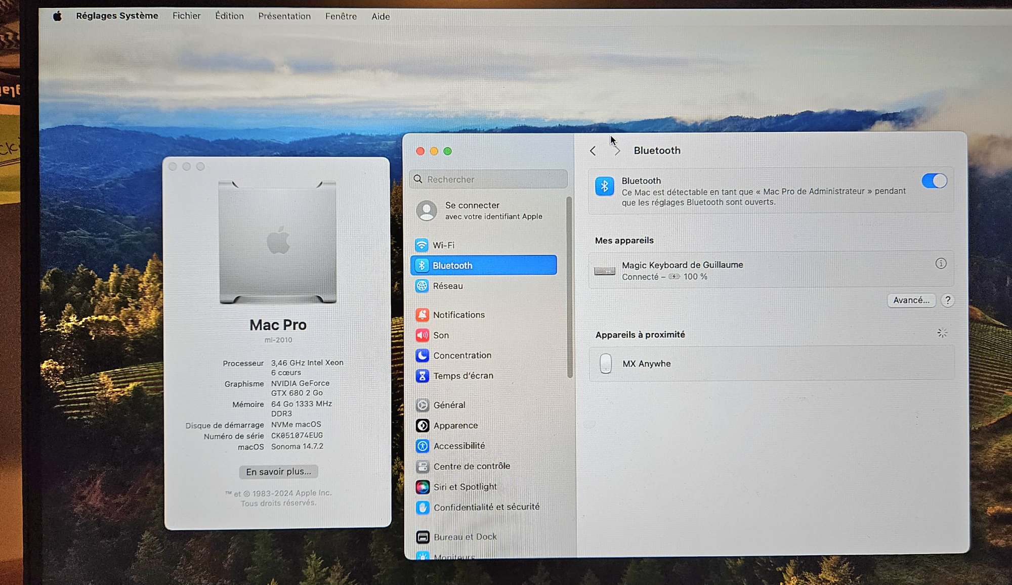

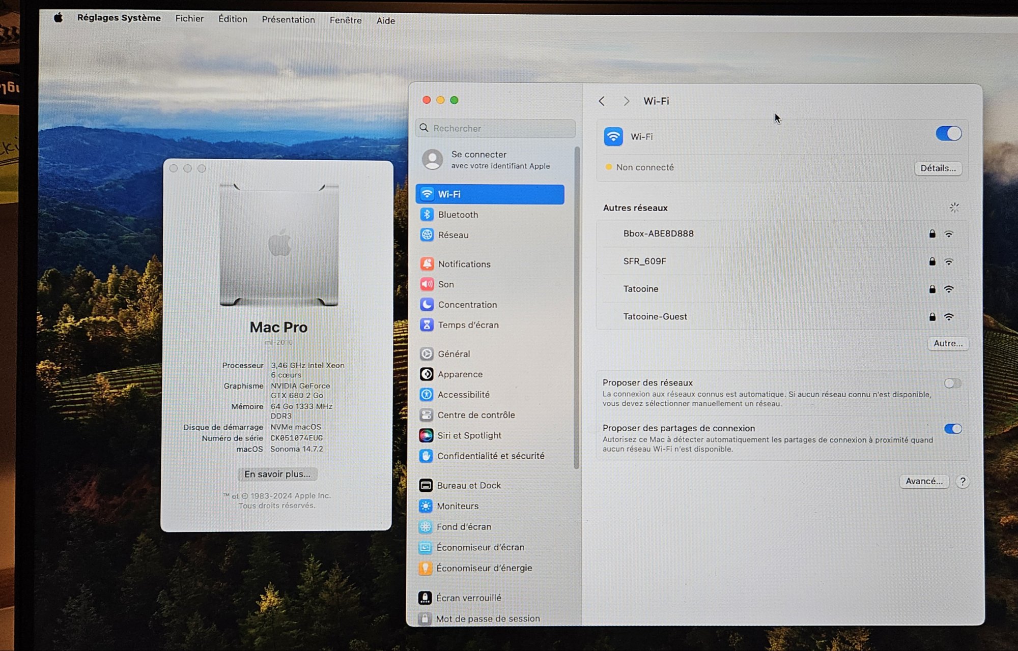

Here are the screenshots of my cMP 5,1(2010) 2x3,46 GHz with a WiFi ac BT 4.2 BCM943602CDP upgraded module, with working BT and WiFi, running Sequoia 15.2 :

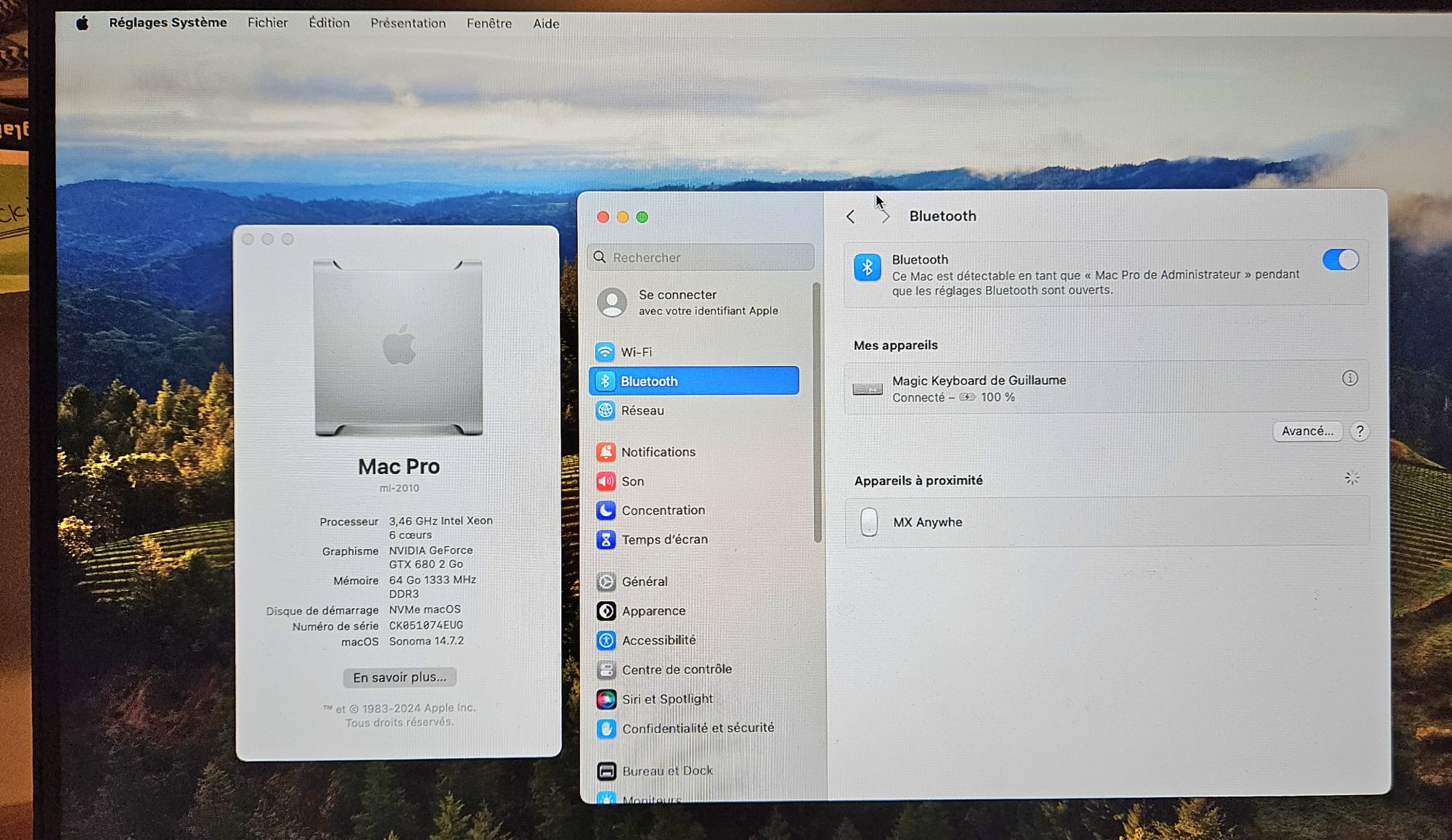

I managed to install Sonoma 14.7.2 with working Bluetooth and working WiFi.
Here is how I did :
1. Install OCLP 1.5.0 in EFI Boot and reboot.
2. Boot on an external "Installer macOS Monterey 12.7.6" volume to do a fresh install of macOS Monterey.
3. Proceed to the full install of Monterey.
4. Once in Monterey, run OCLP 1.5.0 and apply "Root Patches" and reboot into Monterey 12.7.6: Bluetooth and WiFi are directly working !👍🏻
5. Boot on an external "Installer macOS Sonoma 14.7.2" volume and install macOS Sonoma over the macOS Monterey.
6. Proceed to the full install of macOS Sonoma.
7. Once in Sonoma, run OCLP 1.5.0 and apply "Root Patches" and reboot into Sonoma 14.7.2 : Bluetooth and WiFi are directly working !👍🏻
8. Install OCLP 2.2.0 in EFI Boot and reboot.
⚠️ Do not install Sonoma 14.7.4 (neither via System updates nor full installer), because it will disable the Bluetooth (WiFi will be ok unmodified).
Reactions: Lord Snooty
