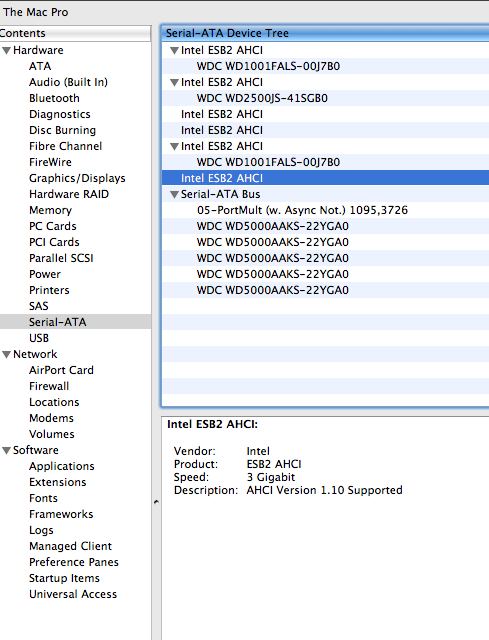

Neither Disk Utility nor SoftRaid recognize it as a drive. The System Profiler shows 3 new entries but no information about them.

Well, the 'extra' entries for Intel ESB2 AHCI I thought were from the Colossus were not. I've pulled the drive and they remain. Are they an artifact of running a software RAID?
In any case, although the drive appeared to seat properly, nothing was recognized by the OS.

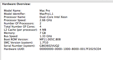

In case anyone wants hardware info for my MP:

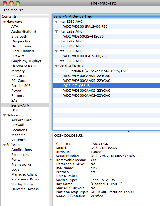

Well, if I mount the drive in my SeriTek/5PM, the OS can see it and SoftRaid could initialize it. However, I could not get it to format with SoftRaid - I got a 'disk in use' error message. I put it back into the internal drive bay and it's no longer recognized. So the SeriTek 2SE2 SATA card can see it but the Apple MP1,1 motherboard can't.

Maybe it's a firmware issue that only affects older Mac Pros? Would it be any more likely to work with the EFI 64 boards?
It's not the board, as you already indicated it works under Windows XP (that board uses the same components as any other PC board for CPU, North and Southbridge chips, and the SATA controller (ICH) is in the Southbridge. The SeriTek has it's own drivers, while the board has to use the OS X drivers written for the SouthBridge (ICH section is faulty).
It's not the board, or the firmware. See above. 😉
So it's purely a driver issue? Hmm.
Looks that way. If it were the drive (firmware or hardware), it wouldn't work in Windows either. 😉 But that's not the case (at least the drive itself is functional). 😀
