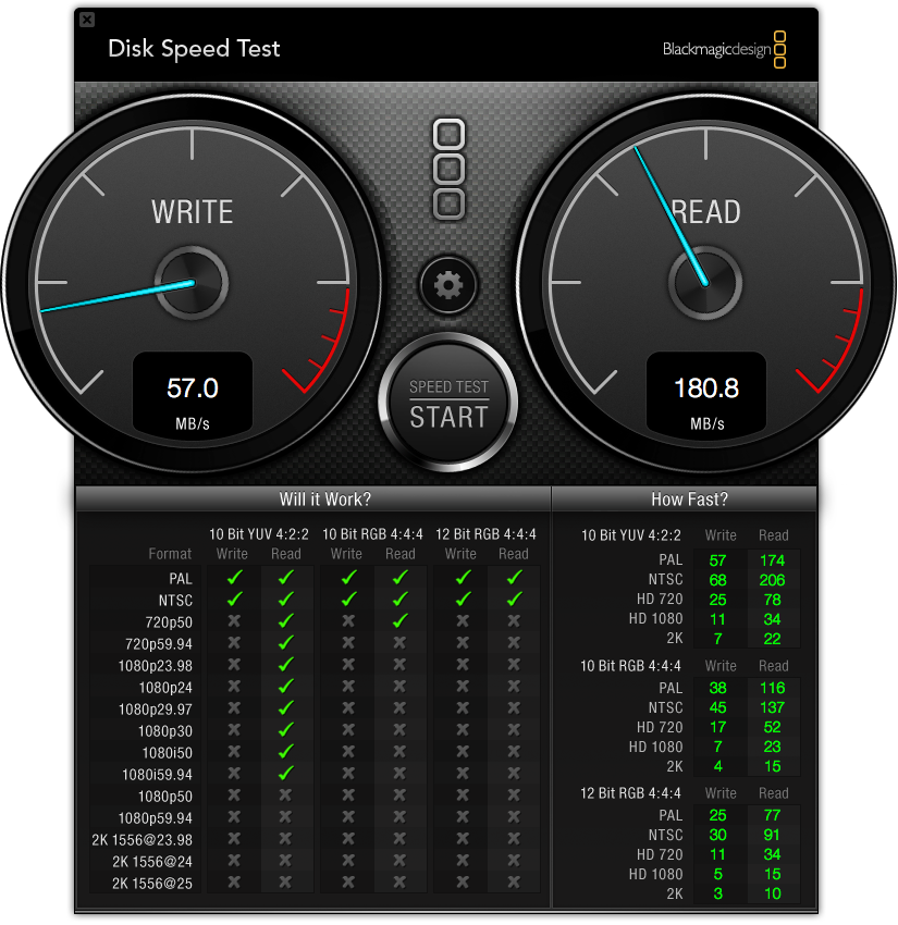

I've just run a benchmark on my 120GB Vertex 2, in a 2010 MacBook Pro 15". The results were disappointing. Is there anything I can do to speed this drive up?
I haven't enabled TRIM as a long time ago, a few people suggested that it didn't need it on this drive. The drive has been in my MBP for about 14 months.
The only thing is I cant remember if I put the SSD or HDD in the optibay. I've got a feeling it was the SSD in the optibay so the HDD would still be protected by the sudden motion sensor.

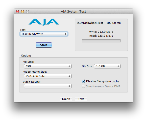

I have my Vertex 3 SSD in my 2009 MBP in the optibay and I get S-ATA 3.0 Gbps (S-ATA II) speeds.
You can use the following applications to benchmark the speed of your SSD, to see, if it is the culprit or if Blackmagic Speed Test is the culprit:

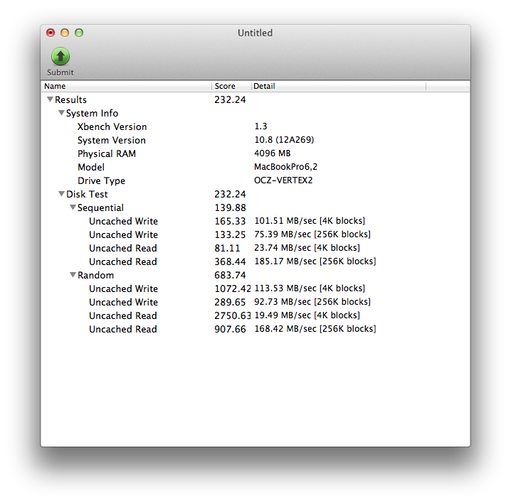

Coundnt get AJA to work, but Xbench gave better results.

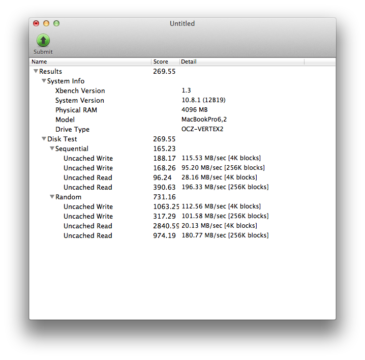

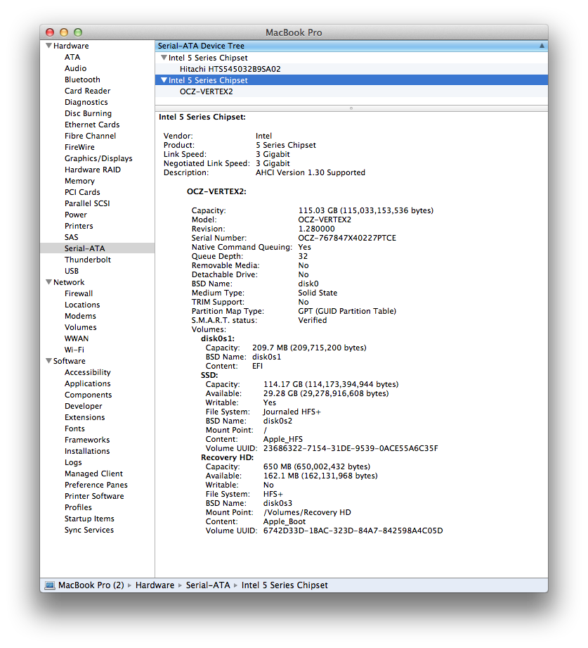

Ok wiped the ssd, and restored time machine backup. It's not improved drastically. Anything else I can try?
OK I maybe spoke too soon... Something has settled down and speedtests work better now.
