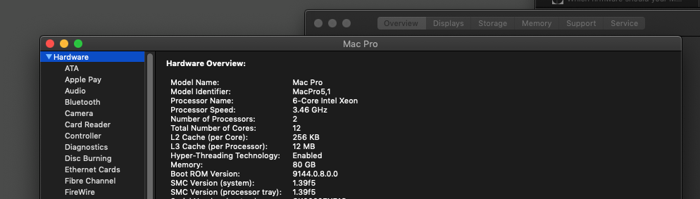

However I have also noticed that my BootRom now has a very unusual version number 9144.0.8.0.0

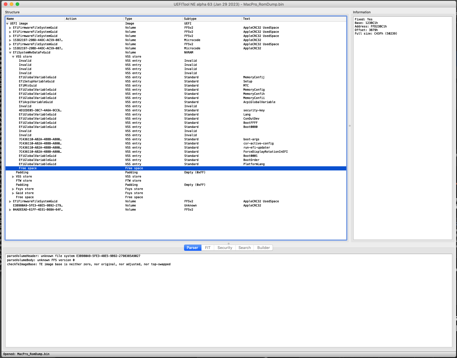

I have checked my ROMDump and have plenty of free space going by @tsialex recommendations but a lot of invalid entries. (Pulled off of my Mojave drive)

9144.0.8.0.0 is expected, it's the @h9826790 OC package. This is just workaround, or better, a way to avoid unwanted firmware updates when spoofing iMac Pro or late-2019 Mac Pro.
The main issue at play here is that you have a cross-flashed early-2009 Mac Pro where the secondary VSS store does not work and you will probably corrupt the NRAM volume/brick sometime in the near future.
