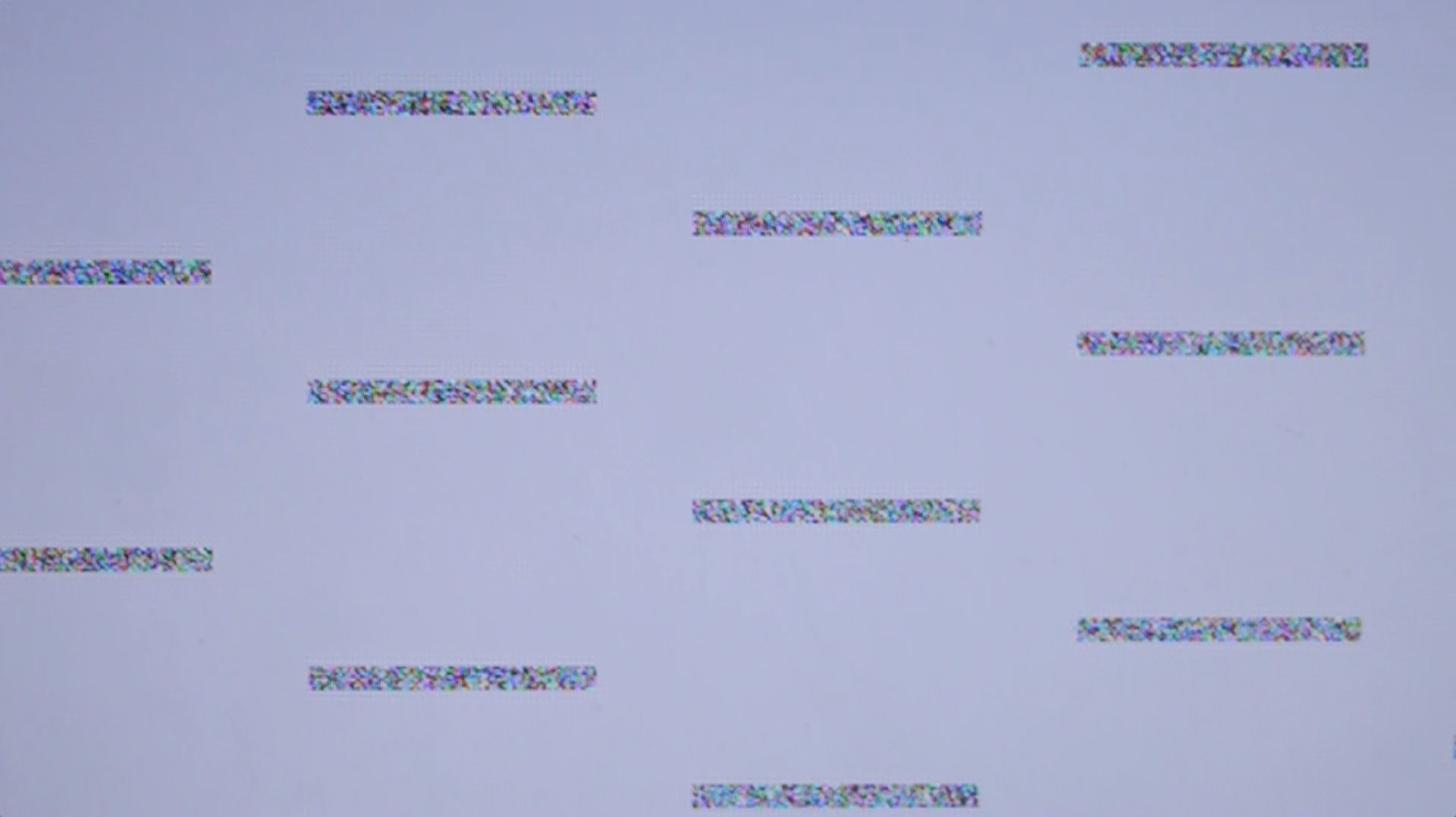

I have a really weird occurrence that happened whenever I hook up my computer to a projector via a VGA Adaptor. The computer will work fine until it gets hooked up, at which point upon startup I get a quick flash of bands of 'visual noise' on the startup screen (after the Apple appears).
The weirdness is that this flash of noise will happen constantly after that point whenever I start up the computer and sometimes when I shut down.
If I zap the PRAM, this will stop. But as soon as I hook it up to a projector it starts happening again (and it doesn't matter the make or model of projector - this happens whenever and wherever I do this, even using ones on the road provided by other schools/companies).
While I can zap the PRAM after each time I use a projector (which is daily), I want to make sure that there isn't any underlying issue with a graphics card, the video output portion of the computer...a software glitch (as an aside, I got the computer right before having to spend a month in China and the first projector I used was there...could that have caused any problem? Just ruling out all possibilities)
When I took it to TechServe they suggested the PRAM zap, which worked (until I started using a projector again). I've included a pic of the noise for reference. thanks!

As this is not a normal occurance, and as things that aren't a normal occurance should usually be looked into to make sure it doesn't signify a deeper issue (graphics card problem, memory problem, etc) that should be repaired, or a hiccup that can indicate a software glitch...forgive me for asking if it's something anybody else has come across

If I had to guess, the problem has to do with negotiating a resolution with the projector. Back in the olden days of CRT monitors (~12 years ago) the monitor would do all sorts of disconcerting stuff when a resolution was being negotiated, like pop and flash and distort. Since you are using an old school analog connection I suspect the same thing is happening but with modern digital projectors all this popping and flashing manifests itself as some random digital screen noise.
